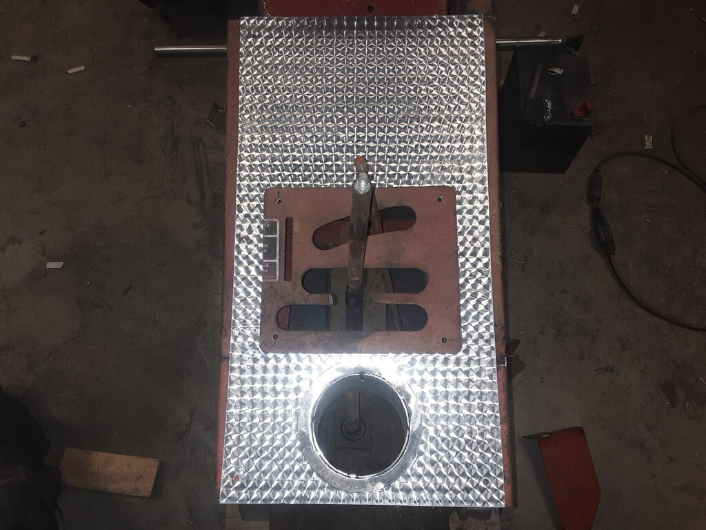

One more part roughed in. Onto the next.
  • Like 2
  • Excellent 3
ebinmaine
Cup holder maybe four or five inches deep?
ebinmaine
If you're going to use that for glass you may want to put a little piece of cork on top of the transmission
  • Excellent 1
  • Thanks 1
Oldskool
Good idea. There will be a bottom in it but what bottom couldnt use a bit of cushion. It will mostly be a can in that holder though.
  • Haha 1
Oldskool
3in deep.
  • Like 1

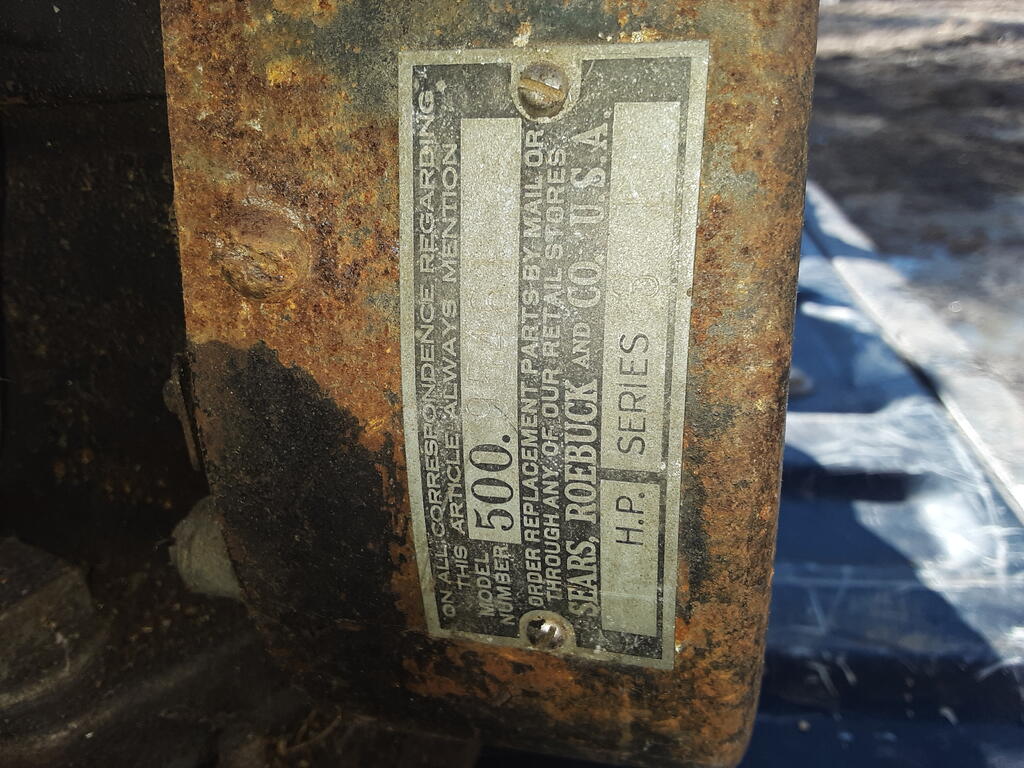

Maybe I should repower with this? Just picked this up today.
  • Like 1
  • Heart 3
ebinmaine
@Stepney
  • Like 1
Stepney
Briggs WMB in Sears/Economy clothes. The tank isn't quite right but that's a washing machine engine. The cap screw with the holes in the exhaust was originally part of an elbow, and the flexible hose for the muffler went off of that, through the window, and outside of where the machine was located. Chock cap seems to be there but you are missing the needle valve for the carb.
I have the exact same engine, burns more oil than gas and I use it to smoke mice and other critters out of the shed and holes around the yard.
It's rated 1/2hp on it's best day, you can stall it with a leather glove. But it'll run a small water pump or a compressor. Or a washer, if you're crazy like me. Or a small ice cream churn..
  • Like 1
  • Excellent 3
ebinmaine
:icecream:
  • Haha 1
Oldskool
Yum! Ice cream.....
  • Haha 2
Oldskool
Maybe power for my
Hawthorne bicycle
  • Like 1
  • Thanks 1
Stepney
  On 3/19/2021 at 10:25 PM, Oldskool said:
Maybe power for my
Hawthorne bicycle
Friend of mine had a very similar WMB on a Columbia Rambler, worked pretty slick. It's almost a twin to the Whizzer motor bike engines. Those engines are about as common as an old boot at the swap meets. I know I dont have a carb but a friend up in Farmington has a bucket with some in it. I'll grab one next time I visit unless you find one first. It's an odd shaped screw with a very fine thread. It's a pot metal carb, be gentle with it. The throttle is a 'drum' inside and rotates instead of a butterfly.. again, be gentle. I'm not sure there's anything else quite small enough to replace it.

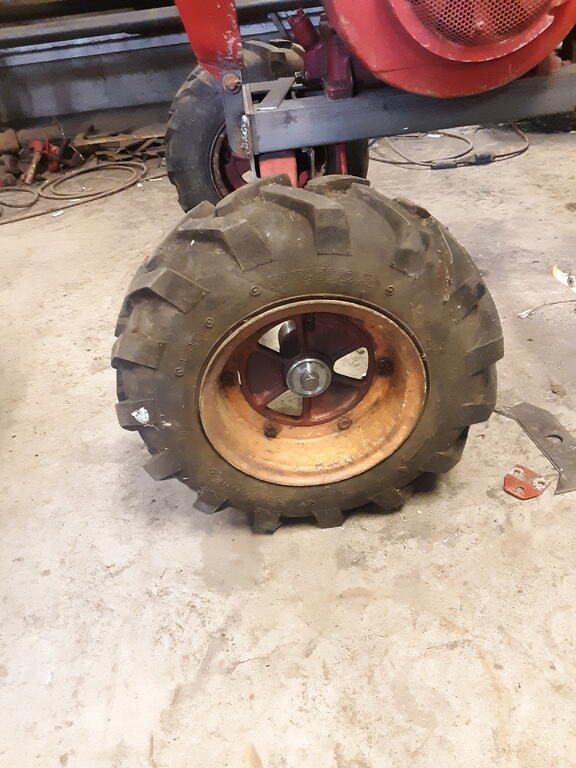

Front tires are mounted.
  • Like 4
