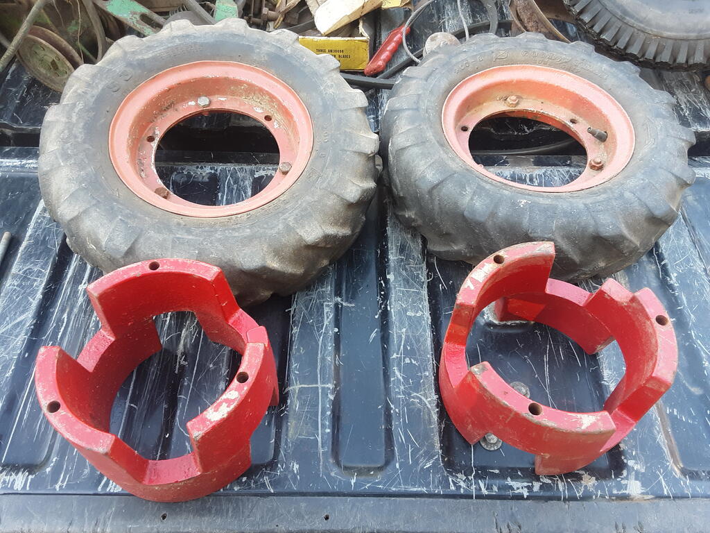

I see how you made the adaptor, but how did it get centered on the wheel?
Oldskool
The 4.5" O.D.of the adapter is the same size as the 4.5" O.D. of the original center hole of the Chevy wheel. So it just dropped right in. The center of the adapter is roughly 3-1/16" for the hub center.

Handy Don
And the ID of the adaptor fit around the raised center of the WH hub. And you could even scribe the bolt circle onto the adaptor while it was on the lathe.
Right tools and good thinking. Nice.
