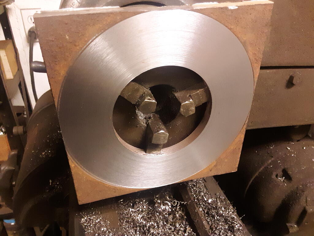

@Oldskool  what did you use for the brake drums? Make them your self or used something on hand?
19richie66
Very nice!
Oldskool
I used Ford Explorer rotors and just cut off the original braking surface.

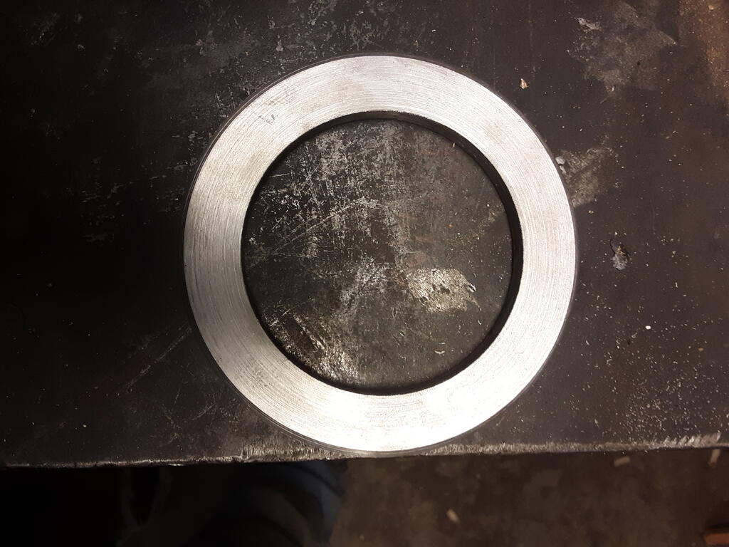

Handy Don
Even as I watch it doing what you'd hoped for, I'm still trying to figure out how you got the new hubs perfectly centered!
Kudos on the design and the build.
Oldskool
Oldskool
@Handy Don this is how

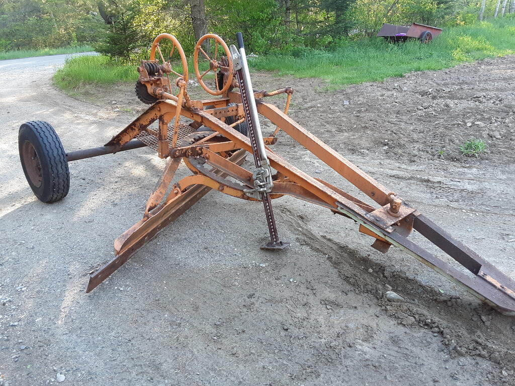

7 minutes ago, Oldskool said:
Not yet. Tonight I'm going to hook onto something heavy to get my front wheels floating. I'm curious to see how well I can steer in that scenario
Don't expect perfection the first shot.
Making something do that kind of maneuver may take a bit of practice.
Anything that's heavy...ish enough to lift the front but then let you drag it?
Oldskool
I just tried pulling this off a trailer. With a trans mounted hitch the pull point is to low to the ground to pull the front wheels up. I just ended up making 2 pot holes.
2 minutes ago, Oldskool said:
....... this .......
Just showed that to BBT.
She says "Izzatt for meee?"
Also, "Why wasn't THAT in a trade deal???"
:ROTF:
  • Haha 4
Oldskool
:ROTF:
It just landed here. Delivered. Bought it for $500. Tell Trina I'm sorry 🙂

DennisThornton
Wow!  Take two people to operate but that should do a super fine job!  Try as I may, nothing I have will do what that will do no matter how many passes I make.
Oldskool
Ya it's one soggy  S.O.B
