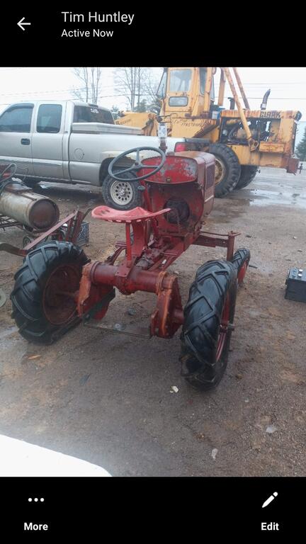

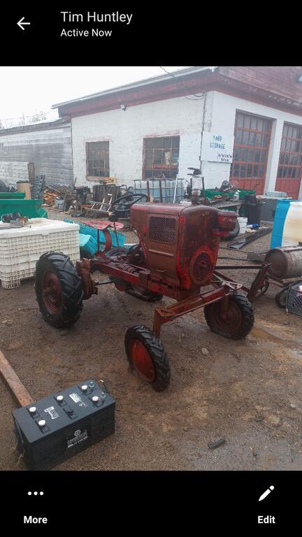

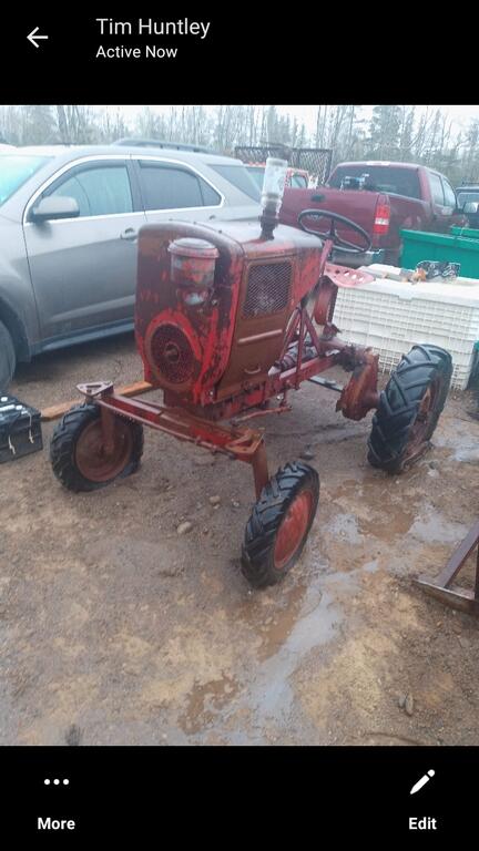

What is this?????

19richie66
Cool is what it is!

  On 5/5/2021 at 10:24 PM, 19richie66 said:
Cool is what it is!
I have no idea. Trying to find out. Also trying to work out a deal on it.
rjg854
Shaw Du-All   :confusion-scratchheadyellow:
Is my guess fwiw
  • Excellent 1
DennisThornton
Knowing more about the engine/tranny might help someone.
  • Like 1
Lee1977
I don't know what it is,. but the engine, gas tank and covers look like a stationary power unit.
  • Like 2
Oldskool
I dont have much info. Twin cylinder Wisconsin with 16in rear wheels.
I did get it ID'ed. Ita an Atomic Babe model B.
  • Like 2
  • Excellent 1
DennisThornton
That's a new one to me!  Looks substantial!
  • Like 1
Oldskool
Ya it sure does look rugged. Kinda looks built like a WH Senior
  • Like 1
DennisThornton
I've saved pictures of it!
  • Like 1
DennisThornton
Found this tidbit online:
"Doylestown Machine Company of Danboro, PA in the early 1950's. "
  • Excellent 1
