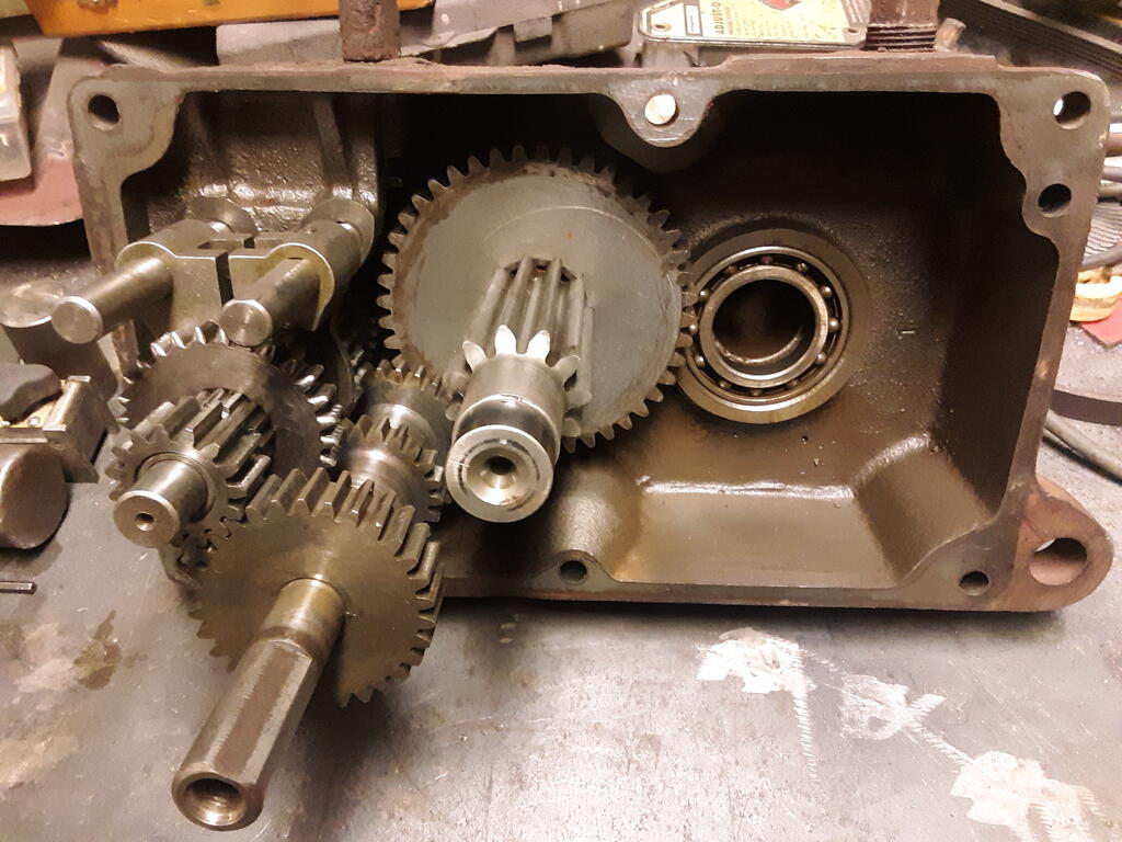

4 minutes ago, Oldskool said:
Everything is looking pretty good inside. No excessive wear, no chipped teeth. All the inner bearings look good and spin nicely.
Then why did you open it up? Or did I miss something?
Oldskool
Out with the old. In with the new. I did drop 1 ball bearing on disassembly. So I will have to find one somewhere.
Oldskool
The outer wheel bearings were shot. Also this is a new to me transmission so I wanted to see where I stood with it.
Always a good idea.

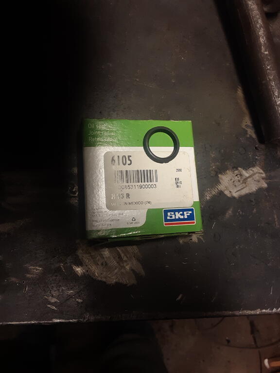

Almost all the seals are in. I HAD a new input shaft seal. Yup.... crunched it putting it in. Called every place within 60 miles and cant get one till Monday.
And now we know why Eric Bear always orders several of them.
Oldskool
Oh looky looky. @ebinmaine good thing you do buy several. Thanks for throwing one in the goody box. Your a life saver. Im glad I went diggingthru all that stuff.

I hope I dont crunch this next one. It's so small. Any tips and tricks for installation?
Same as any other seal you've done really.
Oil it well so it moves easily.
If the shaft has a keyway, tape it.
I try to use the object that rides on the shaft as the arbor to install the seal.

That's what I did with this one. It went. My gasket and shift boot just showed up. Now if I had that 1 ball bearing I could bolt this thing together. I cut into a couple of old bearings I had here but no luck. Wrong size.

It must be my lucky day. I found that ball bearing. When I pulled the shift fork rod out the ball bearing shot right into the passage to the back of the case. Sat right there in a dab of grease. So I made it this far tonight.

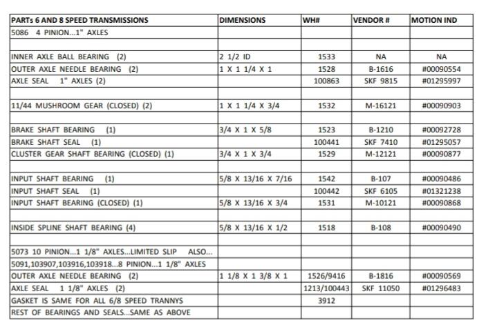

Maybe it is a good idea, to have something like an Excel sheed or better a PDF
for each gearbox, with all the needed Bearings and seals they be used in it.
Makes it easier to collect all the Material before you do a rework.
  • Thanks 2
6 minutes ago, Tractorhead said:
Seems you can count on a Bear..👍
There's a bearing and seal cross reference thread that does.
That's where I get my part numbers.
Oldskool
I downloaded a pdf from here to get the part numbers for this transmission. It's not often I mess up a seal. I should have ordered extras the first time around but will be ordering more very soon though.
