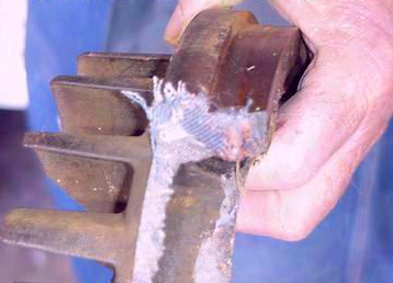

seuadr 488 #14 Posted March 19, 2021 On 3/15/2021 at 8:01 PM, Achto said: This is true. If they find any flaw in your flywheel, like a minor crack or a chip in a fin for instance it will go in the scrap metal pile. so i shouldn't bother to ship this one? (not mine, just a pic i came across once) 1 Share this post Link to post Share on other sites
Achto 28,125 #15 Posted March 19, 2021 Signs say NO. Share this post Link to post Share on other sites
