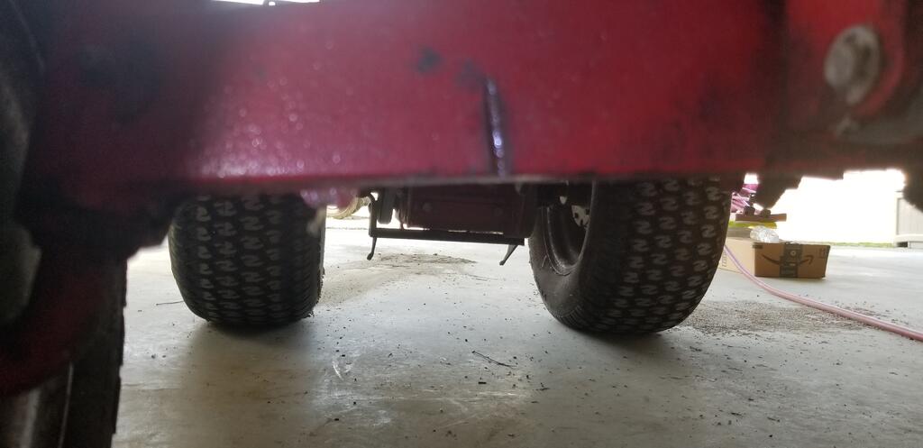

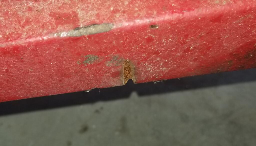

racerjohnbf 130 #1 Posted March 14, 2021 So I finally got started on my new to me 314-8. I got it running pretty easily with basically a good fuel tank flush, new fuel line with inline filter, and an in place carb cleaning. Next will be a full baseline service and I will outline that tomorrow as I saved my list on my work cpu. It runs good other than a loud backfire if you throttle down too fast. Seems like it's getting a little too much fuel because it will also give a puff of black smoke on quick acceleration. It a Walbro fixed main jet carb..... Thinking maybe a leaky inlet needle? Also I noticed a fairly deep groove in the front axle that appears to have come from the mule drive pulley. Should I be concerned about this weakening the axle? Its probably a good 1/4 inch deep. Share this post Link to post Share on other sites
roadapples 6,983 #2 Posted March 14, 2021 Can't imagine using it hard enough for that groove to hurt anything... 1 1 Share this post Link to post Share on other sites
CCW 1,315 #3 Posted March 14, 2021 If it works as well as my 312-8 you have a great machine. 2 1 Share this post Link to post Share on other sites
racerjohnbf 130 #4 Posted March 14, 2021 (edited) 48 minutes ago, roadapples said: Can't imagine using it hard enough for that groove to hurt anything... That's what I was hoping to hear. I was figuring to just fill it with JB weld and put some touch up paint over it. Just didn't know if it being a groove would make for weak spot for the cast iron to crack. 36 minutes ago, CCW said: If it works as well as my 312-8 you have a great machine. Thanks! I can't wait to put it to work. Edited March 14, 2021 by racerjohnbf 1 Share this post Link to post Share on other sites

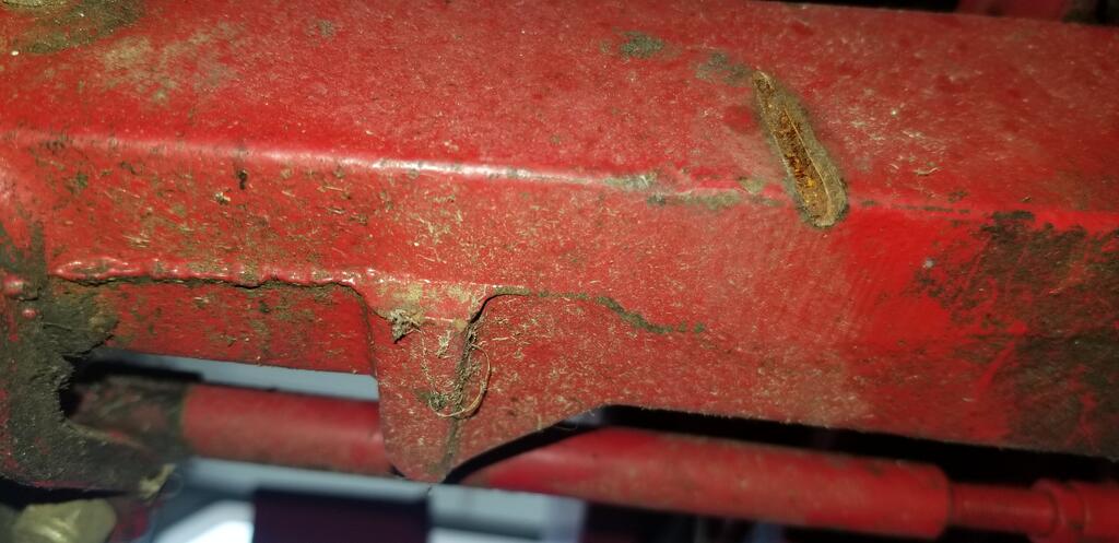

racerjohnbf 130 #5 Posted March 14, 2021 A couple more pics of the groove.... Share this post Link to post Share on other sites
CCW 1,315 #6 Posted March 14, 2021 (edited) I would not worry about that groove at all. Edited March 14, 2021 by CCW 2 Share this post Link to post Share on other sites
Ed Kennell 39,855 #7 Posted March 14, 2021 Just a minor battle scar. Probably made it a tougher machine. 4 Share this post Link to post Share on other sites
elcamino/wheelhorse 9,360 #8 Posted March 14, 2021 I would not worry about that little scar. Glad to heard you got it running . I save old tractors , sells a great replacement carb. 1 Share this post Link to post Share on other sites
Jeff-C175 7,203 #9 Posted March 14, 2021 I'm curious as to how the mule drive pulley could have dug into the axle like that? Was something installed wrongly? I'd be more concerned about the condition of the pulley myself. 3 Share this post Link to post Share on other sites
racerjohnbf 130 #10 Posted March 14, 2021 @CCW @Ed Kennell @elcamino/wheelhorse Thanks! I don't have a problem with a few battle scars. I'm sure she'll get a few more. I'll probably rebuild the original carb correctly at some point, injustice couldn't wait to hear her run. Any ideas on the backfire? Share this post Link to post Share on other sites
racerjohnbf 130 #11 Posted March 14, 2021 1 minute ago, Jeff-C175 said: I'm curious as to how the mule drive pulley could have dug into the axle like that? Was something installed wrongly? I'd be more concerned about the condition of the pulley myself. That's a good question. I'll certainly investigate further before I hook up the mule drive and deck again. 1 Share this post Link to post Share on other sites
Jeff-C175 7,203 #12 Posted March 14, 2021 (edited) 10 minutes ago, racerjohnbf said: Any ideas on the backfire? SOMEtimes... and I'm hesitant to say this... backfire can be caused by leaky exhaust valve. Can you do a cylinder 'leak down test'? You might also consider pulling the head and decarbonizing everything. Sometimes the carbon buildup gets red hot and can ignite the mixture when it shouldn't be ignited. My neighbors brand new green tractor backfires every time he shuts it off. There's some sorta electric gadget on the carb that is supposed to stop if from doing this but I don't know what that gadget does. Some sorta fuel cut off solenoid? Edited March 14, 2021 by Jeff-C175 3 Share this post Link to post Share on other sites
racerjohnbf 130 #13 Posted March 14, 2021 @Jeff-C175 Yes I hadn't thought about a leak down test, but I'll try that. Appears to be excess fuel on acceleration and deceleration. If I raise the throttle from idle to full too quickly I get a puff of black smoke. And if I reduce throttle from full to idle too quickly I get a loud backfire. If I make throttle adjustments slower everything seems normal. It does this even if the engine has only run a few mins to warm up first. And no backfire at shutdown. 1 Share this post Link to post Share on other sites
