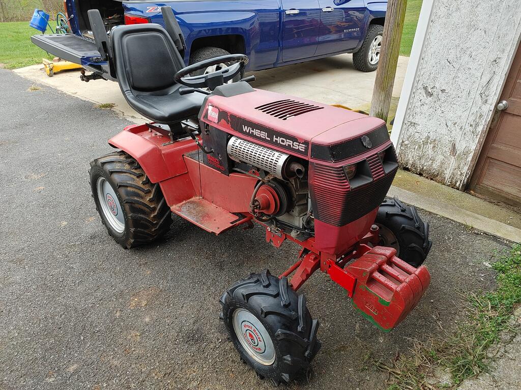

WVHillbilly520H 10,374 #6 Posted March 13, 2021 1 minute ago, seuadr said: (is the front lifting essentially a sign that i need to ease off and be more patient?) I believe so, but you may try adding a bracket and weights like I did for clevis hitch attachments/furrow plowing 1 Share this post Link to post Share on other sites
seuadr 488 #7 Posted March 13, 2021 That is exactly what i was looking at. I think my wheels should break loose before something breaks on yhe tractor but I don't know what kind of abuse that'll give the rock shaft and I don't want to damage it. Share this post Link to post Share on other sites
