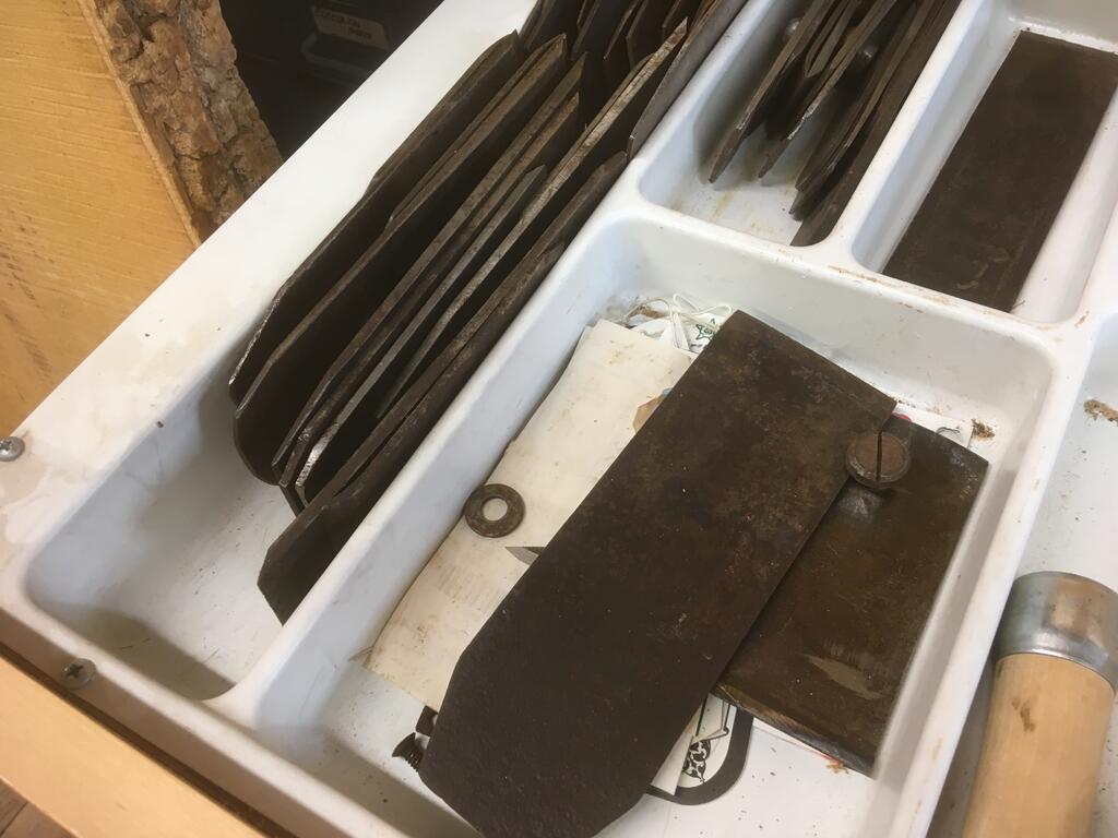

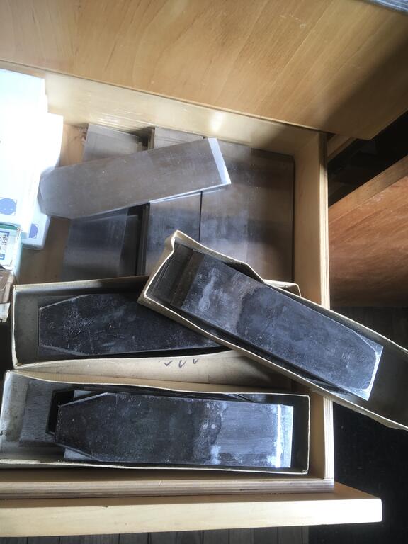

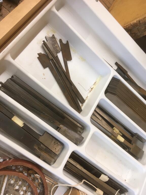

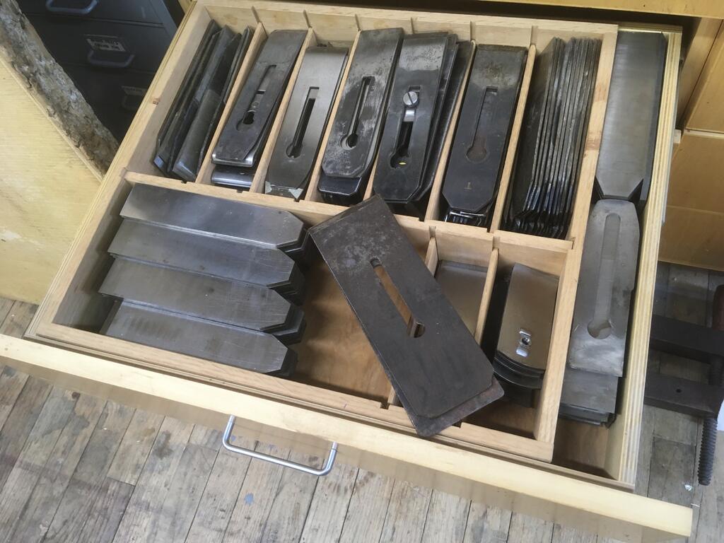

Pullstart 64,463 #5 Posted March 13, 2021 I didn’t realize so many planes existed! Cas, approximately how many planes do you have? I know you make a lot of them, you have more wood working talent in your left pinky than my whole body! Share this post Link to post Share on other sites
The Tuul Crib 7,338 #6 Posted March 13, 2021 Nice job cas!! Enjoyed watching! Share this post Link to post Share on other sites
formariz 11,993 #7 Posted March 13, 2021 (edited) 11 hours ago, 8ntruck said: Or do what I've always done - learn how to do it right handed. I can do more tasks with my right hand than most right handed people can with their left hand. That is many times what I need to do also if I find opposing grain. I use them left handed or use them in reverse pulling rather than pushing them. 3 hours ago, pullstart said: I didn’t realize so many planes existed! Cas, approximately how many planes do you have? I know you make a lot of them, you have more wood working talent in your left pinky than my whole body! There are literally thousands of planes with different functions. I don't know how many I have but they are in the hundreds (easier to hide from wife than tractors). Many are displayed inside house on the first floor. They are not allowed past the stairs lol. Any one can do this work. Its like any other skill. I was just lucky that in reality I was born into it and was always surrounded by people in the same situation so it was never just a job but actually a way of life. Making planes has always been perhaps my favorite activity in this craft and I wish I had more time to do it. I still have herein stock enough irons to make a couple of thousand more. Most of them extremely rare one over 100 years old. Some of my "stock" below. 2 hours ago, The Tuul Crib said: Nice job cas!! Enjoyed watching! Thank you I appreciate that coming from you. I always hope more get into this interest we have. Edited March 13, 2021 by formariz 2 Share this post Link to post Share on other sites
