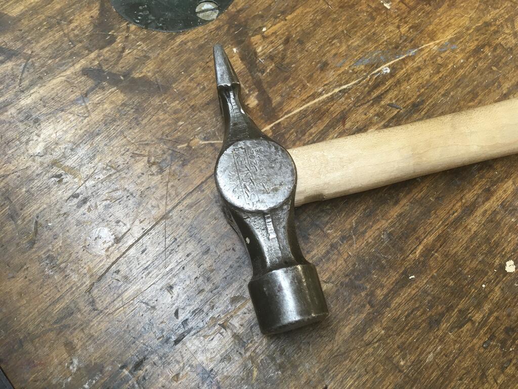

DennisThornton 4,772 #5 Posted March 11, 2021 I've made raised panels but I never seen an adz used to rough them out. Seems much faster and very handy for the aggravating end grain! I think machinery is for repeated cuts and mass production. I think you made that single raised panel by hand in about the time it would take with a tablesaw and then still have to deal with the sawmarks. I really like that hammer! Share this post Link to post Share on other sites
formariz 12,352 #6 Posted March 11, 2021 6 minutes ago, DennisThornton said: I think machinery is for repeated cuts and mass production. I think you made that single raised panel by hand in about the time it would take with a tablesaw and then still have to deal with the sawmarks. Anything over 20 a shaper will do it faster. Under 20 however by the time one installs cutters, adjusts machine to cut panel correctly, sets up all the safety measures, the panels will be finished by hand. There will be no sanding needed to remove inevitable chatter marks from cutters. Plane will leave wood glass smooth. I can do them much faster than in video if i don't have to worry about camera and screwing up on video LOL. 12 minutes ago, DennisThornton said: I really like that hammer! Warrington Hammer better known as a cabinet makers hammer. Share this post Link to post Share on other sites
DennisThornton 4,772 #7 Posted March 11, 2021 5 minutes ago, formariz said: Anything over 20 a shaper will do it faster. Under 20 however by the time one installs cutters, adjusts machine to cut panel correctly, sets up all the safety measures, the panels will be finished by hand. There will be no sanding needed to remove inevitable chatter marks from cutters. Plane will leave wood glass smooth. I can do them much faster than in video if i don't have to worry about camera and screwing up on video LOL. Warrington Hammer better known as a cabinet makers hammer. Nothing is nicer than a planed or scraped finished surface. We need to see if we can get you some camera help... How many ounces is that hammer? Share this post Link to post Share on other sites
formariz 12,352 #8 Posted March 11, 2021 12 ounces 1 Share this post Link to post Share on other sites
