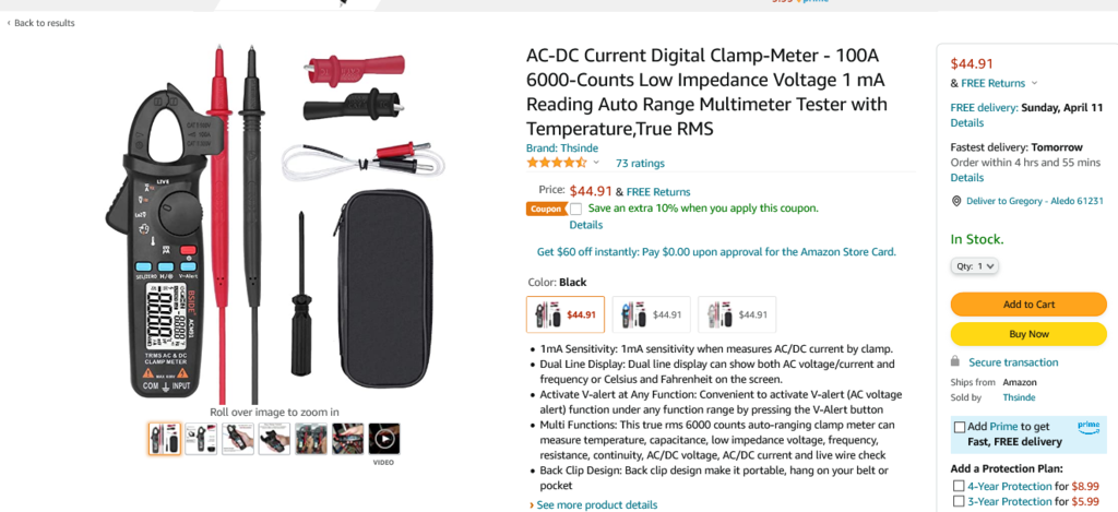

Gregor 4,848 #64 Posted April 6, 2021 Guess I don't have one of those. Just AC clamp on ammeter. Share this post Link to post Share on other sites
squonk 47,974 #65 Posted April 6, 2021 You can get a relatively inexpensive one on the jungle site. I got mine over 20 yrs ago. Very hard to find then. Share this post Link to post Share on other sites
Gregor 4,848 #66 Posted April 6, 2021 Would this do it? Share this post Link to post Share on other sites
squonk 47,974 #67 Posted April 6, 2021 Says AC/DC current so it should. 1 Share this post Link to post Share on other sites
