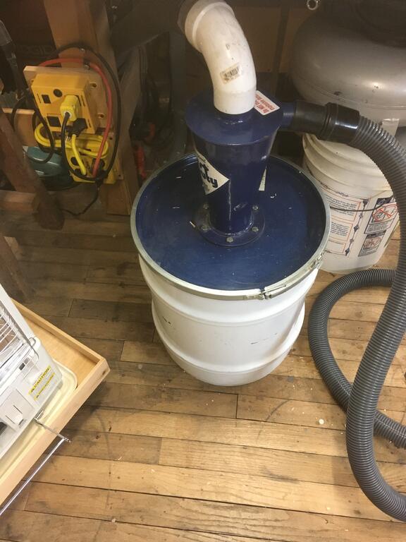

formariz 11,993 #5 Posted March 7, 2021 (edited) Not knowing what you are willing to spend it is hard to make suggestions. However a cyclone separator is the most efficient method that will not clog any filters or bags. I use two of those. One small one connected to a shop vacuum used to clean shop and attach to small tools such as a router and sander, and a larger one attached to an inexpensive dust collector from harbor freight. The last one is dedicated to the top side of table saw only. Bothe will drop collected dust to their container without clogging vacuum filter or bag . As a matter fact I probably have not opened my shop vacuum in over one year, but sometimes emptying the cyclone container twice per week. The small cyclone has a much higher static pressure than the larger one. Edited March 7, 2021 by formariz 4 Share this post Link to post Share on other sites

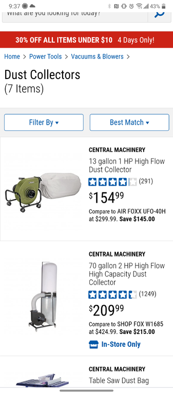

pacer 3,175 #10 Posted March 7, 2021 (edited) I've got this one from HF for my HF blast cabinet and it really does well - I got it back when HF was offering the 20% coupons and it helped on cost. (its reg $149) But if you do a lot of blasting this is the ticket, it and modifying the cabinet from a vid on youtube has made that cabinet indispensible !!! Look up 'blast cabinet reclaimer kit' Edited March 7, 2021 by pacer 1 Share this post Link to post Share on other sites
oliver2-44 10,342 #11 Posted March 7, 2021 7 hours ago, pacer said: I've got this one from HF for my HF blast cabinet and it really does well - I got it back when HF was offering the 20% coupons and it helped on cost. (its reg $149) But if you do a lot of blasting this is the ticket, it and modifying the cabinet from a vid on youtube has made that cabinet indispensible !!! Look up 'blast cabinet reclaimer kit' I had read where several people had good luck with that HF Dust Collector. So I bought one and got the bad one in the batch. It worked so-so for less than one tractor. But blew a fair amount of dust out the fan. Then the fan blades exploded. HF does not sell a replacement fan. I now see a couple of other companies selling one that looks just like the HF one. I wonder if the quality is any better for a few more $.. 1 Share this post Link to post Share on other sites

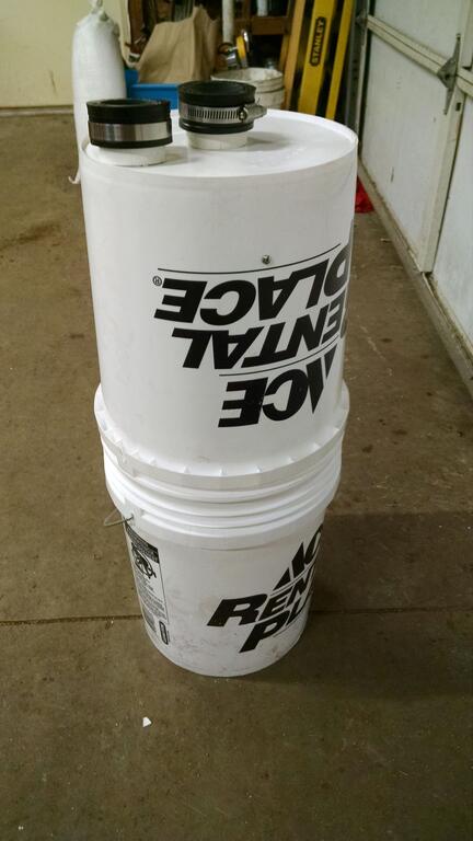

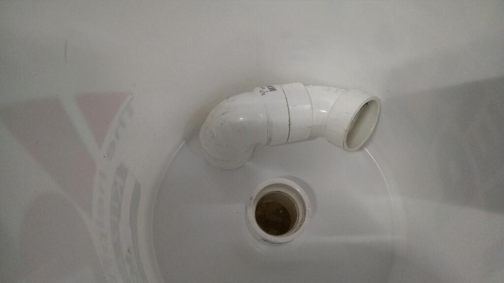

Achto 28,694 #12 Posted March 8, 2021 (edited) Well I decided to give the dust collector from the video a try. Here is the one that I built. BTW using a hook blade in an oscillating tool (like shown in the video) works awesome for cutting plastic I picture of the inside. I'm about $15 out of pocket and 45min on the clock to get it ready for operation. Now for the performance report... After all the time & money that I stuck into this collector of course had to try it out. I blasted about a 1/2 dozen pieces for the 701 that I'm currently working on using coal slag for media. Visibility in the blast cabinet was great, with very little dust in the air. When I was finished there was some dirt in the bottom of the dust collector and the new filter on the Shop Vac looked as clean as it was when I installed it. So far I would give this dust collector two thumbs up. If my opinion changes I will be sure to let you know. Edited March 8, 2021 by Achto 4 Share this post Link to post Share on other sites

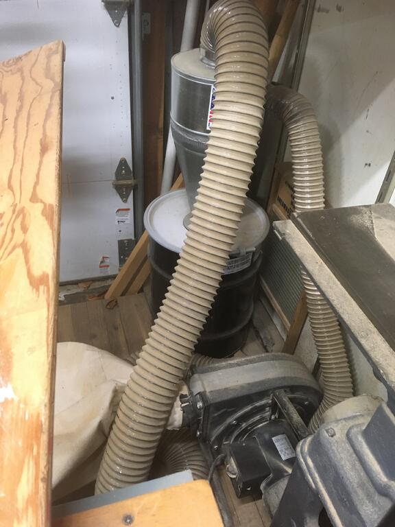

82Caddy 851 #13 Posted March 8, 2021 I did the same thing you made @Achto just on a bigger scale with a 55 gal plastic drum. Hooked up to a harbor freight dust collector with a canister filter and it’s worked well for me so far for blast cabinet use as well as woodworking. 3 Share this post Link to post Share on other sites

Achto 28,694 #18 Posted March 12, 2021 (edited) On 3/8/2021 at 9:20 AM, oliver2-44 said: Please keep us updated @Achto I had watched that video build a few weeks ago and have been thinking about building one too. So far I have 8hrs using this dust collector and I am still happy. That's 4 more hours than my last vacuum lasted with out the dust collector. The filter in my vacuum still looks clean. I do have an issue with it wanting to collapse when the filter inside the blast cabinet plugs up but I use this for a gauge to know when to clean the filter. There is a part 2 video that tells how to cure this collapsing issue with 2 more pails, but I am going to leave mine as is. Edited March 12, 2021 by Achto 1 1 Share this post Link to post Share on other sites
