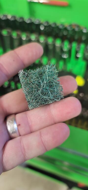

ebinmaine 80,601 #7 Posted March 7, 2021 I'm thinking the po is referring to the breather in the front of the engine block near the carb. I don't know what the actual recommended service interval is. If you don't know when was the last time it's been done, change it. Just peace of mind if nothing else. When you take it apart pay close attention to the orientation of the pieces. There's a drain hole in the bottom of a tray that must be put back right or you'll see what a smoke cloud is. What are you using for filter media? Share this post Link to post Share on other sites
Mickwhitt 5,259 #8 Posted March 7, 2021 Having just rebuilt mine after overhauling the engine i agree with Eric, take care that it goes back together correctly. That means as per the manual, not as you stripped it down as a PO may have built it up wrong. There are stamped in marking for Top on the cover and the leak hole must go down on the inner plate. The filter media looks like some kind of fibre mesh in a block. It was oiled and dirty but a wash in solvent restored it to clean and new looking. Take care about the metal Reed valves, they open and close to allow the engine to breathe, hence the term breather unit. Also when I got the complete engine new gasket kit there was a piece of 1/4 inch inside diameter rubber fuel pipe about a half inch long in the bag. No mention of it in the contents and I couldn't think what it was for and it was going in the bin as a mistaken addition. But as I built up the breather it became obvious the rubber tube went over the stud to act as a spacer cum seal between the two parts of the breather unit. Not sure if this is in the manual but I didn't see any reference to it as I did my rebuild. Hope this helps. Mick 2 1 Share this post Link to post Share on other sites

haydendavid380 759 #11 Posted March 7, 2021 3 hours ago, ebinmaine said: What are you using for filter media? NOS Kohler filter media I bought off the auction site for a couple bucks 1 1 Share this post Link to post Share on other sites

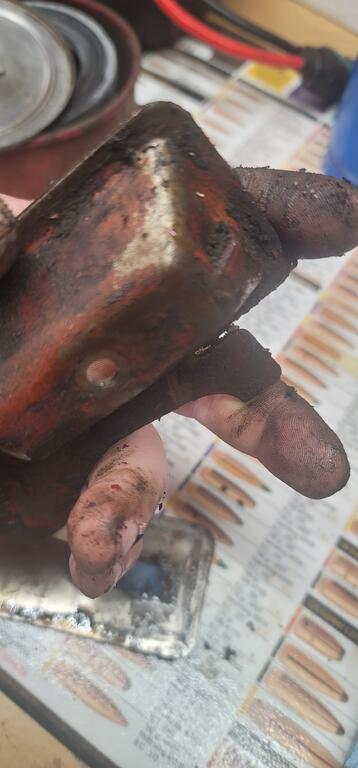

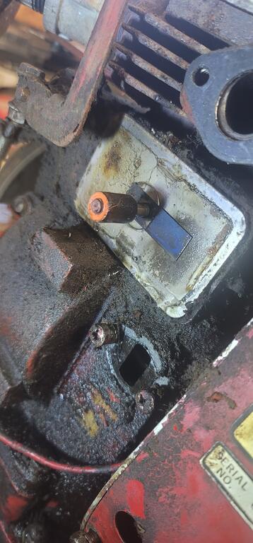

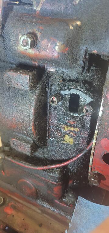

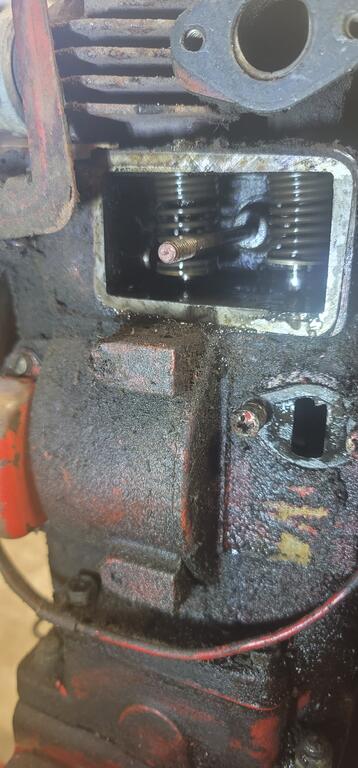

haydendavid380 759 #13 Posted March 7, 2021 Is it possible to be leaking oil out of where the fuel pump goes in? That's what it looks like to me now that things are starting to come apart Share this post Link to post Share on other sites
haydendavid380 759 #14 Posted March 7, 2021 Wow, that's gross. It also seems like a lot of moisture. Share this post Link to post Share on other sites

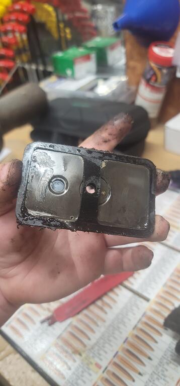

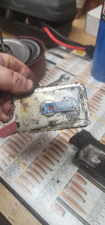

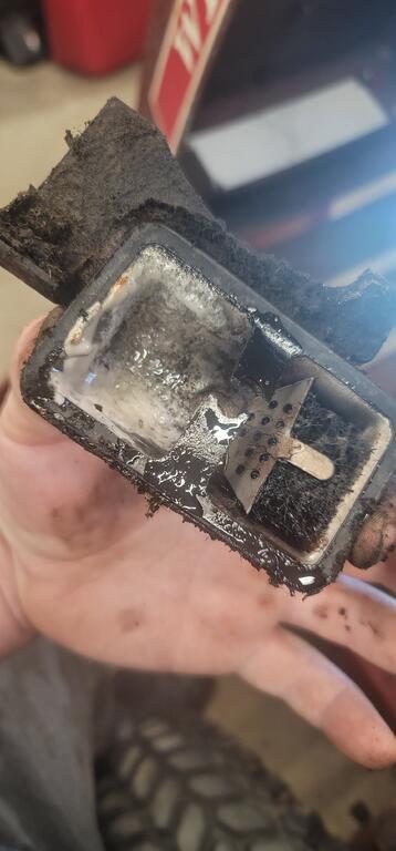

haydendavid380 759 #15 Posted March 7, 2021 After cleaning the outside I found where it gets fresh air 😲 Completely packed both inside and out. Here's the valves and the plate 2 Share this post Link to post Share on other sites
haydendavid380 759 #16 Posted March 7, 2021 2 hours ago, pfrederi said: If there is a lot of oil on the front of the engine you may have a worn engine with excessive blow by. Trying to eliminate the easy stuff first. Doesn't show any signs of being tired. Wouldn't increased crank pressure from not breathing lead to blow by? Share this post Link to post Share on other sites
lynnmor 9,037 #17 Posted March 7, 2021 1 hour ago, haydendavid380 said: Trying to eliminate the easy stuff first. Doesn't show any signs of being tired. Wouldn't increased crank pressure from not breathing lead to blow by? It's possible if there are no passages left for air to flow thru. The larger question is that the original oil installed when the tractor was built? 1 Share this post Link to post Share on other sites
haydendavid380 759 #18 Posted March 8, 2021 6 hours ago, lynnmor said: It's possible if there are no passages left for air to flow thru. The larger question is that the original oil installed when the tractor was built? The oil in the pan looks fine. Changed it right before winter and it has maybe 10 hours on it. I just think the condensation was stuck in the breather and it frothed up there. Share this post Link to post Share on other sites
