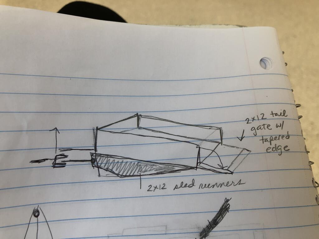

krystolo 504 #19 Posted March 4, 2021 Forgive my amateurish tinkering, but I just love problem solving. What about something like this? Bed would be 6’x4’ with it being wider than long for easy loading. The angled runners would give an extra bit of tilt for dumping. Back tailgate for pushing stuff in with the dozer blade. Now, to figure out a way to lift the hitch end. How far does the Brinly lift? Maybe a hoist? Estimate I’ll need 30-40” of lift to get to 60 degree dump angle. 1 Share this post Link to post Share on other sites

DennisThornton 4,769 #21 Posted March 4, 2021 3 hours ago, krystolo said: Forgive my amateurish tinkering, but I just love problem solving. What about something like this? Bed would be 6’x4’ with it being wider than long for easy loading. The angled runners would give an extra bit of tilt for dumping. Back tailgate for pushing stuff in with the dozer blade. Now, to figure out a way to lift the hitch end. How far does the Brinly lift? Maybe a hoist? Estimate I’ll need 30-40” of lift to get to 60 degree dump angle. Last time I was on a WH and wanted to push dirt into something I parked my CUT with 6ft bucket where needed. BUT, I think you are on to something BUT you will need the sled held there and then what will you do when you get to where you want to unload? Still need a lift/dump means. Doable for sure. 1 Share this post Link to post Share on other sites
pfrederi 18,026 #22 Posted March 4, 2021 I am thinking as you push the dirt, poo, what ever in the trailer is going to try to run away from you. You would have to have it locked down pretty good. 3 Share this post Link to post Share on other sites

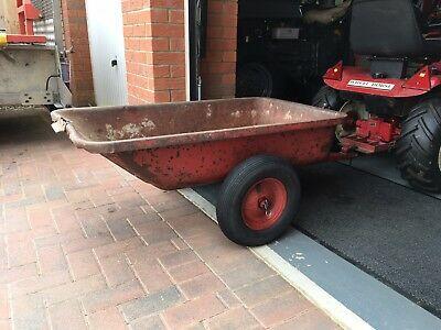

Pullstart 63,262 #23 Posted March 4, 2021 If your hitch attaches underneath the box mid way-ish, as you back up you could make it lift and dump... Old Wheel Horse trailers acted this way, with a clear along the back edge to help grab the ground. I found this picture on Google... 1 Share this post Link to post Share on other sites
krystolo 504 #24 Posted March 4, 2021 59 minutes ago, pfrederi said: I am thinking as you push the dirt, poo, what ever in the trailer is going to try to run away from you. You would have to have it locked down pretty good. Yeah, that’s a good point. 🤔 Share this post Link to post Share on other sites
krystolo 504 #25 Posted March 4, 2021 1 hour ago, DennisThornton said: Last time I was on a WH and wanted to push dirt into something I parked my CUT with 6ft bucket where needed. BUT, I think you are on to something BUT you will need the sled held there and then what will you do when you get to where you want to unload? Still need a lift/dump means. Doable for sure. 30 minutes ago, pullstart said: If your hitch attaches underneath the box mid way-ish, as you back up you could make it lift and dump... Old Wheel Horse trailers acted this way, with a clear along the back edge to help grab the ground. I found this picture on Google... Cool design! Share this post Link to post Share on other sites
