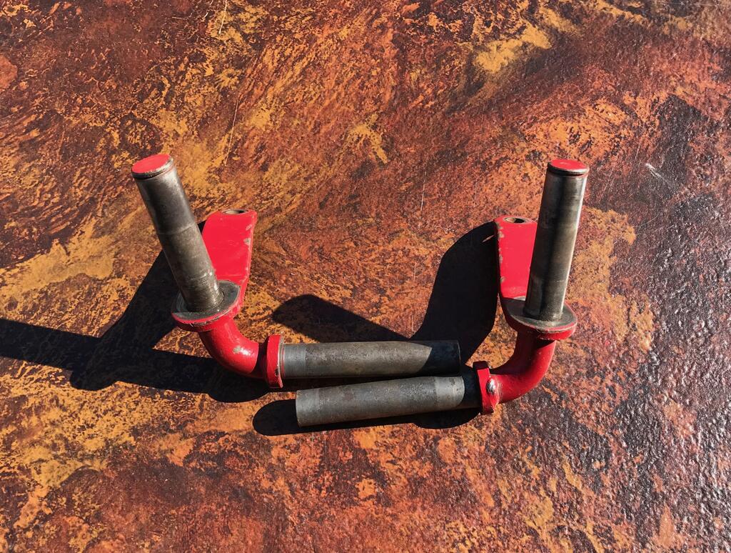

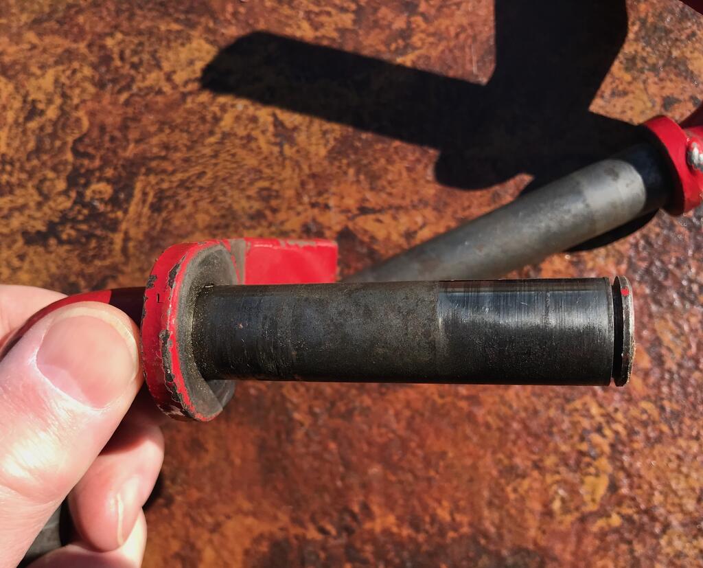

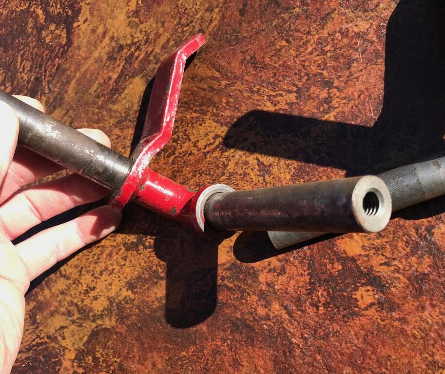

rustyedge1 176 #1 Posted March 3, 2021 (edited) Trying to ID these spindles. I have a 417 but mine are shorter through the rim and not threaded. Also have a B80 and C145 don't know about those.. The part which goes through the axle is 3" The threaded piece is 3&13/16" Any help would be appreciated. Thanks Edited March 3, 2021 by rustyedge1 Share this post Link to post Share on other sites
ebinmaine 70,803 #2 Posted March 3, 2021 That's what's on a lot of the older ones from the mid 60s or so up until the late 70s. 3 Share this post Link to post Share on other sites
Pullstart 64,620 #3 Posted March 3, 2021 Looks like something from a Charger or the like, as Eric mentioned 3 Share this post Link to post Share on other sites
ebinmaine 70,803 #4 Posted March 3, 2021 2 minutes ago, pullstart said: Looks like something from a Charger or the like, as Eric mentioned That's what's on my 74 c160 as well. 2 Share this post Link to post Share on other sites
squonk 42,584 #5 Posted March 3, 2021 I try to use the threaded ones on everything I can. I trust them more than the little clippy ones. 5 2 Share this post Link to post Share on other sites
Pollack Pete 2,273 #6 Posted March 3, 2021 1 hour ago, squonk said: I try to use the threaded ones on everything I can. I trust them more than the little clippy ones. Same here.A drop of loc-tite on the bolt threads and zero worries.Had way too many clips fall off by themselves,which is NOT a good thing. 1 Share this post Link to post Share on other sites

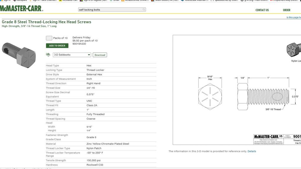

pfrederi 18,339 #7 Posted March 4, 2021 I prefer cotter pin spindles. But WH used special bolts with a plastic plug in the to keep the left side on. You might use these. (that is why older trucks had left hand threaded lug nuts on drivers side) 2 Share this post Link to post Share on other sites
gwest_ca-(File Mod) 11,252 #8 Posted March 4, 2021 5630 and 5631 spindles used on 164 tractor models starting in 1965 and ending in 1977. These use a bolt to retain the wheel and a retaining ring to retain the spindle to the axle. Replaced by 115425 and 115426 used on 1990 312-8 and 316-8 exported models. These use a cotter pin to retain the wheel and a retaining ring to retain the spindle to the axle. Garry 1 1 Share this post Link to post Share on other sites
ebinmaine 70,803 #9 Posted March 4, 2021 16 minutes ago, gwest_ca said: retain the wheel Do you show a listing for the ones that had the E-ring or C lock ring at the end of the outside of the spindle shaft? Share this post Link to post Share on other sites
gwest_ca-(File Mod) 11,252 #10 Posted March 4, 2021 Left spindle 105968 and right 105967 were used 1977-1983 model years. These use retaining rings to retain the wheel to the spindle and the spindle to the axle. Also replaced by 115425 and 115426 used on 1990 312-8 and 316-8 exported models. These use a cotter pin to retain the wheel and a retaining ring to retain the spindle to the axle. Left spindle 110213 and right 110212 were used 1984-1987 model years. These use cotter pins at both ends of the spindle. Also replaced by 115425 and 115426 used on 1990 312-8 and 316-8 exported models. These use a cotter pin to retain the wheel and a retaining ring to retain the spindle to the axle. There may be more. If wheels have different depth of hubs the axle part of the spindle will have different lengths. I do not know if that is another variable. The models using 6" wheels would be another series as the king pin part of the spindle is longer. Garry 1 1 1 Share this post Link to post Share on other sites
rustyedge1 176 #11 Posted March 4, 2021 As I said earlier I have a 417-8 and C-145 can these be used on either tractor ? Thanks for all the info. Share this post Link to post Share on other sites
gwest_ca-(File Mod) 11,252 #12 Posted March 4, 2021 On 3/4/2021 at 8:41 AM, rustyedge1 said: As I said earlier I have a 417-8 and C-145 can these be used on either tractor ? Thanks for all the info. I would say yes. The 5630 and 6531 spindles in your picture were used 1965-1977 on 164 different models so not original on the C-145 or 417-8. These were replaced by 115425 and 115426. The 1980-1983 C-145 used 105967 and 105968 spindles both replaced by 115425 and 115426. The 1984 C-145 used 110212 and 110213 spindles both replaced by 115425 and 115426. The 1985-1986 417-8 used 110212 and 110213 spindles both replaced by 115425 and 115426. Garry 2 Share this post Link to post Share on other sites

rustyedge1 176 #14 Posted March 25, 2021 On 3/4/2021 at 11:50 AM, rustyedge1 said: Thanks all... My 75 B-80 appears to have this spindle also. Share this post Link to post Share on other sites
