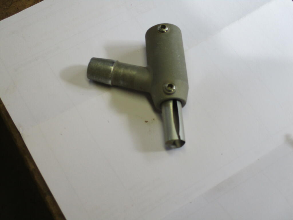

pfrederi 19,264 #1 Posted March 3, 2021 (edited) Guess I need to look at the business end of the blast gun more often. This was one of the expensive $50 carbide tips.... Guess I did more sand blasting than I thought.... Edited March 3, 2021 by pfrederi 1 2 Share this post Link to post Share on other sites

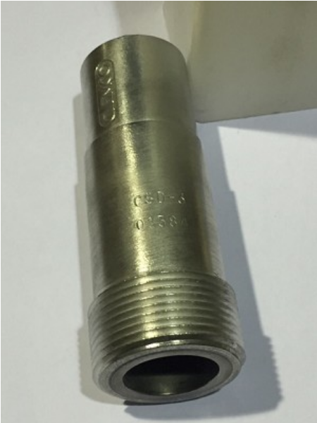

bc.gold 3,406 #2 Posted March 3, 2021 I think you've been robbed, tungsten carbide has a much darker color and because its very brittle it's encased as an insert as seen below. Share this post Link to post Share on other sites
squonk 44,860 #3 Posted March 3, 2021 22 minutes ago, pfrederi said: Guess I need to look at the business end of the blast gun more often. This was one of the expensive $50 carbide tips.... Guess I did more sand blasting than I thought.... Yup that's a lot of blasting right there. Prolly would have gone thru about 200 ceramic ones. How's the orifice? Was it still in there? Share this post Link to post Share on other sites
bc.gold 3,406 #4 Posted March 3, 2021 Once you have removed the worn out tip put it in a vise and tighten it up, if it bends without breaking ask for your $$$ back Share this post Link to post Share on other sites
pfrederi 19,264 #5 Posted March 3, 2021 The mind is a terrible thing to loose. That was a steel nozzle. Turns out the one in my parts box is the carbide one I bought but hadn't put in yet.... 4 4 Share this post Link to post Share on other sites
