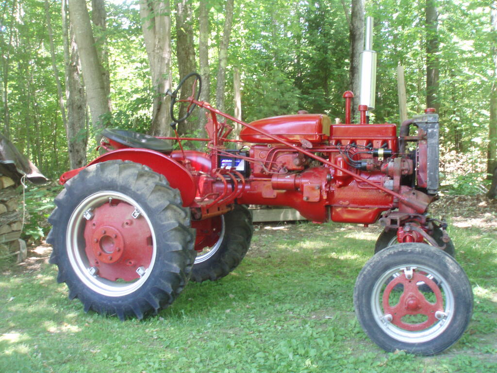

953 nut 57,932 #4 Posted March 3, 2021 High Crop tractors were used for cultivation and were primarily used by flatlanders so stability wasn't that big of a concern. As a kid I cultivated corn and potatoes with a 1949 Case SC much like the one pictured below. The taller rear wheels and narrow front made it less stable than a high crop would probably be but we had no problem. 4 1 Share this post Link to post Share on other sites

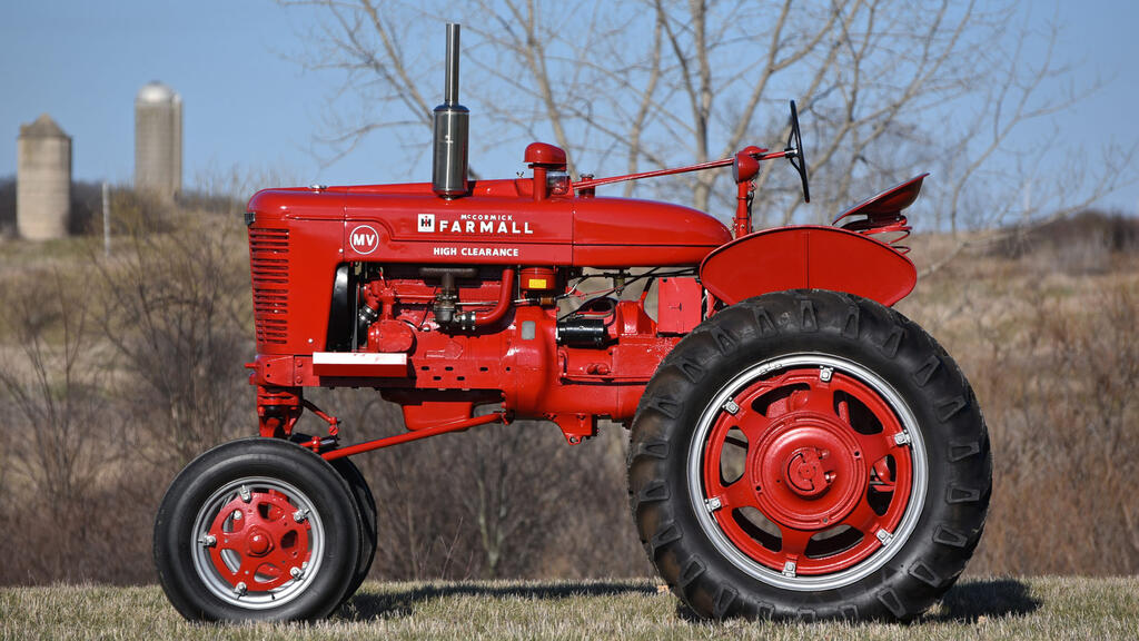

Achto 28,788 #12 Posted March 3, 2021 (edited) 47 minutes ago, JCM said: This Super A is sort of row cropish All of the letter series Farmall's (A,B,C,H,M and the Cub) were considered row crop tractors. They had adjustable widths and more ground clearance and were labeled Farmall. The high crop versions of the Farmall's would have the letter V after the first letter. Like this MV for example. During that time the W series (W4,W6,W9,) were considered standard tractors. The W4 had the same engine as the H. The W6 had the same engine as the M. The W9 stood alone and had the largest engine for IH at the time. These were mainly tillage tractors, they did not have adjustable widths and were labeled as McCormick's. Edited March 3, 2021 by Achto 4 3 1 Share this post Link to post Share on other sites

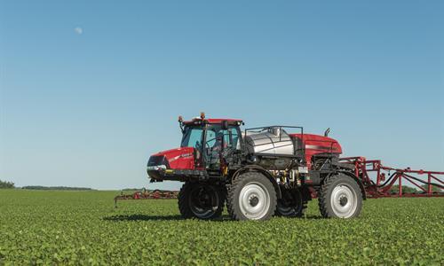

bc.gold 3,403 #17 Posted March 3, 2021 If you owned a tree farm then you would want one of these. 1 1 1 Share this post Link to post Share on other sites

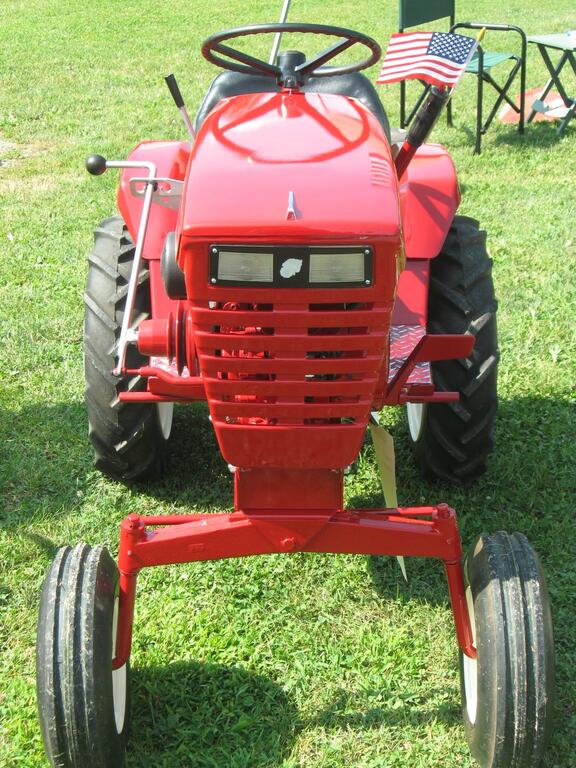

8ntruck 7,388 #21 Posted March 4, 2021 Interesting, the tractor in the front view has braces betwen the lower end of the spindles, while the tractor in the side view does not. 1 Share this post Link to post Share on other sites

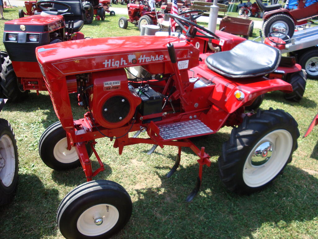

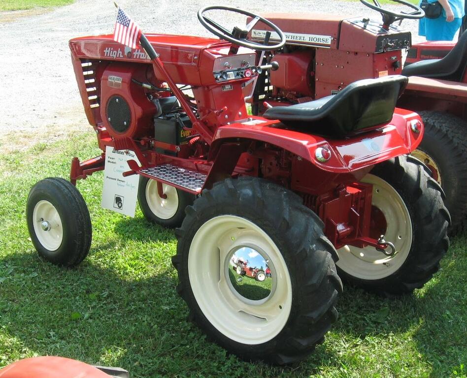

Zeek 2,286 #25 Posted March 4, 2021 (edited) Here's one that used to be at the WHCC Show now and then. I don't recall who owned it, but I think the brothers had a few modified tractors like an articulated and narrow front. This was from 2013. The articulated one is in the background. I found two more on the interweb . . . Edited March 4, 2021 by Zeek 2 2 Share this post Link to post Share on other sites
