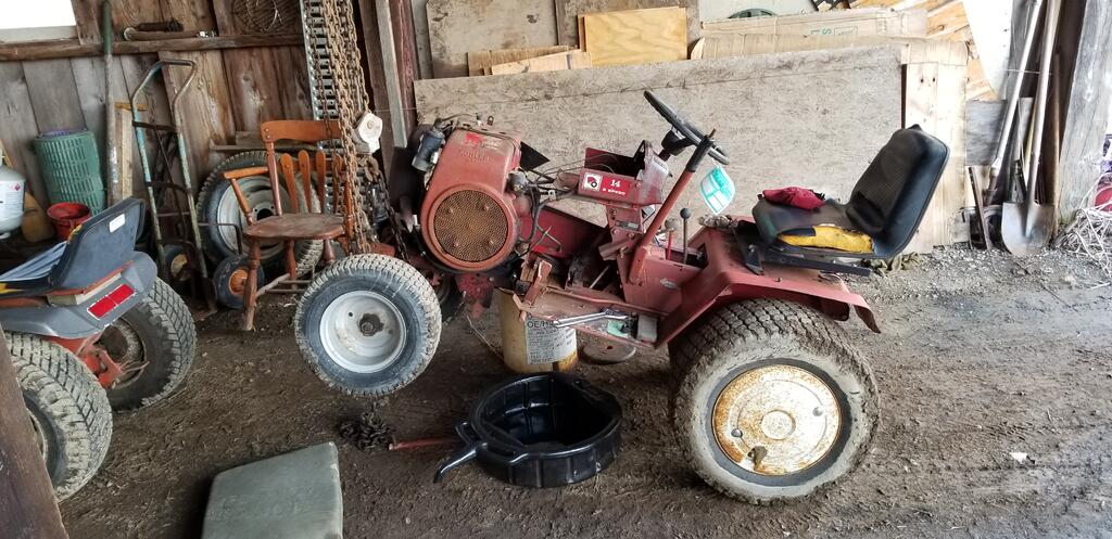

oliver2-44 11,058 #7 Posted March 1, 2021 I've done this to a couple of transmissions. For what it's worth, what I do is similar to others here. Jack up front of horse as safely high as possible 12-18+ inches. (since it winter time consider safely putting an electric heater under transmission to get transmission warm, then remove heater). Drain and let it drain until it quits dripping. Refill with 2 or more quarts of diesel or kerosene Drive it around for at least 5 minutes in each gear, or jack it up on jack stands and run through each gear. . Drain and refill with diesel/kerosene. If it's still really milky or solid rusty brown tranny needs to be opened up. If it has some tinge of white or brown then thats about as good as a flush can do. Drain thoroughly and refill with 90wt gear lube. Run for a season and change oil again. 3 Share this post Link to post Share on other sites

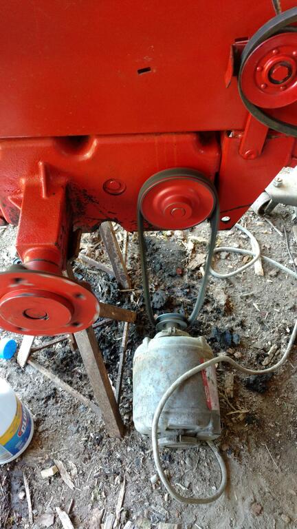

gt14rider 969 #11 Posted March 1, 2021 You can put on jackstands, put in some kerosene and run a belt to small electric motor, run in all gears , flush, repeat, lift and drain. I ran some cheap oil, drained and fill with your favorite gear oil 3 2 Share this post Link to post Share on other sites
peter lena 9,555 #12 Posted March 1, 2021 gt14rider,like your simple / easy set up, agree with cheap oil reflush to clean things out . one you are satisfied with the result , it will be easy to maintain it , pete Share this post Link to post Share on other sites

Jhook 849 #16 Posted March 2, 2021 My shift boot was bad causing water to enter the trans, i drained the chocolate milk that was in it, filled it with diesel fuel, and let it run in high gear on jack stands for 10 minutes then drained again. Repeated til it was clean enough for me. 1 Share this post Link to post Share on other sites
