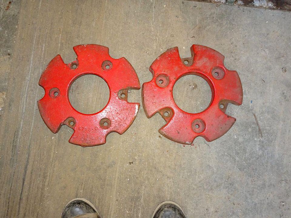

WheelhorseBob 1,550 #1 Posted February 28, 2021 Question for those who might know. Will farmall 12” front wheel weights fit on the rear 12” rim of a garden tractor? Curious as I found a set. thanks, Bob. 2 Share this post Link to post Share on other sites

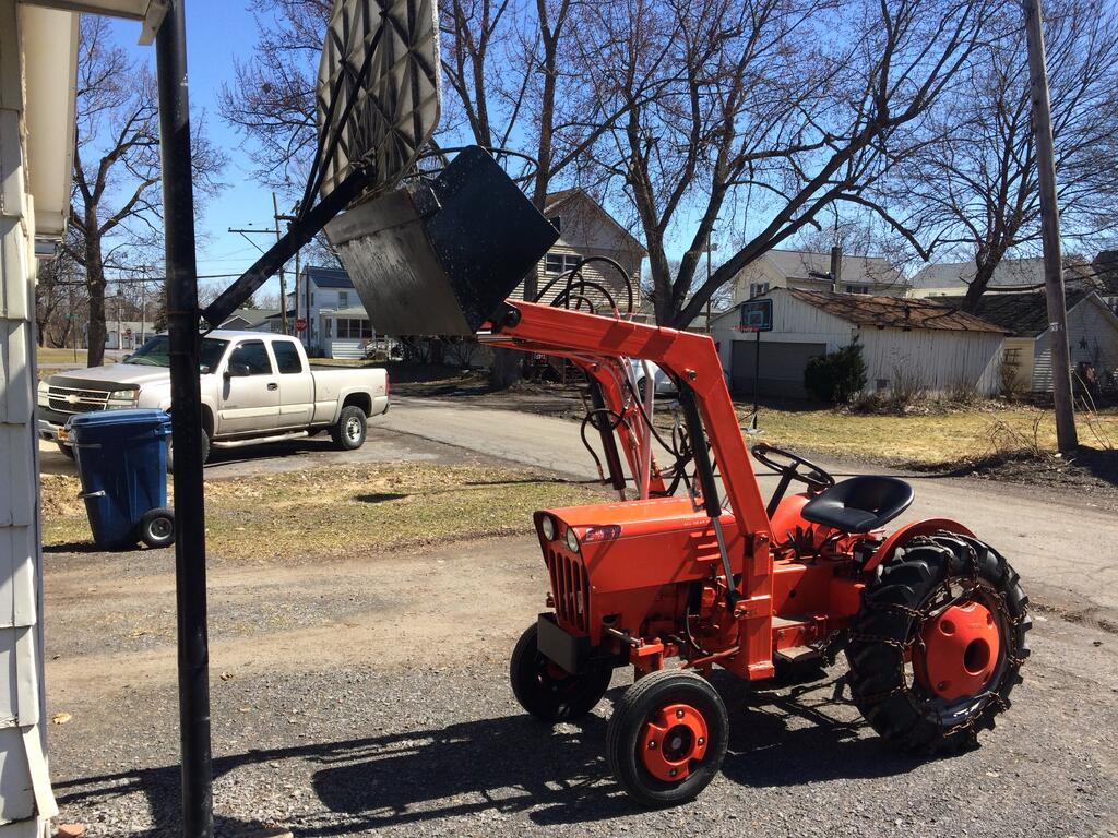

squonk 42,554 #3 Posted February 28, 2021 (edited) 21 minutes ago, WheelhorseBob said: Question for those who might know. Will farmall 12” front wheel weights fit on the rear 12” rim of a garden tractor? Curious as I found a set. thanks, Bob. Pretty sure they are the same as used on Cub Cadet and yes they will work on the inside of the rear wheel. These are CC /Farmall weights on my Power King Edited February 28, 2021 by squonk 2 3 Share this post Link to post Share on other sites

WheelhorseBob 1,550 #6 Posted February 28, 2021 Thanks for the replies!! these are what I’m looking at. 1 Share this post Link to post Share on other sites
WVHillbilly520H 10,376 #7 Posted February 28, 2021 10 minutes ago, WheelhorseBob said: Thanks for the replies!! these are what I’m looking at. I'm not sure what those are but not the more common IH Cub/Cub Cadet weights in pictured above with 4 bolt holes, those having 3 bolt holes are not going to work on our 12" WH wheels. Share this post Link to post Share on other sites
Lee1977 7,037 #8 Posted February 28, 2021 Check the to see if they will match up with just two holes. 3 Share this post Link to post Share on other sites
JAinVA 4,629 #9 Posted February 28, 2021 (edited) Those weights are off an IH Farmall H I know because I have a pair that I took off my H. They fit nicely inside the rim edge of a WH 12" wheel. Two bolts will work fine. Edited February 28, 2021 by JAinVA 3 1 1 Share this post Link to post Share on other sites
520HC 208 #10 Posted February 28, 2021 Yes those weights will fit a 12" wheel. 1 1 Share this post Link to post Share on other sites
Pullstart 64,573 #11 Posted February 28, 2021 They sure have a unique pattern, like a mag wheel! 3 Share this post Link to post Share on other sites
DennisThornton 4,771 #12 Posted March 1, 2021 Making my neck sore! Maybe 2 holes will line up... 2 Share this post Link to post Share on other sites
WheelhorseBob 1,550 #13 Posted March 1, 2021 thanks guys! I spoke to the gentleman who has them tonight. I’ll go get them this week. The parallel bolt holes are just right at 8.5”. Seems they are quite a bit heavier than regular cub fronts which is perfect. He guessed 60lbs. Or so. 5 Share this post Link to post Share on other sites
WheelhorseBob 1,550 #14 Posted March 4, 2021 (edited) Thanks to the members who said these would fit. They are are Farm-all 6678-D weighs that fit the front of a wide range of Farm-all’s. They also fit the rear of 12” garden tractor rims. About 40lbs each. Enjoyed my time with the elderly gent selling them more than the purchase but then for me that’s usually the case! Edited March 4, 2021 by WheelhorseBob 4 2 Share this post Link to post Share on other sites
