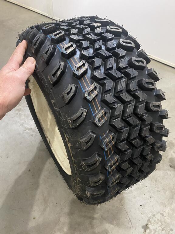

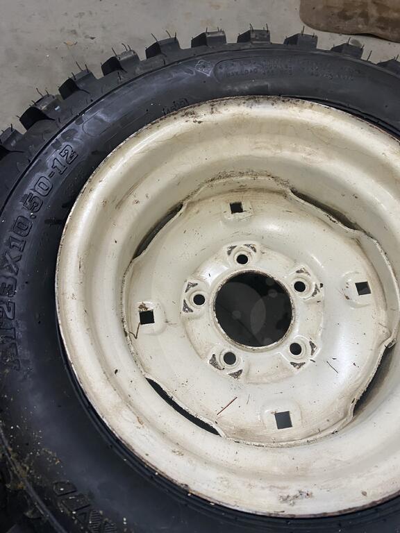

BeninCT 451 #1 Posted February 28, 2021 Bought a set of used tires that were really cracked so “had to” get a new set of tires to put on the rims for summer use. Figure I will just leave the chains on the other set and change them out when the snow is over. Less work than taking the chains on/off 2x a year. So, mounted the tires today and used tubes which meant that I cant do my usual shot of starting fluid and a lighter to set the beads. Now They are on and I inflated them with soap and one side of each wont fully set for some reason no matter how much air I put in. Even put a ratchet strap around one and inflated it again. Any suggestions on how I can seat the last 30% of the bead (just on one side- rims are the right size for the tire)... Thinking I will deflate and use a really soapy soap like dish soap with the strap extra tight. 2 Share this post Link to post Share on other sites

BeninCT 451 #4 Posted February 28, 2021 34 minutes ago, JoeM said: Antegos? If so they are a bear. super stiff sidewalls I had the same problem. Ended up using hand cleaner cream on the tire and bead area. I am thinking it took 60 psi also. Awesome tire and directional. tread. Ocelot P334 golf cart tire from amazon $63 ea. Needs more goo... 2 Share this post Link to post Share on other sites

BeninCT 451 #9 Posted March 2, 2021 Juiced em up with a special mix of hand cleaner (cherry smell- mistakenly purchased at Napa but will only take 4 years to use...) and meguiars tire shine. Little stretching from a large screwdriver and 50psi and pop 1 Share this post Link to post Share on other sites
