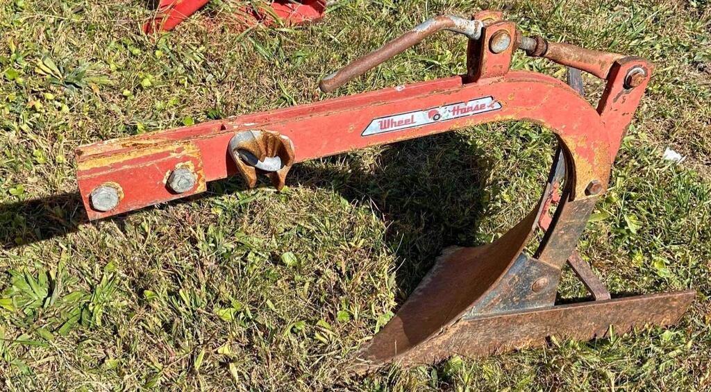

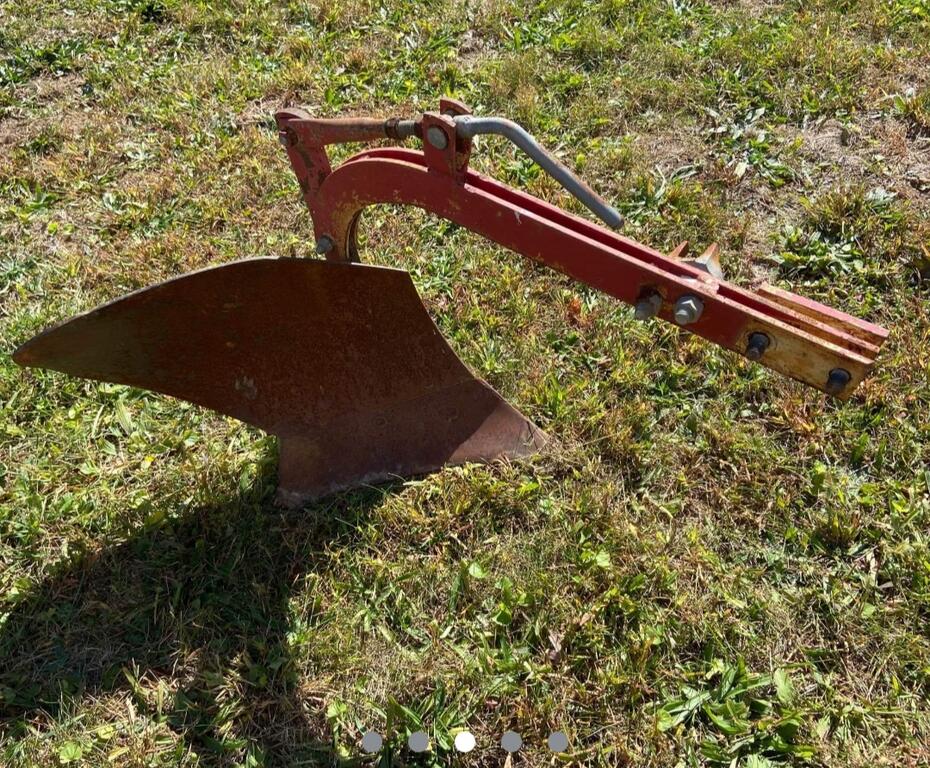

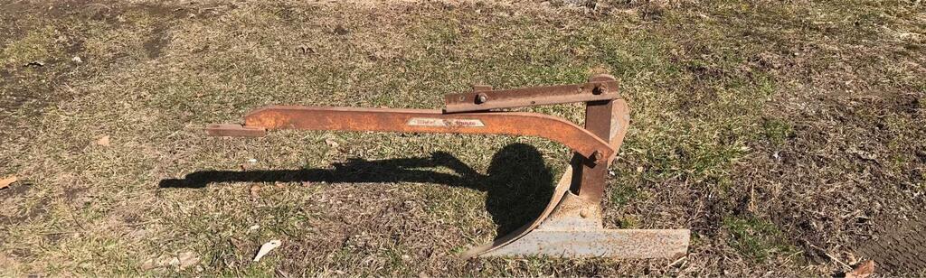

haydendavid380 759 #1 Posted February 27, 2021 Is this an actual factory plow? What's it missing and how hard are the missing items to find? Share this post Link to post Share on other sites
stevasaurus 22,994 #2 Posted February 27, 2021 Not missing anything you can't make. Coulters are easy to find. Share this post Link to post Share on other sites
WVHillbilly520H 10,376 #3 Posted February 27, 2021 2 hours ago, haydendavid380 said: Is this an actual factory plow? What's it missing and how hard are the missing items to find? That is a Brinly plow made for , and its missing the Coulter wheel that really isn't all that important, but the biggest thing missing and needed is the actual "clevis" or "tounge" hitch to attach to the tractor's clevis or slot hitch. You can still get factory replacement parts here... https://brinly.com/product/pp-51bh_sleeve_hitch_moldboard_plow/. 2 1 Share this post Link to post Share on other sites
Horse Newbie 7,184 #4 Posted February 28, 2021 2 hours ago, WVHillbilly520H said: That is a Brinly plow made for , and its missing the Coulter wheel that really isn't all that important, but the biggest thing missing and needed is the actual "clevis" or "tounge" hitch to attach to the tractor's clevis or slot hitch. You can still get factory replacement parts here... https://brinly.com/product/pp-51bh_sleeve_hitch_moldboard_plow/. What does the Coulter wheel do ? Share this post Link to post Share on other sites
haydendavid380 759 #5 Posted February 28, 2021 20 minutes ago, Horse Newbie said: What does the Coulter wheel do ? Cuts through the surface (grass, crop residue, ect) so that the plow just flops it over. Makes it easier to pull so the tractor doesn't have to rip all that with the plow. 1 1 Share this post Link to post Share on other sites

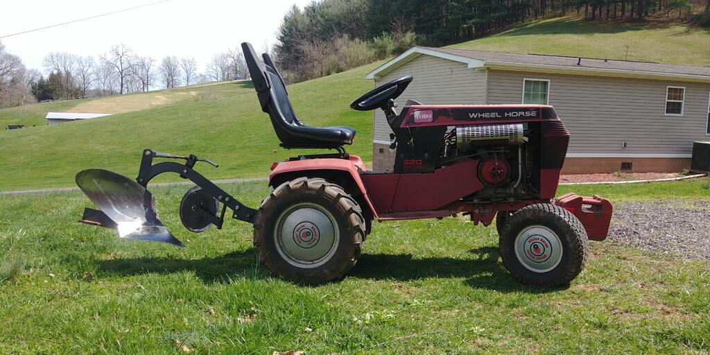

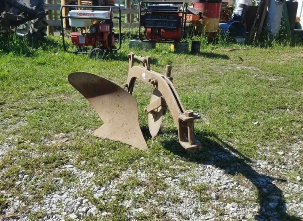

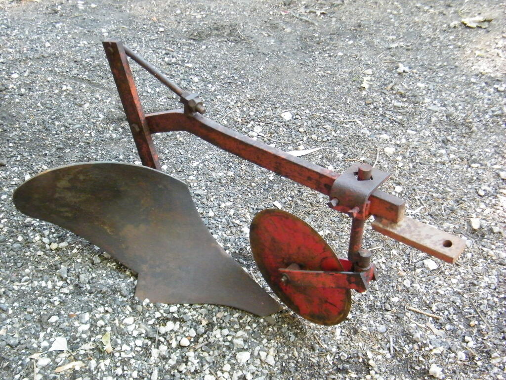

haydendavid380 759 #6 Posted February 28, 2021 (edited) I also just found this one which is quite a bit closer. The wheel horse branded one is $100 and 2 hours away. The one above (which appears to be complete) is $125 and 25 minutes away. Which would you guys go with? Also I apologize, I have zero experience with these little plows, but are they light enough for someone to be able to pick up by hand and put in a truck? Edited February 28, 2021 by haydendavid380 Share this post Link to post Share on other sites
c-series don 9,314 #7 Posted February 28, 2021 I’d go with the second one, it’s complete and ready to go. I would also wire wheel the moldboard and coulter wheel so it slides through the dirt easier. Share this post Link to post Share on other sites

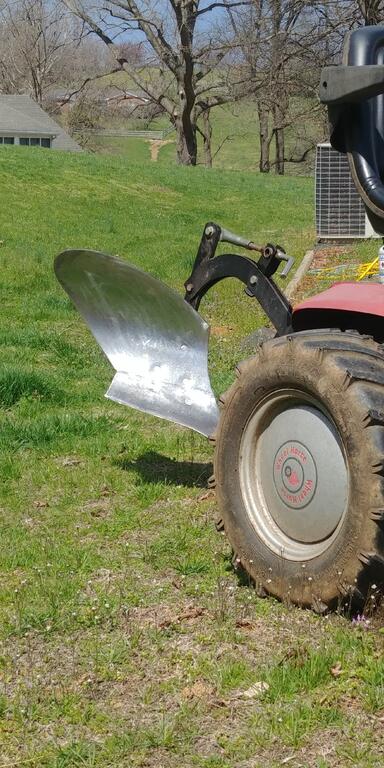

WVHillbilly520H 10,376 #8 Posted February 28, 2021 10 hours ago, haydendavid380 said: I also just found this one which is quite a bit closer. Also I apologize, I have zero experience with these little plows, but are they light enough for someone to be able to pick up by hand and put in a truck? Yes 1 person can lift it into a truck. And as @c-series don mentioned, it will need to be "shined" up... I used a fine grit "flap" wheel on a 4 1/2" grinder or your can try one of those 3M paint/rust strippers on a drill or die grinder.https://www.amazon.com/dp/B004NCH8QU/ref=cm_sw_r_cp_apa_fabc_7YAMM0M8Z65G4QRM4V6R 1 Share this post Link to post Share on other sites

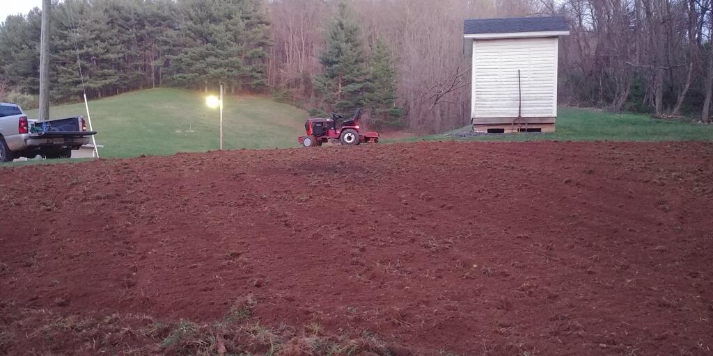

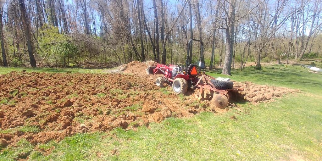

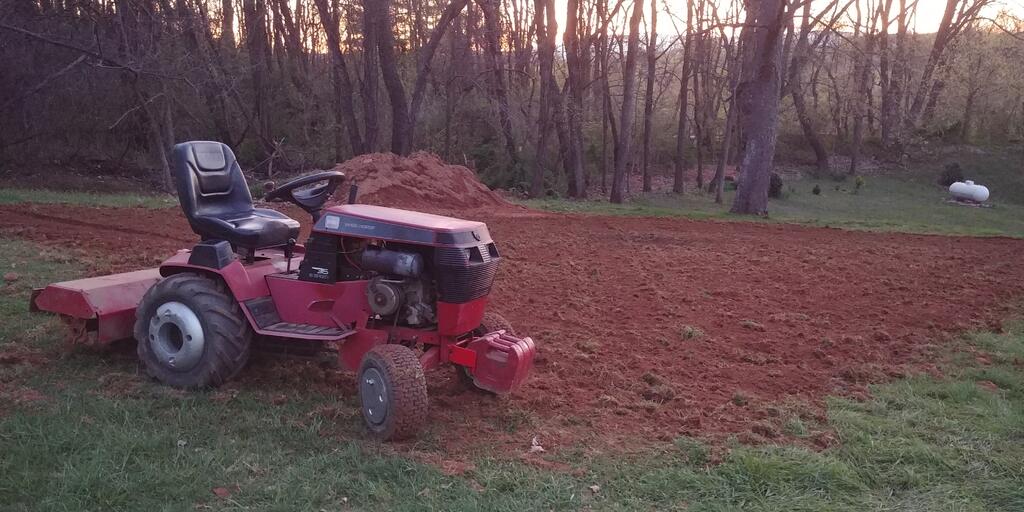

WVHillbilly520H 10,376 #10 Posted February 28, 2021 5 hours ago, haydendavid380 said: Now to find a disc harrow and a spare set of wheels to put ags on Tire chains on Turfs will work as well for gardening my dad did that way for many years, weight is your friend here, as far as the disc harrows again lots of weight will be needed to cut fresh turned sod. Even my eMax with a 3pt set of disc didn't cut it very well, cultivators or tiller is a better option IMO. 20200404_125657.mp4 1 Share this post Link to post Share on other sites

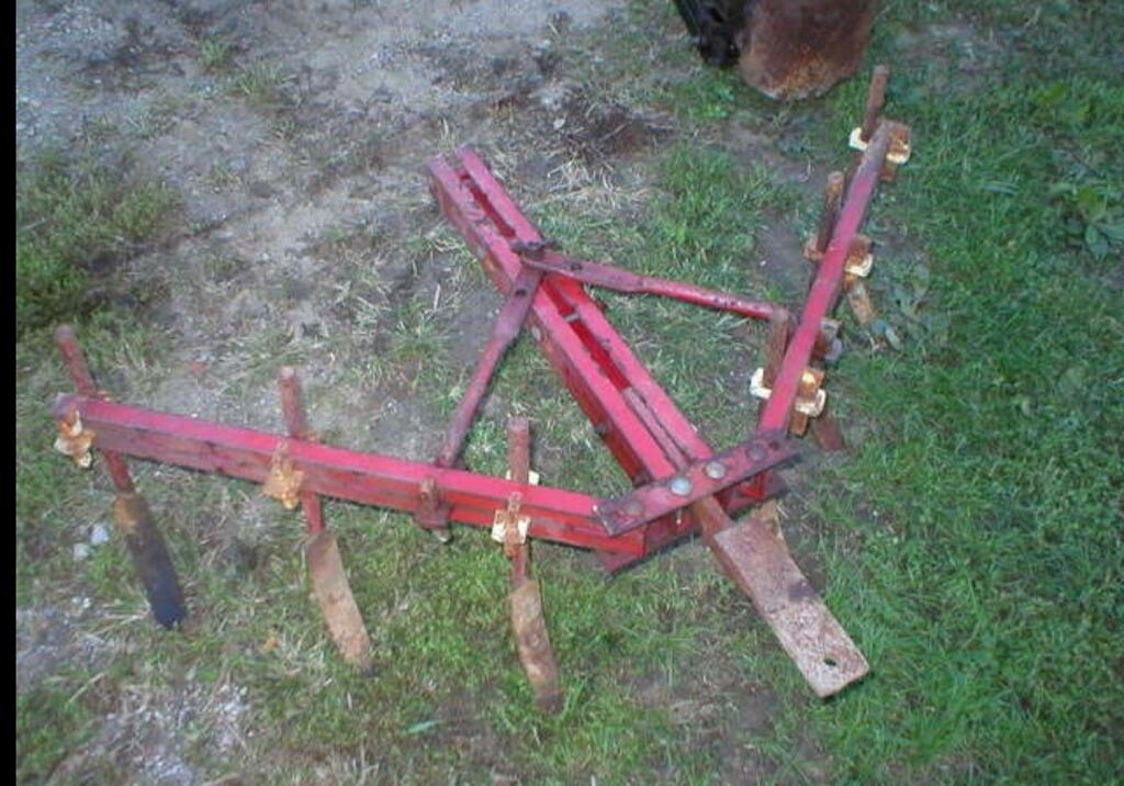

haydendavid380 759 #11 Posted February 28, 2021 17 minutes ago, WVHillbilly520H said: Tire chains on Turfs will work as well for gardening my dad did that way for many years, weight is your friend here, as far as the disc harrows again lots of weight will be needed to cut fresh turned sod. Even my eMax with a 3pt set of disc didn't cut it very well, cultivators or tiller is a better option IMO. 20200404_125657.mp4 I already have a cultivator, so that's good to hear. The one I have is similar to this except half the chisels are field cultivator sweeps I'm just looking for something to flatten out the furrows from the plow Share this post Link to post Share on other sites
WVHillbilly520H 10,376 #12 Posted February 28, 2021 42 minutes ago, haydendavid380 said: I already have a cultivator, so that's good to hear. The one I have is similar to this except half the chisels are field cultivator sweeps I'm just looking for something to flatten out the furrows from the plow As you could see in my little video, that was plowed over by a 10" Brinly on my 520H, but even the eMax was struggling in 4x4 going over the furrows after setting for a week. But I have clay based soil. If you have sandy loam you may have better results. Share this post Link to post Share on other sites

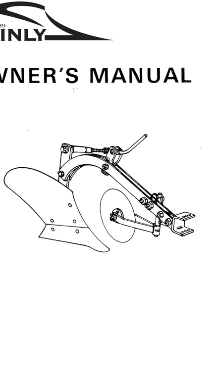

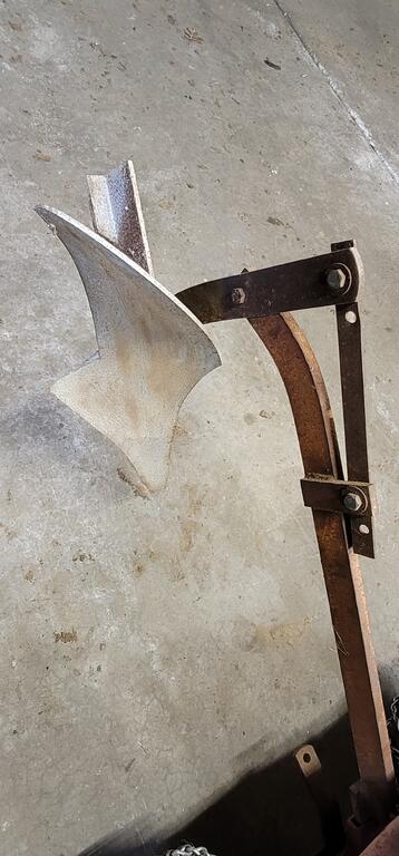

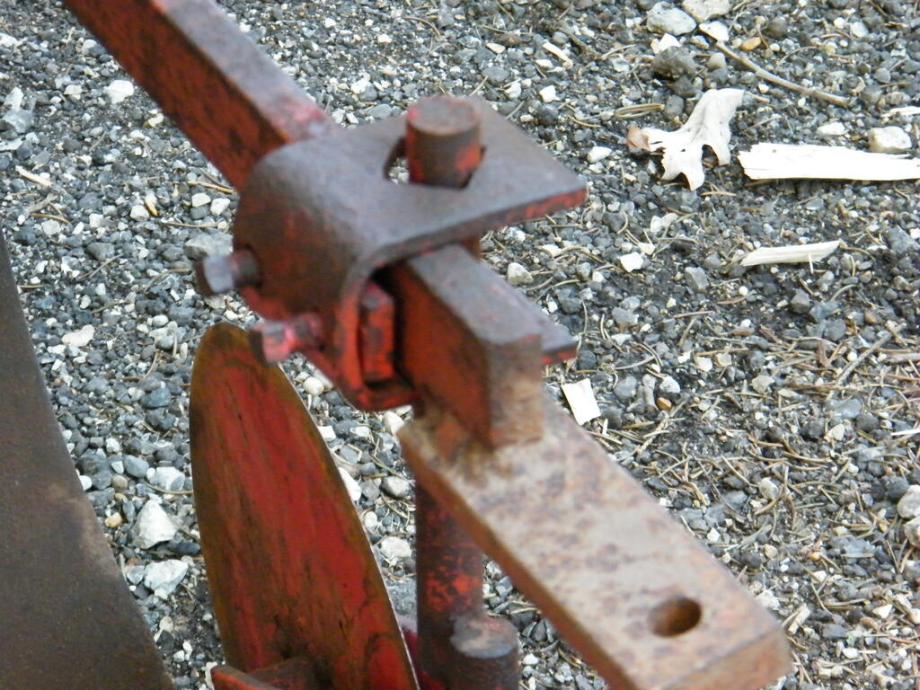

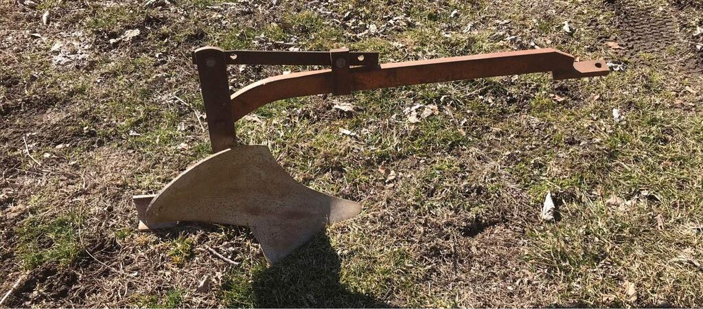

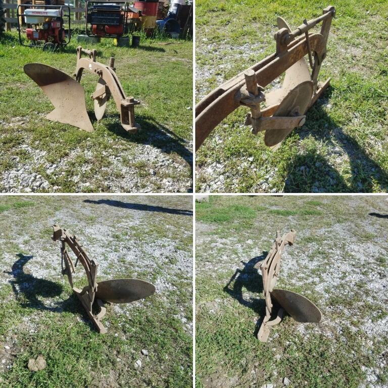

haydendavid380 759 #14 Posted March 7, 2021 (edited) Plow time is back on the table! Found this one for a good price. A couple hour drive. Looks to be a bit older, but I'd assume it should work fine. I'm supposed to go pick it up Saturday morning. Off to go pickup some flap discs. Kind of glad to find an older one with a mount for a slot hitch. My cultivator is the same, and I would have had to run an adapter for anything that needed a sleeve. Only question I have with this one is about the top bar. Is that what this one should have or should it have some kind of angle adjustment? If it is supposed to be fixed, is that a problem? Edited March 8, 2021 by haydendavid380 Share this post Link to post Share on other sites

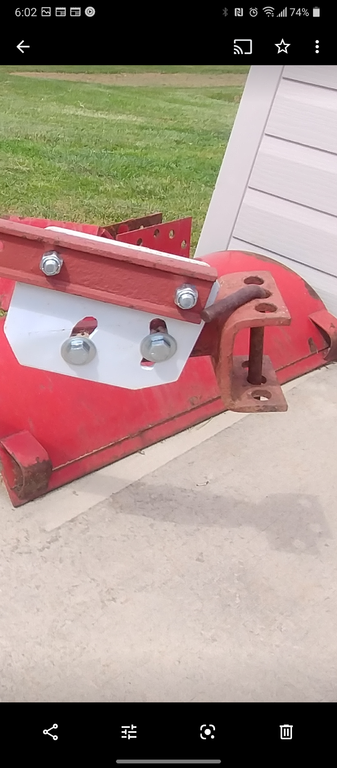

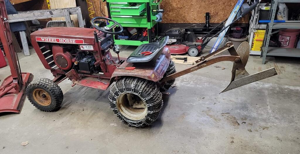

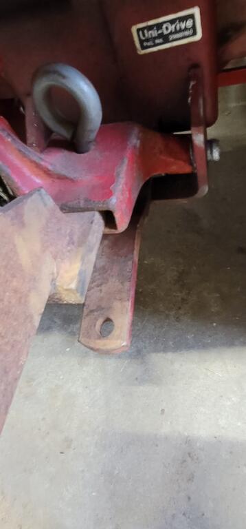

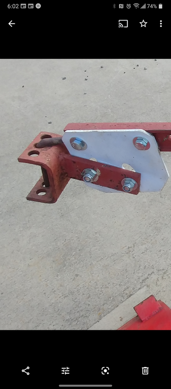

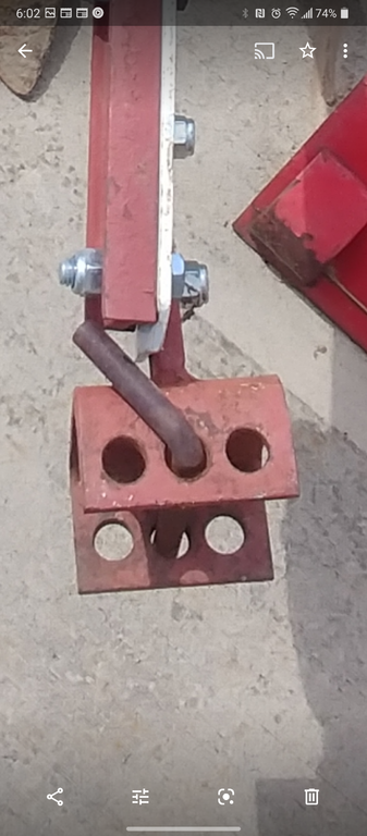

haydendavid380 759 #15 Posted March 14, 2021 Well I got it picked up yesterday. The plow face is surprisingly rust free and smooth. It looks like the PO sprayed a coat of silver paint on it before putting it away. Is it normal to have large gaps on either side of the hitch insert so it flops back and forth? Share this post Link to post Share on other sites
WVHillbilly520H 10,376 #16 Posted March 14, 2021 (edited) 4 hours ago, haydendavid380 said: Well I got it picked up yesterday. The plow face is surprisingly rust free and smooth. It looks like the PO sprayed a coat of silver paint on it before putting it away. Is it normal to have large gaps on either side of the hitch insert so it flops back and forth? I would think yes, (I gave no physical experiences with the slot hitch) but with the clevis or "Brinly" hitch the manual says NOT to tighten the adjustment bolts against the clevis, and I don't, I believe it allows the plow to follow the flow of ground and any obstacles that may lay under and thus hopefully not break something... @WHX24 @PeacemakerJack what you "plow dogs" say? BTW I said I would get the dimensions for the cultivator "braces" but between a 16yo son and an 83yo father I got side tracked while there yesterday, best guess would be no thinner than 1/4" x 1" flat iron approximately 18" long from the pics I supplied in your other thread bolt through the center section and had a bar welded to the other and using the clamps/wedges like the plow shanks. Edited March 14, 2021 by WVHillbilly520H 1 Share this post Link to post Share on other sites
