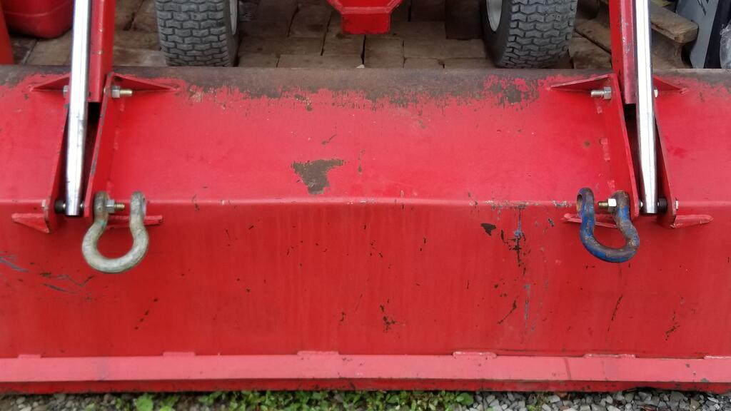

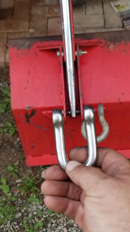

Wheel Horse 3D 3,814 #126 Posted June 30, 2021 Well on that note, i finished upgrading the pivots(still need a few more washers), and added some temp shackles, ill be looking for ones that fit properly, that i can attach these type, or carabiners to. 2 Share this post Link to post Share on other sites
Wheel Horse 3D 3,814 #127 Posted July 2, 2021 (edited) As it appears shackles as wide as I want are quite expensive...it will be more cost effective for me to rebuild the forge at the new house and forge me some custom ones. I have a new collection fire brick and chimney block and tile just for that purpose. Edited July 2, 2021 by Wheel Horse 3D 2 Share this post Link to post Share on other sites

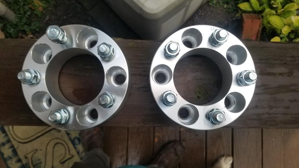

Wheel Horse 3D 3,814 #131 Posted August 3, 2021 4x4 hubs and Tuner lug nuts arrived, wheel spacers should arrive any day now. Tryin to get the big boat done and outta the way so I can dive into the wheel work and lifting the seatpan. 1 Share this post Link to post Share on other sites
Wheel Horse 3D 3,814 #132 Posted August 5, 2021 Spacers have arrived! 2 Share this post Link to post Share on other sites

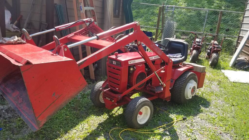

ebinmaine 70,783 #138 Posted May 25, 2022 20 minutes ago, Wheel Horse 3D said: 600lbs 5 minutes ago, Dan.gerous said: large You'd need a fair pile of counterweight for sure. Gonna have an FEL? Share this post Link to post Share on other sites
Wheel Horse 3D 3,814 #139 Posted May 25, 2022 55 minutes ago, ebinmaine said: You'd need a fair pile of counterweight for sure. Gonna have an FEL? Already on Dug 1 Share this post Link to post Share on other sites

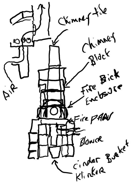

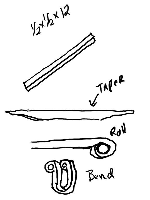

8ntruck 7,390 #141 Posted May 27, 2022 Neat diagram for a forge. Coal burner? Share this post Link to post Share on other sites
Wheel Horse 3D 3,814 #142 Posted May 27, 2022 (edited) 1 hour ago, 8ntruck said: Neat diagram for a forge. Coal burner? Coal, wood, or charcoal. Could even drop a propane or gas insert if ya wanted, also could have an oven area opposite side the forge for bread pizza etc. Maybe a flat griddle arwa to the front for outdoor cooking. Edited May 27, 2022 by Wheel Horse 3D Share this post Link to post Share on other sites

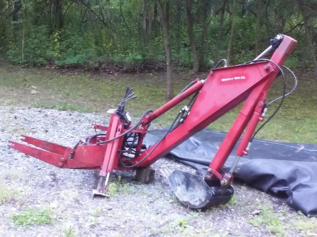

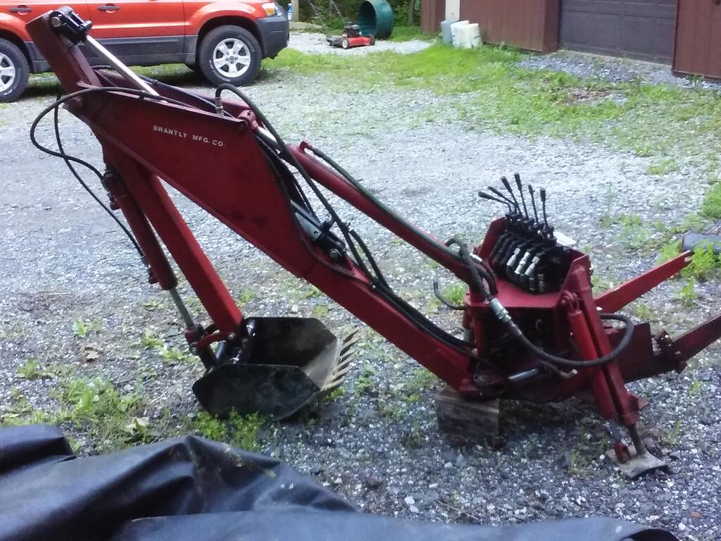

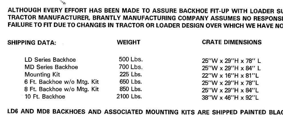

Wheel Horse 3D 3,814 #143 Posted May 27, 2022 (edited) K a little more weight comparison research.. The Brantly LD6 weighs about 725 lbs with its mounting kit. The smaller kubota weighs right around 600. Plus maybe 100 lbs of custom mounting etc. To the tranny and existing subframe. Then a weldin buddy figures it would be pretty easy to shave 100 lbs or so off the kubota. So weight wise would actually be very comparable to the brantly. Balance wise Figure tractor is abt 600lbs plus 300 lbs for the endloader and frame, so 900 lbs the majority of which is fwd of the rear axle.. Thinking this is looking decent as an option! Edited May 27, 2022 by Wheel Horse 3D Share this post Link to post Share on other sites

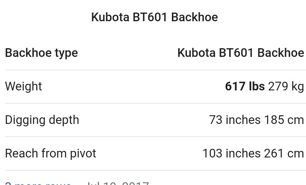

Wheel Horse 3D 3,814 #144 Posted May 27, 2022 (edited) Some relatively current backhoe models that fall into that weight range bracket: JD 260b Kubota bt601( bt600? Getting different weight results for the 600) Kubota bh6000 Woods BT6000 Pretty much any kubota for the BX23 series Also remember operating weight includes an operator, shipping weight doesn't There are some other brands and models like LS and their manufacturers that fit that category, but looks like something rated for the 15-25 hp range is about the right weight. With so many of the kubotas out there though thats likely ones best bet to find one. Most im seeing are running around 5k in full working order. Going after work today to see if i can find the owner of one that needs repair. Would be great to see more Horses with backhoes, maybe these are some options especially if the can be found for a deal or needing repair Edited May 27, 2022 by Wheel Horse 3D 1 Share this post Link to post Share on other sites

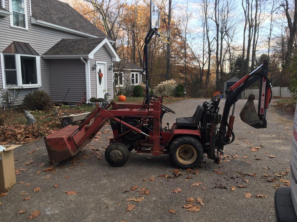

Wheel Horse 3D 3,814 #145 Posted May 27, 2022 (edited) And a Mr Jay @roadapples reminder from earlier on this thread of the LD6 and how it looks on a c-series.....awesome! Edited May 27, 2022 by Wheel Horse 3D 2 2 1 Share this post Link to post Share on other sites

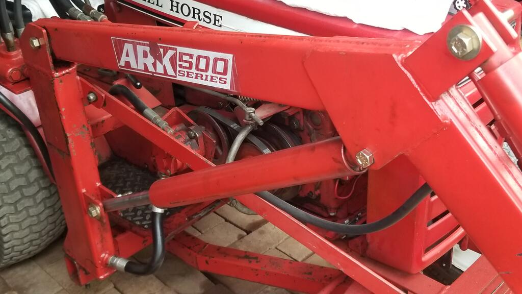

c-series don 9,444 #146 Posted May 28, 2022 I’d love to see pictures of how that attaches to the tractor! Share this post Link to post Share on other sites

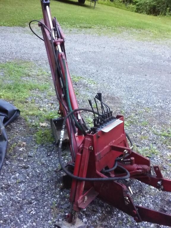

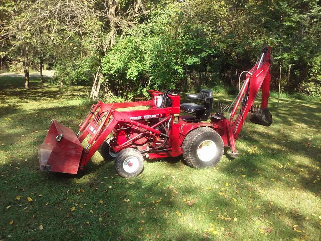

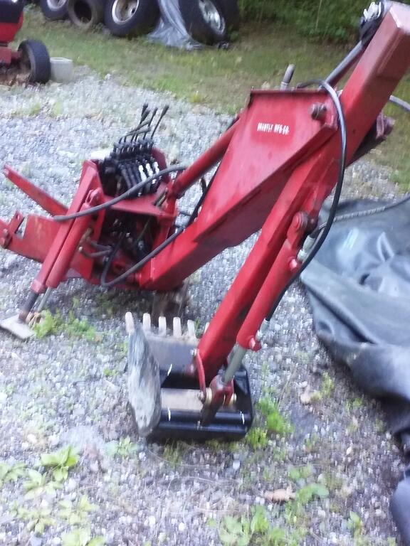

Wheel Horse 3D 3,814 #147 Posted May 28, 2022 On 2/26/2021 at 7:32 PM, roadapples said: Mine attaches a little different than John's. Those front legs attach at the mid attachamatic. They had to be shortened. Made for D250. They run along side the base frame for the loader and pieces were added to fasten to the rear axle housing. Also from earlier in this thread.. 1 1 Share this post Link to post Share on other sites
Wheel Horse 3D 3,814 #148 Posted May 28, 2022 Also earlier in the thread @wallfish has multiple posts of the pf engineering backhoe he built! 3 1 Share this post Link to post Share on other sites
