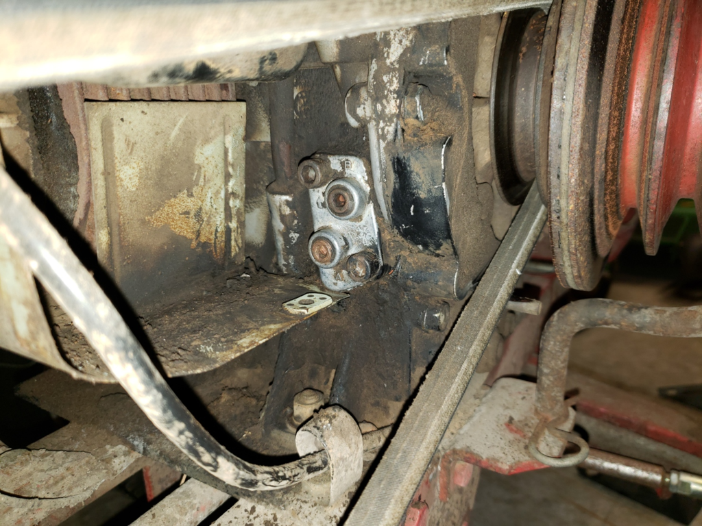

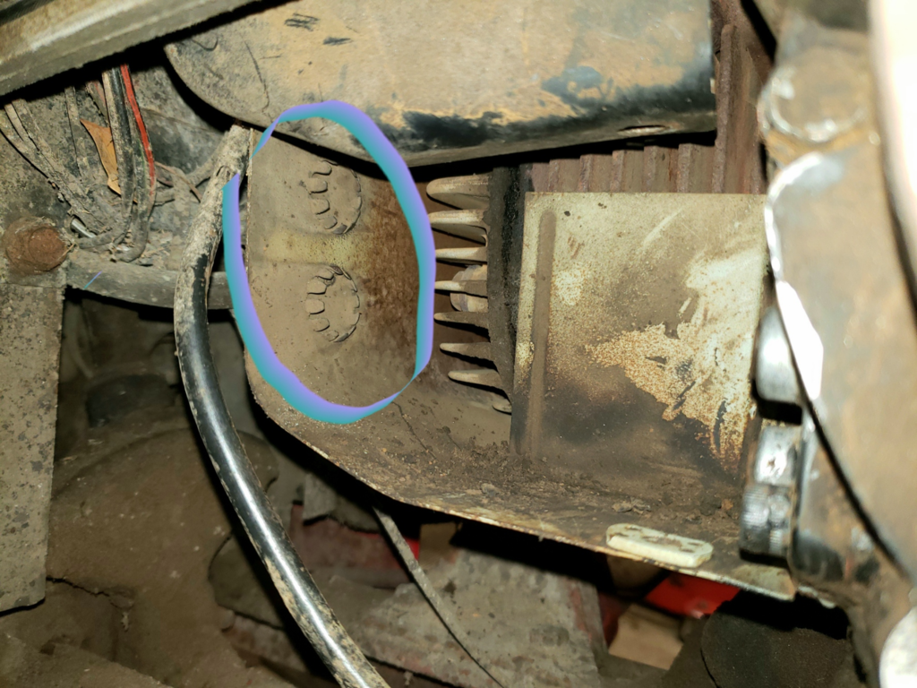

417Horse 40 #1 Posted February 15, 2021 I had a previous post on adding a remote oil filter to my KT17 engine. It already has the plugged off 2 port adapter plate (see pic) as well as the access holes (circled in pic) to route the oil lines thru. My only question at this point involves the hoses that would be attached between the adapter plate and the remote oil filter plate. I might be thinking too much into this, but is there some type of rating for the oil hoses that I should adhere to? 1 Share this post Link to post Share on other sites
