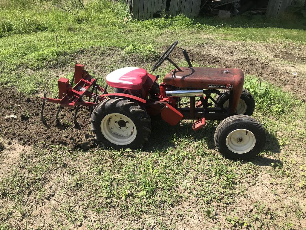

Achto 28,777 #2 Posted February 15, 2021 I have pulled a disc behind a . A double gang does a better job than a single gang. The disadvantage to a double gang is you can not pick it up to turn around at the end of the row. I have a cultivator. It does a great job, but if there is an abundance of trash (old sod, leaves, etc.) on the soil it is prone to plugging up. 1 Share this post Link to post Share on other sites

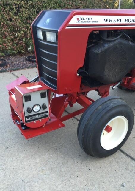

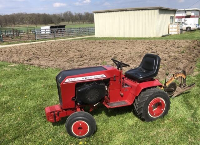

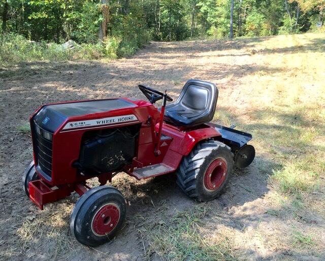

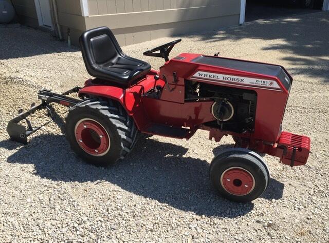

cschannuth 3,817 #4 Posted February 15, 2021 The C-161 is my ground engagement machine but they all get in on different chores. 7 Share this post Link to post Share on other sites

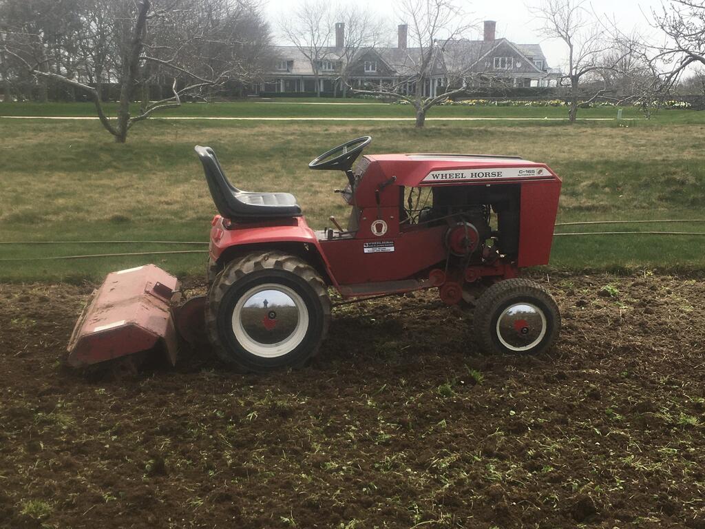

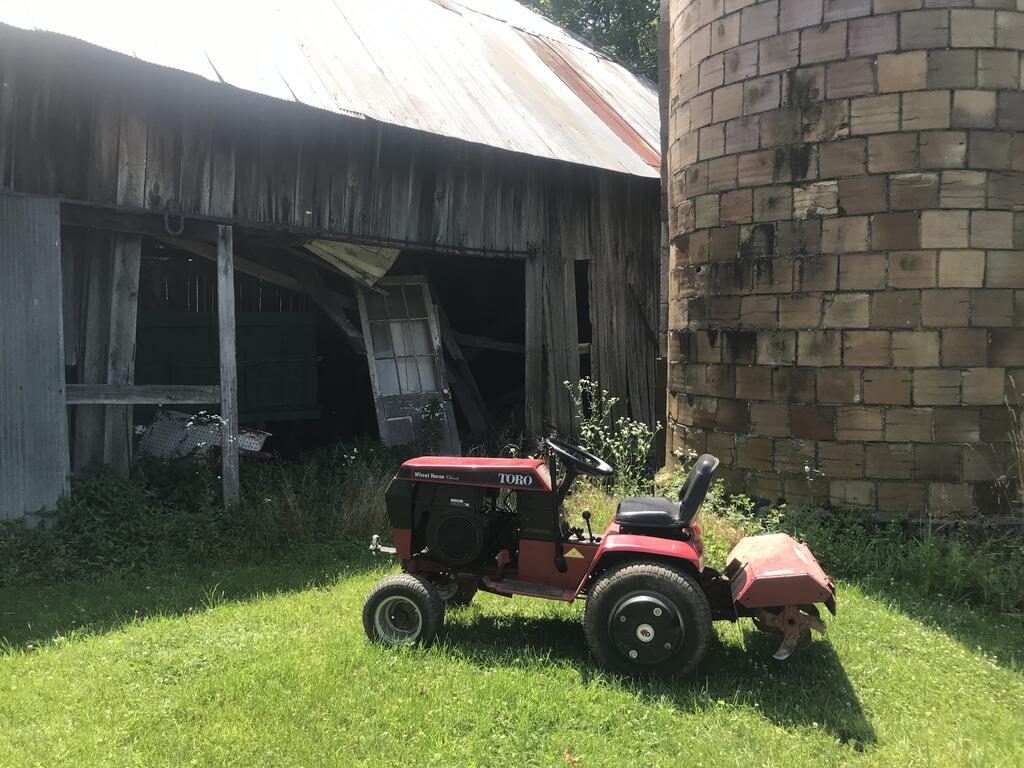

c-series don 9,425 #5 Posted February 15, 2021 Here’s my C-165 automatic with 36” tiller, works like a charm. However as I’ve said here before, I think the best setup would be an 8-speed tractor with electric lift. 3 Share this post Link to post Share on other sites
haydendavid380 759 #6 Posted February 15, 2021 1 hour ago, Achto said: I have pulled a disc behind a . A double gang does a better job than a single gang. The disadvantage to a double gang is you can not pick it up to turn around at the end of the row. I have a cultivator. It does a great job, but if there is an abundance of trash (old sod, leaves, etc.) on the soil it is prone to plugging up. So the cultivator should be good in a clean garden area that is typically tilled with a walk behind? Just trying to bust up the surface 2 Share this post Link to post Share on other sites

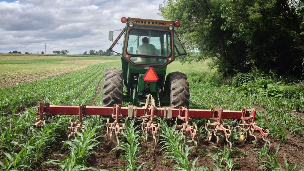

Achto 28,777 #7 Posted February 15, 2021 1 hour ago, haydendavid380 said: So the cultivator should be good in a clean garden area that is typically tilled with a walk behind? Correct. The cultivator is typically used to keep the weeds down in between the rows of plants. Cultivating corn in the farming industry used to be a very common practice before herbicides took it's place. Now cultivating is typically only done to inject urea into the ground. 5 Share this post Link to post Share on other sites

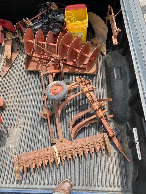

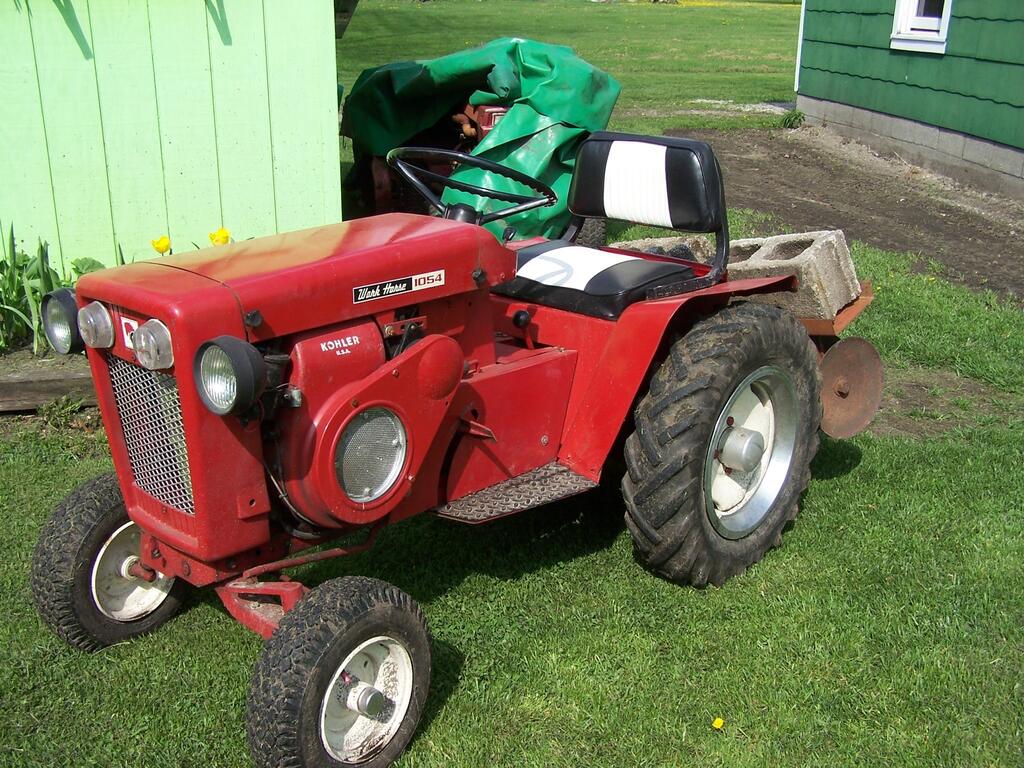

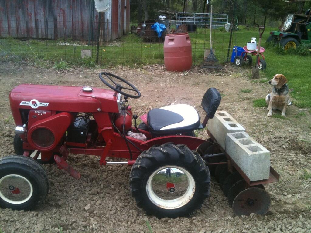

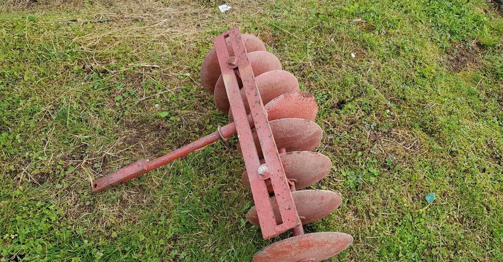

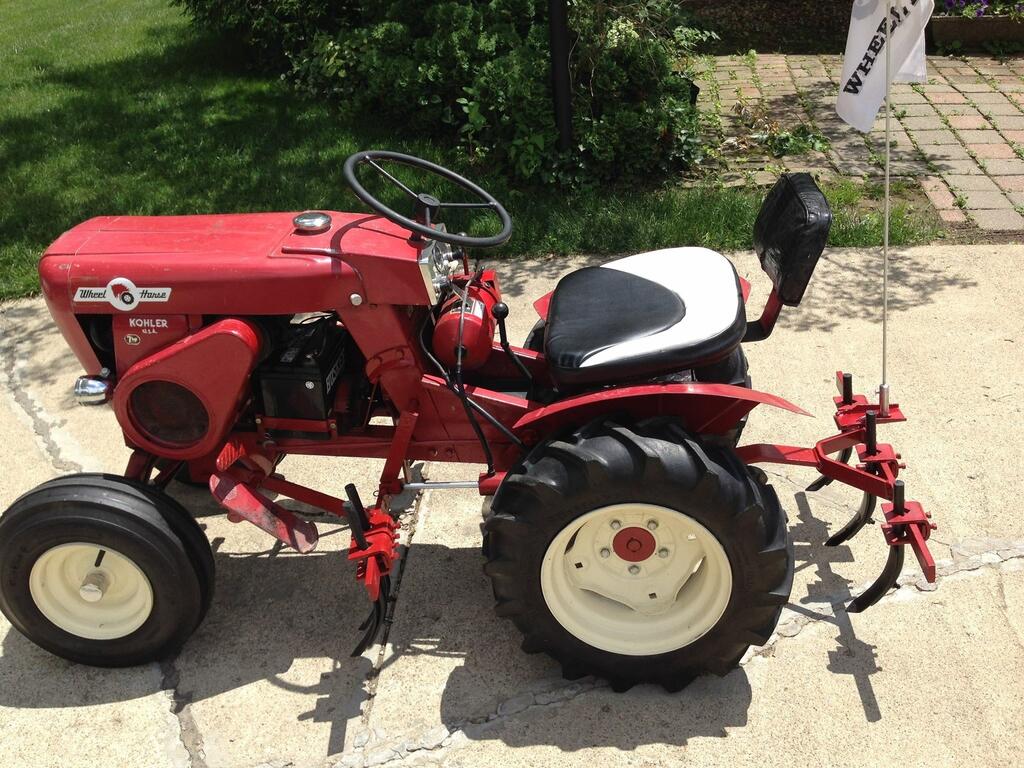

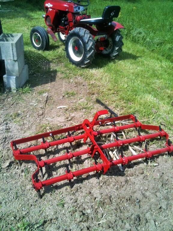

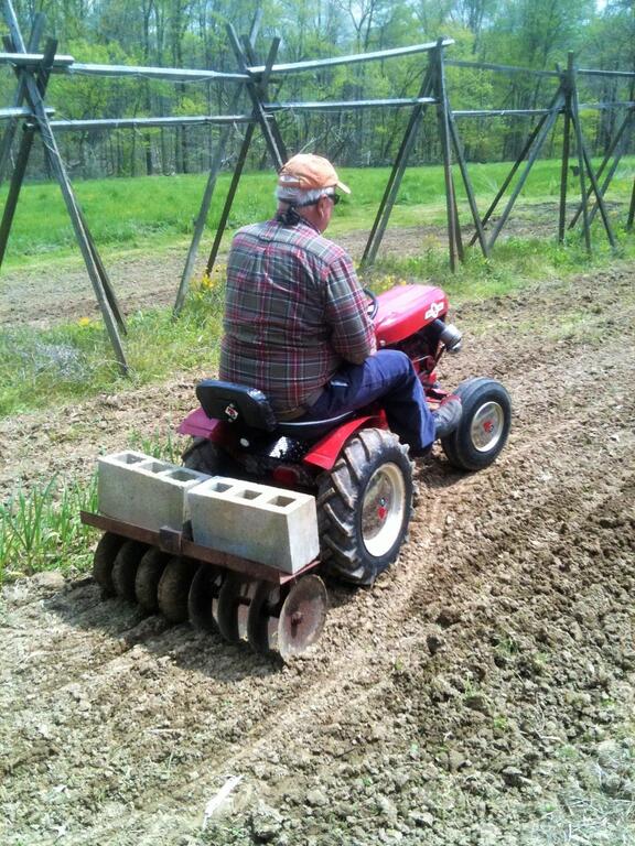

Lane Ranger 11,125 #8 Posted February 15, 2021 The Horse ag implements I have used include, garden plows (8 inch and 12 inch ), 18 point drag harrow , 9 point cultivator and a wheel horse two pice mid and rear cultivator set, disc, and tiller. I have had the implements on RJ’s , round hoods, B-80s , 1054s and a 36 inch tiller on aC-121 and 314-8 tractor. The plowing of new soil works best with the bigger 1054 and 12 inch garden plow that was made for that model and other bigger tractors . The weight of this bigger plow helps it pull well and cut thrust the soil cleanly. The 8 inch plows for RJs and round hoods are a little different but work well on soil already broken or plowed before. A round hood with 7 or 8 hp has enough power to pull plow thru previously unplowed soil but it can be a little tough when more clay in soil. I have used the single disc (not the double like Achto discussed above). But they need many passes and I would use two concrete blocks for weight all the time. The 18 point drag harrow I owned was bought to use on a very clay type garden soil. I completely redid every part. We had one as kids but I bought one at 63 years old. Sold after two years as it would not really break up clay . I used concrete blocks on top and pulled with my 701 Round hood. I sold to a lady that used in her horse arena and she loved for dragging manure and straw! Th cultivators vary in type and application. I have a two piece mid and rear tiller set no I have used several times in a large garden . I will say it is not really a good cultivation system. I still own to put on a tractor for shows but not used in gardens. My favorite cultivator is Wheel Horse Brinly early Brinly type with nine tines. I used thee different sized points (Danish tines and WH long points) . I have three 10 pound weights I can place on this cultivator. I can clean out seven 60 foot rows in a garden in 5 to 20 minutes with this cultivator. Now for last five years I have used the Wheel Horse 36 inch tillers to till up my gardens. I used a c-121 and a 314-8 with two different tillers. They both worked the same Nd did an excellent job. When ground cover is on the garden the tiller make need a couple passes but the weeds and grass will dry up. so that’s about all the perspective I can give for the ag attachments like Jim suggested I do. Here are some pics. I did last year acquire a pretty complete set of early RJ attachments (but I had as a kid 55 years ago and used before). My brother David and I in pics 50 years apart! 1 9 5 Share this post Link to post Share on other sites

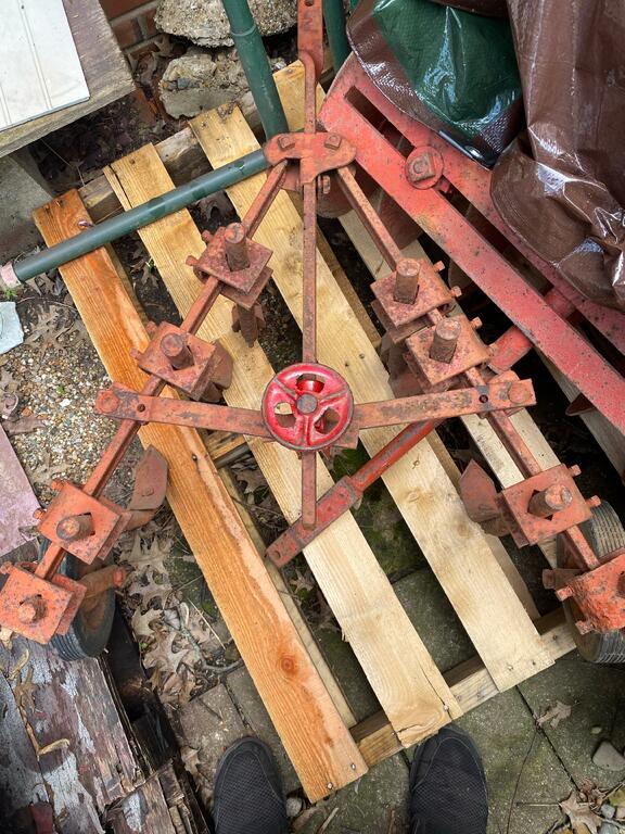

Lane Ranger 11,125 #11 Posted February 16, 2021 (edited) No spiked tooth harrow is not rare it was made by a supplier to Wheel Horse in Cleveland. Several other tractor companies had this harrow in their lineup of attachments. Wheel Horse had this available until late 1960s from research I did. The manual is in the ground engaging implements section on Red Square. Another spiked tooth version was made until 1980. Edited February 16, 2021 by Lane Ranger 1 Share this post Link to post Share on other sites

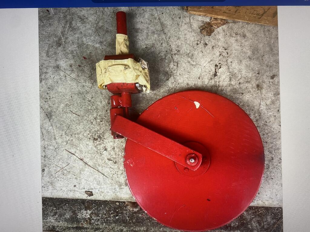

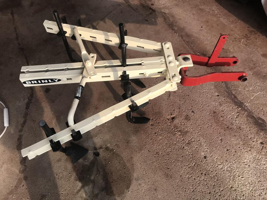

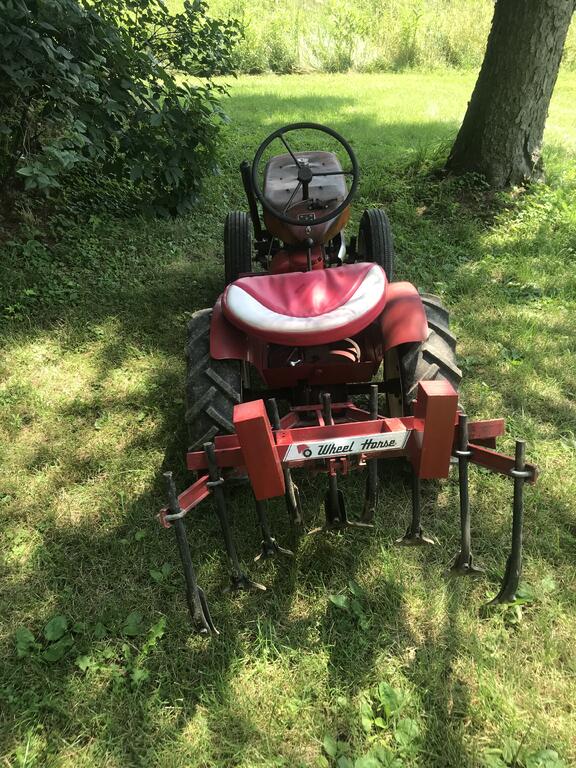

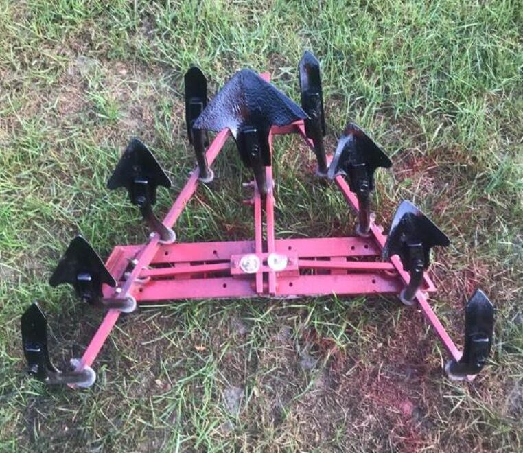

haydendavid380 759 #12 Posted February 16, 2021 (edited) The one I have is this style. I picked it up for $50 late last year Edited March 15, 2021 by haydendavid380 1 Share this post Link to post Share on other sites
