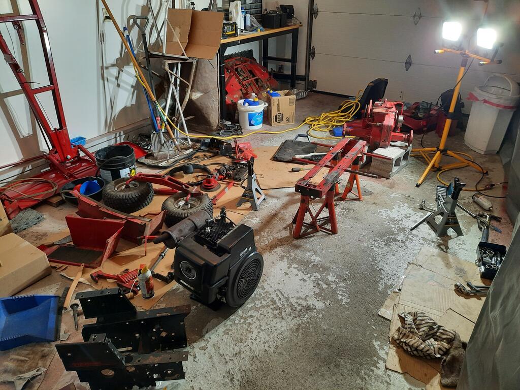

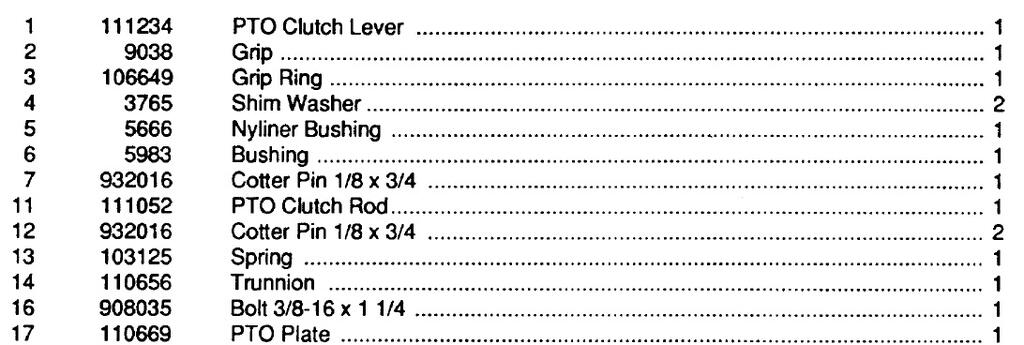

David414 289 #1 Posted February 7, 2021 I have a complete tear down of a new to me 312-h and I am wondering, has anyone ever completely removed the PTO clutch lever from the hood stand? The parts diagram shows that the lever is two pieces? Is this a factory weld after insertion through the hood stand? Currently, the PTO lever is still attached to the hood stand. Is it possible to remove? Thanks, David Share this post Link to post Share on other sites
gwest_ca-(File Mod) 11,243 #2 Posted February 7, 2021 One may need to remove the grip and move the lever through the hole. Bushing 5 may be split to make room so the bend will pass through. Never had one apart. 2 Share this post Link to post Share on other sites
Blackhood Bill 721 #3 Posted February 7, 2021 Remove number 7, then remove 4 & 6 it comes right out easy peezy. 1 Share this post Link to post Share on other sites
oliver2-44 10,367 #4 Posted February 8, 2021 While your refurbishing it, consider replacing item 6 nylon bushing with a brass bushing. you can find one to fit from all those gray drawers at your ace or similar hardware store. Share this post Link to post Share on other sites
David414 289 #5 Posted February 8, 2021 16 hours ago, gwest_ca said: One may need to remove the grip and move the lever through the hole. Bushing 5 may be split to make room so the bend will pass through. Never had one apart. 16 hours ago, gwest_ca said: One may need to remove the grip and move the lever through the hole. Bushing 5 may be split to make room so the bend will pass through. Never had one apart. @Blackhood Bill Removed the grip and #3 grip ring, and slid handle through hole in hood stand. Piece of cake once you know what you're doing! Thanks for the help. @oliver2-44 I was thinking the same about the bushing. 👍 Share this post Link to post Share on other sites
