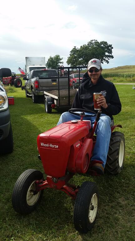

WHX?? 49,979 #14 Posted February 9, 2021 (edited) 2 hours ago, Mike in NC said: Thank you all for your replys! I will try to go look at it soon or try to get him to send me some pictures of it. I will post back when I know for sure what it is. Thanks again!!! Please do ... everyone here likes to play ID that tractor. A 701, if that's what it is, is a favorite & bucket list tractor of many here. Hard to find tho. You start talking 701 scores around here yer gonna raise some eyebrows. One year at a show with our buddy @Achto he stumbled blind out house lucky on a very complete one for a lousy 200 bucks. Sure it needs some love but nothing we can't handle. We took one look at it our eyes bugged out realized what it was and I hollered SOLD! Was the first time in a long time we never even bothered to dicker on the price! Dan was a little short o cash so I loaned him abit with interest in the form of seat time! Him on it for his first time. Note the wide belt guard. We've seen that belt guard go for 200 clams alone. Edited February 9, 2021 by WHX24 speeling 1 3 Share this post Link to post Share on other sites

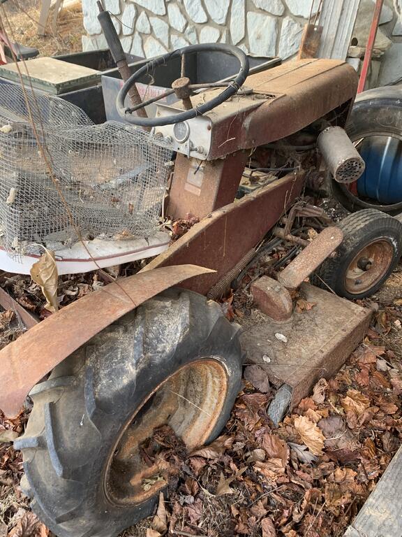

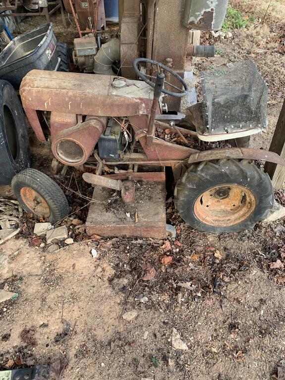

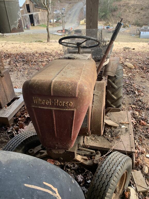

Mike in NC 342 #15 Posted February 10, 2021 I hope the pictures will post. Here are a few of the tractor in question. And it DOES look like it is a 701. And a different friend that has seen it says it has two belts on the starter/generator! 2 4 1 Share this post Link to post Share on other sites
rjg854 11,739 #16 Posted February 10, 2021 That appears to be a 701, but I'm no expert on the model. 2 Share this post Link to post Share on other sites
rmaynard 15,820 #17 Posted February 10, 2021 (edited) Definitely a...701 Edited February 10, 2021 by rmaynard 2 Share this post Link to post Share on other sites
stevasaurus 22,973 #18 Posted February 10, 2021 It's for sure...701. It also appears complete with an excellent patina. Rescue that old girl now!!! That is the correct mower deck also. Hard to tell, but the throttle cable is not correct...no big deal there. See what that top sticker says on the dash tower. That would be the serial # and (if there was one) a model #. 3 Share this post Link to post Share on other sites
Mike in NC 342 #19 Posted February 10, 2021 Thank you all!! He is asking $400 for it. I do not know what they are worth. 2 Share this post Link to post Share on other sites
WHX?? 49,979 #20 Posted February 10, 2021 (edited) 49 minutes ago, stevasaurus said: Rescue that old girl now!!! No question about the model. 49 minutes ago, stevasaurus said: with an excellent patina. I'd say better than excellent and very complete! The deck is certainly correct. For us original guys I'm thinking that is a $400.00 tractor all day. Truth be told Mike if it were an auction tractor I would be prepared to go to 800 on it. I hope nobody tries to do something stupid and resto it. The finish underneath the dust & bird poop would be to die for. Check out how strait the sheet metal is! Please keep us posted on what comes of it. 701 like that is a rare find. Edited February 10, 2021 by WHX24 2 1 1 Share this post Link to post Share on other sites
