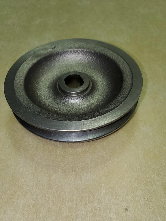

CB1993 34 #1 Posted February 6, 2021 Can anyone tell me if this chip is bad enough to cause any issues with my mower deck? Does anyone have a replacement pulley for sale? Thanks Share this post Link to post Share on other sites
ebinmaine 69,594 #2 Posted February 6, 2021 If you filed it to put a chamfer on the inside of the chip you might be able to get away with that for a bit... IIFF the belt running around it is at a straight shot with no angle to the pulley. 2 Share this post Link to post Share on other sites
peter lena 8,960 #3 Posted February 6, 2021 cb1993, I would not run that , typically deck pulleys have belt bounce related problems , while I agree with ebinmaine above on an attempted save , you have the time now, till spring to get a replacement. look on internet or related w/h parts sites , if you can pick up a couple of them , you will have a spare , pete 3 Share this post Link to post Share on other sites

SylvanLakeWH 26,496 #7 Posted February 6, 2021 For the cost of a pulley, I’d replace... shredded belt will cost as much or more in trouble... @pullstart’s option or a want add in the classifieds... 2 Share this post Link to post Share on other sites
pacer 3,174 #8 Posted February 6, 2021 Bit different experience here ..... I've run/used pulleys like that on several occasions with no problems --FWIW 1 Share this post Link to post Share on other sites
Ed Kennell 39,658 #9 Posted February 6, 2021 Know any good cast iron welders? Clamp a bar of brass in the groove and weld it up. Grind the OD and bottom side back to shape. What is the pulley number# ? I may also have one. 1 Share this post Link to post Share on other sites

DennisThornton 4,770 #11 Posted February 6, 2021 If I had to finish the lawn I'd do as Eric said and chamfer off the sharp edges OR I would heat it up and either braze or nickel rod arc it and then cool it slowly in ashes. Grind the belt side and forget it. Otherwise I'd chase down another pulley. Share this post Link to post Share on other sites
bc.gold 3,403 #12 Posted February 6, 2021 (edited) Silver solder. https://youtu.be/s7f9AhvDtHU Edited February 6, 2021 by bcgold Share this post Link to post Share on other sites
JoeM 7,883 #13 Posted February 6, 2021 Put the old belt on and run it.....nothing to loose! I have seen worse. (but if someone is giving you one) take it ! 1 Share this post Link to post Share on other sites
DennisThornton 4,770 #14 Posted February 6, 2021 9 minutes ago, bcgold said: Silver solder. https://youtu.be/s7f9AhvDtHU A bit of a rant first... I wish the world could get together on the terms Braze VS Solder. Surprised the Muggyweld isn't more clear. It's a pet peeve of mine because I spent many hours researching for a project and the terms misuse cost me time and money. The basic difference between soldering and brazing is the temperature necessary to melt the filler metal. ... If the filler metal melts below 840ºF the process being performed is soldering. Above that temperature, the process is brazing. Plumbing: TechCorner - Soldering and Brazing Explained www.copper.org › applications › soldering_brazing_expl. Solder means your propane torch probably will work. Brazing means it probably won't. The product in the vid Flows in all positions at 1150°F I silver braze stainless for color match and brass for strength at a temp lower than its melting point. Otherwise I'm just welding, brass rod brazing or soldering because Silver is expensive whether solder or braze. Rant over. Sorry. This product will certainly work, but so will regular brazing rod IF you have an Oxy assisted torch. Heck, JB weld will probably work especially if some 1/8" holes with some rod were added for reinforcement. Very little strength is needed! Might not even need the holes and rod. Ideally just replace it. Or ignore it. Might later have to kick yourself when the bill for a new pulley also includes a belt. As i type I'm beginning to think I just might JB weld it just to see if it would work. And when I say JB, I really mean any good epoxy. I have no JB stocks. 1 Share this post Link to post Share on other sites

daveoman1966 3,766 #16 Posted February 6, 2021 (edited) First...106849 is NOT the right pulley...it is for a 48" deck. Your deck is 36". The correct pulley is # 8392 and can be had here for about $30. However, you'd be ok to use a Dremel tool or round file to put a radius on the INNER flange to preclude belt damage. The replacement pulley MAY be stamped steel...not sure. FOOTNOTE: If pulley 'balance' is your concern, just make an equal-size chip in the opposite side of the pulley...then apply the Dremel tool or round file as above. https://www.psep1.biz/arinet.asp?aribrand=TO#/Toro_Consumer/5-2365%2c_36"_Side_Discharge_Mower%2c_1970/Parts_List_For_5-7362__5-2365_Rotary_Mowers/5a06cd50-bed2-4591-8ebf-350484965959/0cf63a57-ac39-4b39-bce1-5445ce873104 Edited February 7, 2021 by daveoman1966 1 1 Share this post Link to post Share on other sites

71_Bronco 1,072 #18 Posted February 6, 2021 Id replace it. No idea if it will hurt the belt, but I assume you have time to get one before spring. There's a couple people in the classifieds with double-D pulleys, or you could try Lincon at A-Z Tractors. 2 Share this post Link to post Share on other sites
Lee1977 6,907 #19 Posted February 7, 2021 11 hours ago, CB1993 said: Can anyone tell me if this chip is bad enough to cause any issues with my mower deck? Does anyone have a replacement pulley for sale? Thanks I have a drive pulley on my C-120 that I had a piece brazed back on. If you don't have the piece you could file a round edge at the broke area and use it. Don't think you would notice any difference. Share this post Link to post Share on other sites
BeninCT 451 #20 Posted February 7, 2021 I bet a tube of JB Weld would make that last forever. prob get a new one but nothing to lose as others have stated 1 Share this post Link to post Share on other sites
