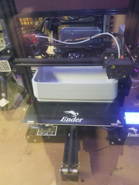

Wheel Horse 3D

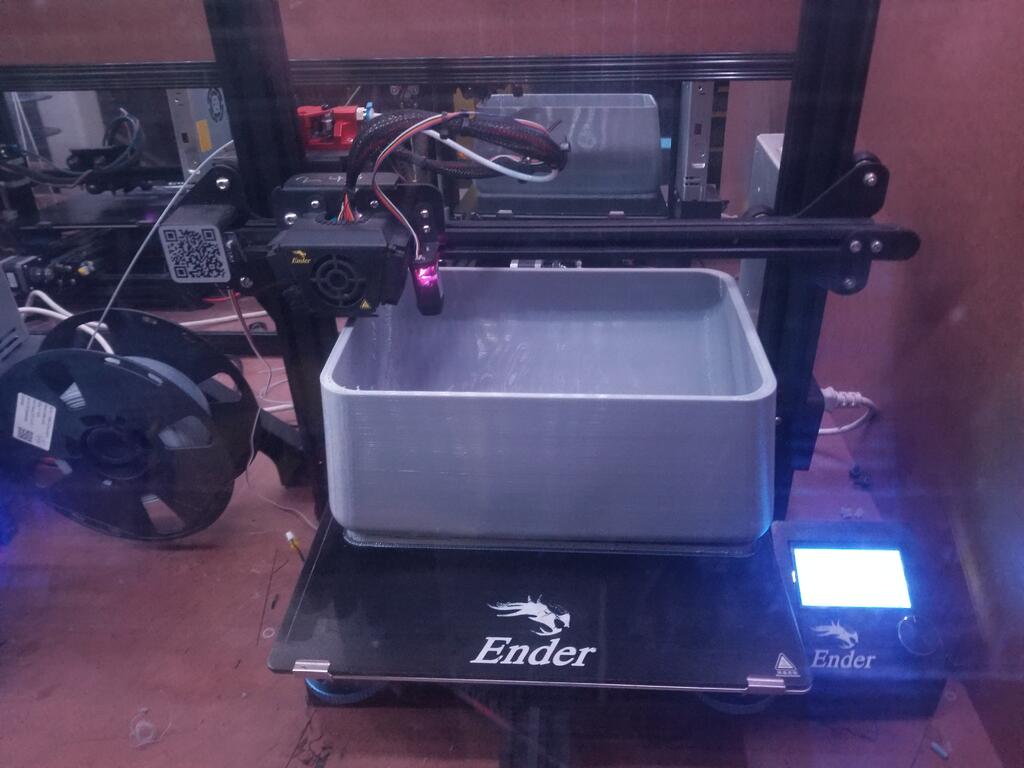

Tank top about 1/2 done.

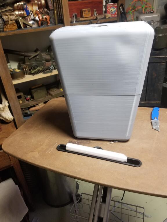

Wheel Horse 3D
About 75% !

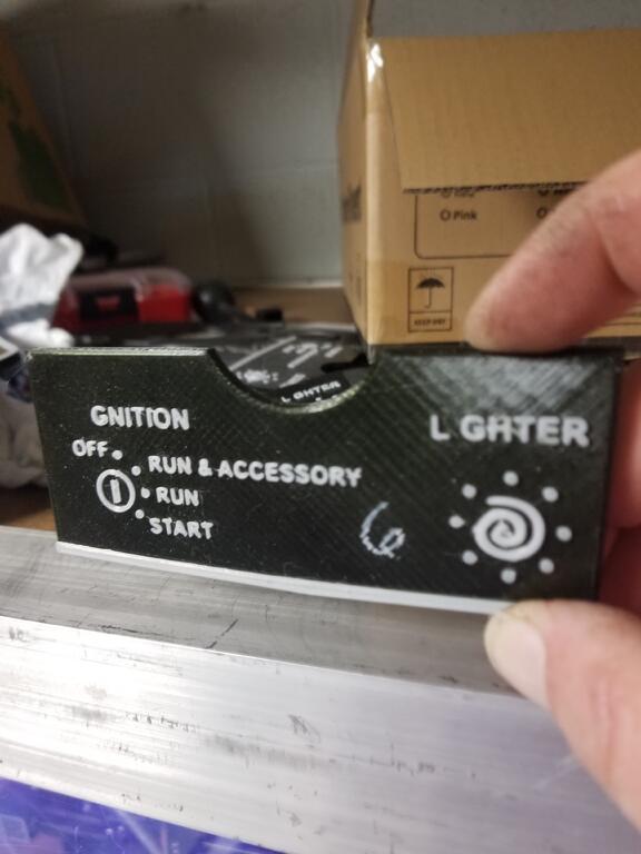

Wheel Horse 3D
Grrr still not satisfied. Layer adhesion between walls is terrible.I've gotta upgrade the machines before anything PETG comes out right I guess.

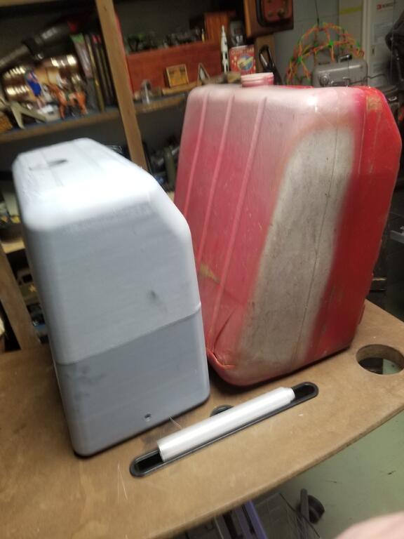

Wheel Horse 3D
Also a definate size difference, dunno how that compares to the ritchie99 aluminum.

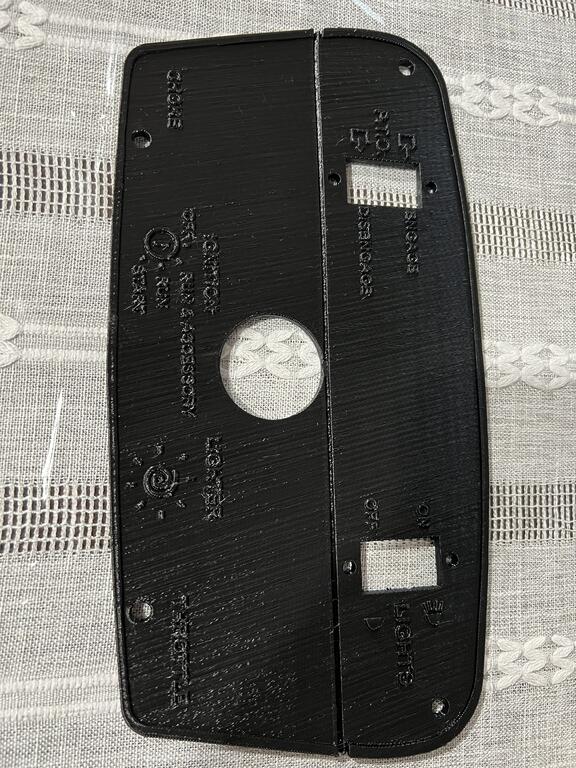

It's going to be tricky for me, my bed isn't quite big enough to print it flat so I need to angle it and use supports - but I think it'll work. I've been able to print at an angle with PLA, so fingers crossed PETG works as well. Worst case I'll split it in half and find a good way to join them together once printed.

What size is your bed? ABS is extremely easy to chemically weld with acetone, or acetone abs slurry. I really haven't tried that with PETG but good ol super glue works pretty well. My larger machines are 12". You might be able to cut at the fold line and squeeze on a 8 or 10 inch bed, but I'm sure it would be tight.

I was able to print it by splitting in half, then having them welded together. But then after I got that going, I figured out how to get the right angle and the right supports to be able to print in one piece, and it came out perfectly.
My bed is just over 10” x 10”, by the way.

Awesome!  Might try adjusting your extrusion factor a little to smooth out the surface or maybe ironing?
I did these without ironing, but my second color just won't make it with these printers.

I’m still very new to FDM printing, just started like a month ago, so I really haven’t dug into settings yet. This was kinda a project to learn a bit more about the software (like how to add manual supports), but the guy I printed it for is THRILLED!

Sharing ideas and 3d print knowledge is exactly what this thread is for, especially related to Wheel Horse items! I'd cut out a small section of the dash in your slicer as a test area and save it as a test. then adjust your flow rate 5% at a time up or down till you see the best result.I actually do this on the fly using the machine flow rate adjustment till I know i'm close then fine tune in the slicer from there. If I know which machine and slicer, I can actually be much more specific, just shoot me a message If ya need any tips at all. There are literally thousands of variable combinations which can affect your results, but temp and flow rate usually get ya really close.

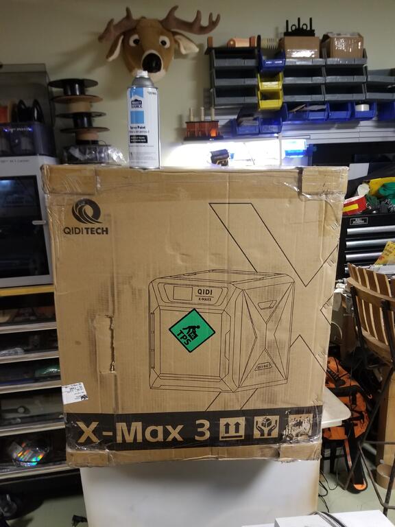

Wheel Horse 3D
Ladies and Gentlemen!!!! Introducing QuDi!
(Pronounced CheeDee)
2000 cubic inches and 67 lbs of upgraded 3d print awesomeness!(we hope! Lol!)
Probably won't have a chance to get setup till the weekend but new dash attempts are almost here!

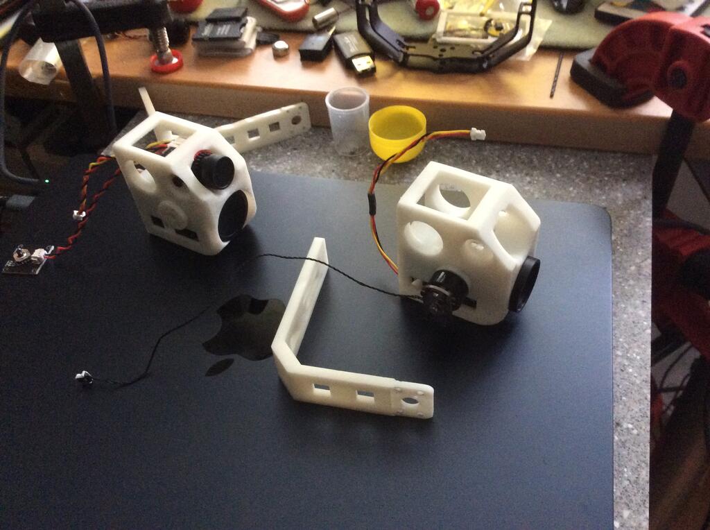

i bought me a year ago a Geeteck Alkaid resin printer.
I was surprised about the „just 99 Bucks“, but upon my first Prints i was absolutely fascinated.
It works out of the box like a charme.
The only thing i improved where the Resintanks.
i put a transparent stretchfoil between its build plate (Tank) and LCD Screen to protect the screen,
that turns out to be a good advice.85854BD0-9C84-4690-8184-563E4BA5426C.jpeg.2bec262eee082d5b42eec258b6102112.jpeg
here i built the new doubleaction Camera Carrier for the Drone.
( Thermal and video Cam) in one case with it‘s Gimbal.
Everything is just printed ( you just have to remove the support after Printing) that‘s it.
everything fits perfect since the beginning.

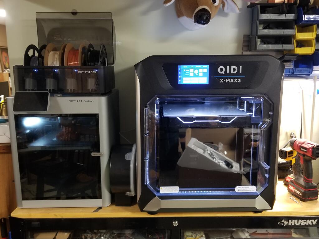

Wheel Horse 3D
Ta daaaaa! Unpacked and plugged in!

Outstanding! I avoid the resin printers due to the volume of items I print, and the associated waste liquids but they cant be beat for precision and fine detail
