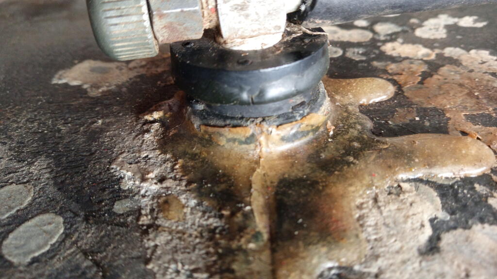

Maxwell-8 4,366 #1 Posted January 25, 2021 (edited) My raider 12 has a plastic fuel tank and it's leaking fuel strait on the battery It's a plastic one, and it's leaking where the shutoff valve is. Looks like there is not much pressure and the rubber seal. How can this be fixed? Can it be tightend? Edited January 25, 2021 by Maxwell-8 Share this post Link to post Share on other sites
Pullstart 63,661 #2 Posted January 25, 2021 That rubber grommet should likely be replaced. Before buying another, pull that one apart and inspect for cracks in the plastic tank. Then, the grommet is installed and the valve simply pushes in. 4 2 Share this post Link to post Share on other sites
Maxwell-8 4,366 #3 Posted January 25, 2021 14 minutes ago, pullstart said: That rubber grommet should likely be replaced. Before buying another, pull that one apart and inspect for cracks in the plastic tank. Then, the grommet is installed and the valve simply pushes in. Thanks but how do i disassemble it? Just jank everything out? Share this post Link to post Share on other sites
Pullstart 63,661 #4 Posted January 25, 2021 Yup. Twist and pull the valve, it’s just got an expanded end to hold it in place. 1 Share this post Link to post Share on other sites

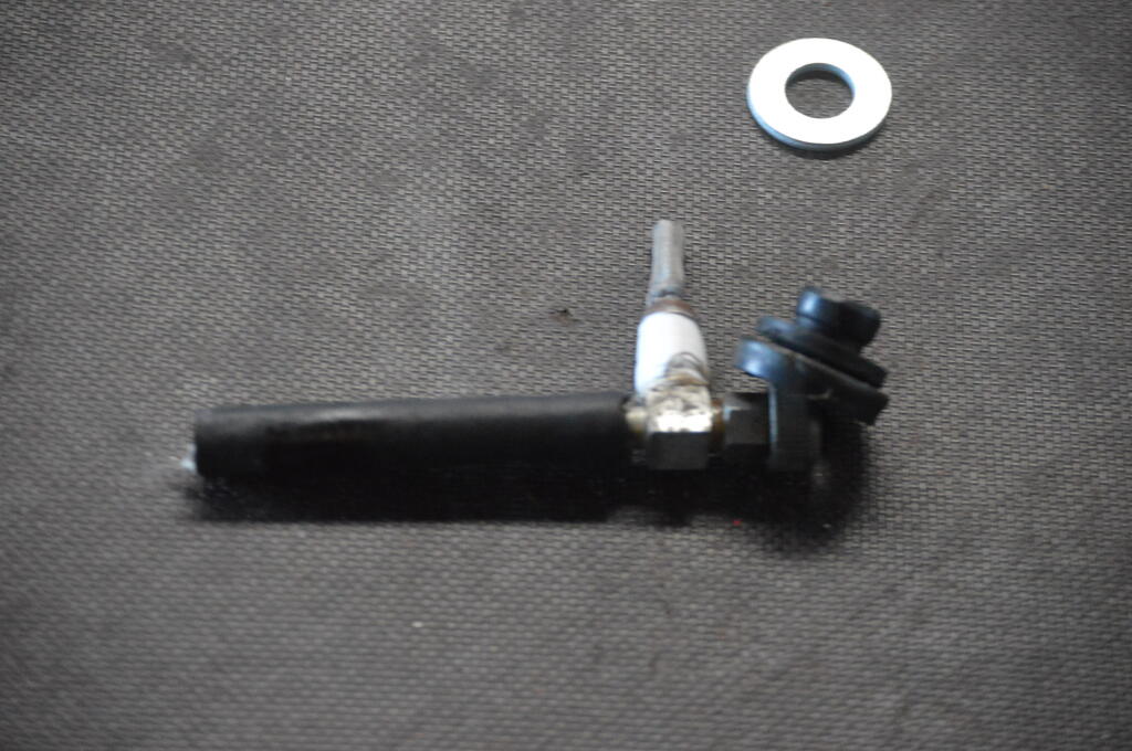

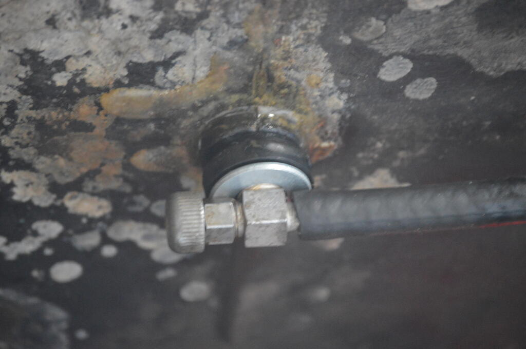

Maxwell-8 4,366 #9 Posted January 25, 2021 The tank is in good shape, gone try and find a new gromet set, for now, i used some ptfe-tape to make the grommet expand more, and used a washer beneath the gromet as it apperd to be saging, therefore letting gas leak thru. and used some grease. Thanks @pullstart, @peter lena Oh, yeah didn't i mentioned time for a proper fix ? 3 Share this post Link to post Share on other sites

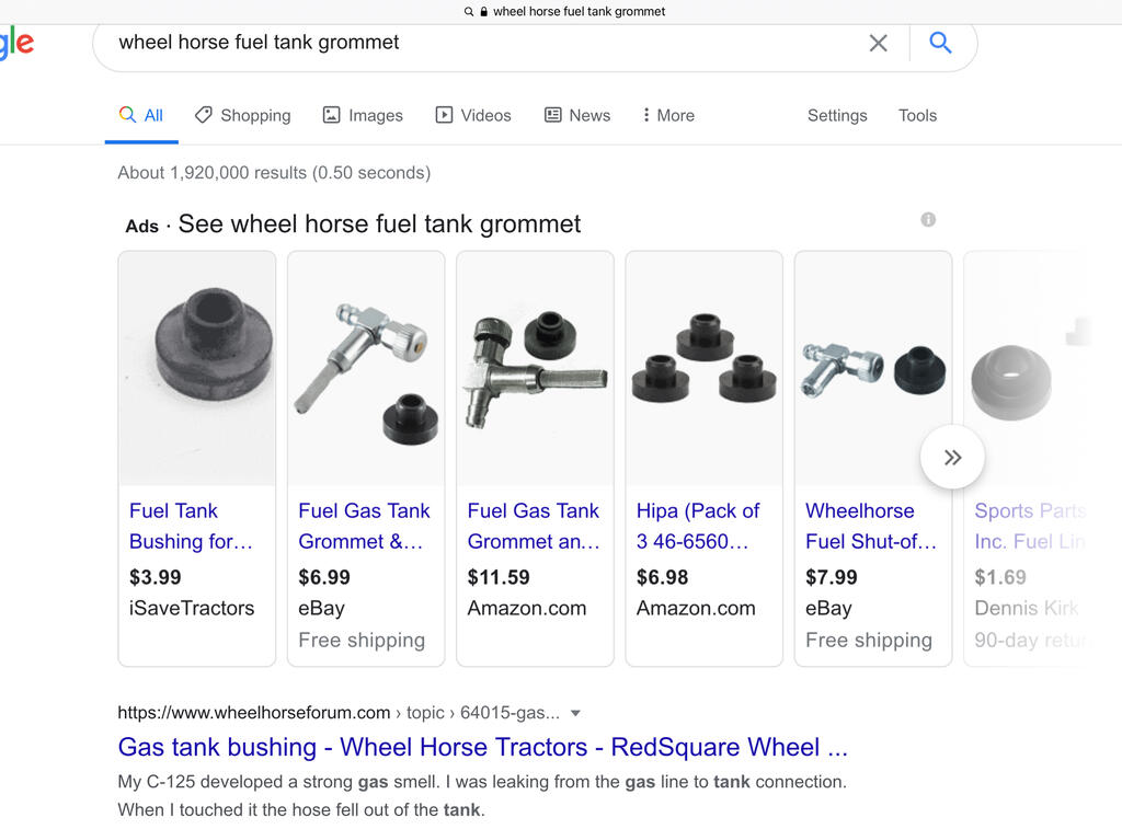

Maxwell-8 4,366 #10 Posted January 25, 2021 Is there a WH or Toro part number for this? I find this number, but not sure if it's correct, google gives nothing found with it: TORO #772030 Share this post Link to post Share on other sites
gwest_ca-(File Mod) 11,187 #11 Posted January 25, 2021 77-2030 is the wrong grommet used on small Toro gas trimmers https://www.partstree.com/parts/toro-77-2030/ 104047 is the most common one we see but Wheel Horse did not use it until 1974 so yours may be different. https://www.partstree.com/parts/toro-104047/ This link to a Stens dealer shows the dimensions and hole diameter https://www.bantasaw.com/catalog/viewproduct.asp?i=&p=220 Garry 1 Share this post Link to post Share on other sites
