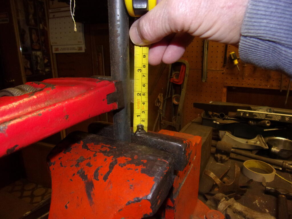

Ed Kennell 40,500 #19 Posted January 24, 2021 This is the arrangement I use to make short bends. The ends remain straight as no force is applied to the straight sections. The inside radius of the bend will be determined by the length between the two bending points. The outside will stretch and the inside will not compress. I have copper jaws for the vise and pipe wrench. With the bend area heated cherry red, 2"rounds can be bent with the 24" pipe wrench. You must over bend as the stretched outside radius will shrink as it cools resulting in less bend. Small bend adjustments can be made by applying heat to the correct side of the bend. Oxy/Ac torch works great for fine control of heating the desired area. The Mapp torches may work, but I have no experience with these torches. 1 2 Share this post Link to post Share on other sites
