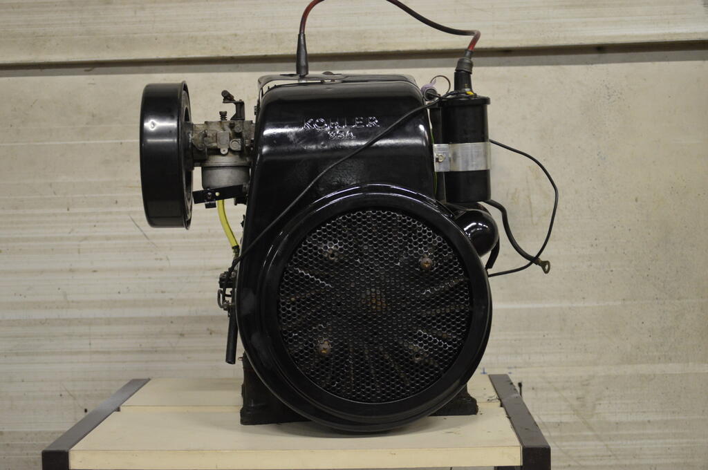

Maxwell-8 4,366 #1 Posted January 22, 2021 My Kohler K301 is letting oil seep tru the valve guides, Can this be fixed? Share this post Link to post Share on other sites

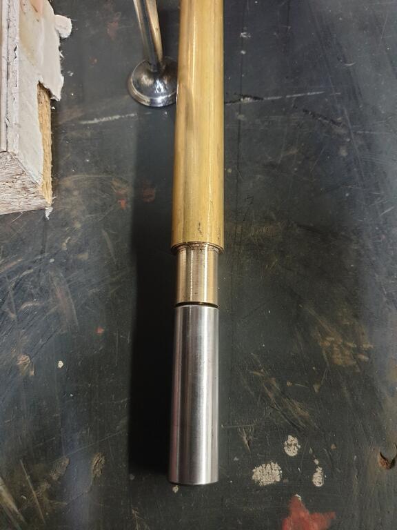

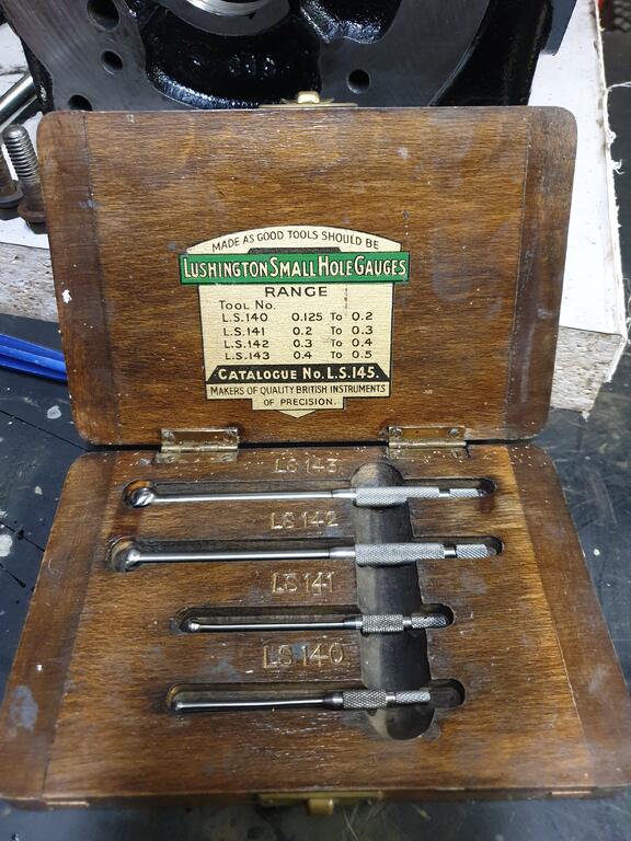

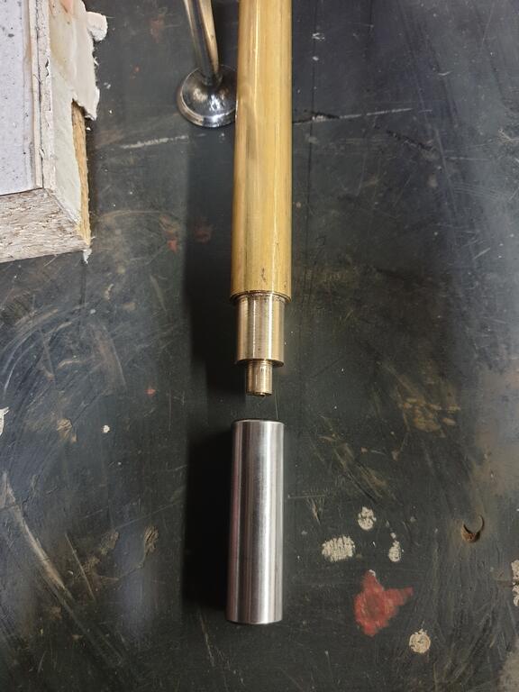

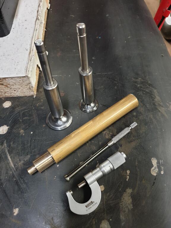

Mickwhitt 4,875 #9 Posted January 22, 2021 Good point Eric! This is my kit of tools for the valve guides. The punch was turned from brass to fit the valve guides really well. The spigot fits into the bore to keep the punch centred. Drift the guides out from above, remembering they are at an angle to the vertical! Mark each guide inlet or exhaust so you don't mix them up. According to the manual the exhaust stem has a slight taper to prevent it sticking in the valve guides so remember that when measuring the ex valve stem. The small hole gauges are the best way to measure the guide bores. They expand into the bores and you measure across the ball with a micrometer. If you are going to all this trouble replace the valves and guides for what they cost. The guides need to be reamed out to 5/16" after they are pressed in (remember they are at a slight angle so don't press perpendicular to the crankcase/sump gasket face). 3 Share this post Link to post Share on other sites
