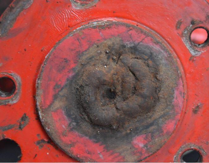

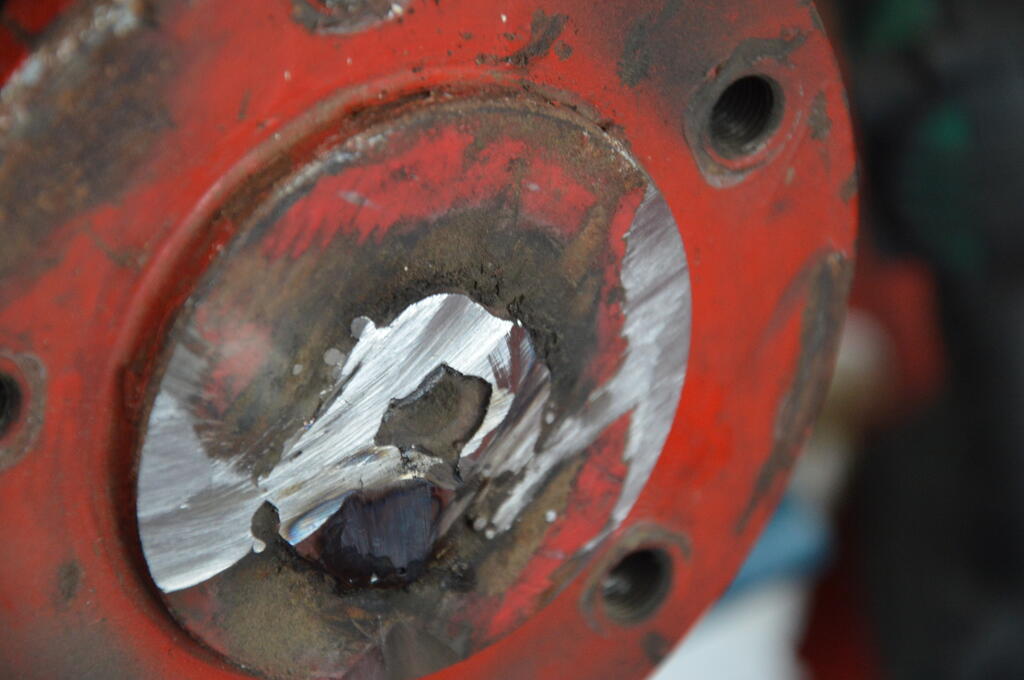

Maxwell-8 4,277 #45 Posted January 21, 2021 Men, those freaking hubs, they are welded bad, but with deep penetration, My opinion: axle and hub SHOT. After the 2100w Angle grinder: ON pics, it looks like it might work but in person, no 2 Share this post Link to post Share on other sites
bc.gold 3,403 #46 Posted January 21, 2021 (edited) 1 hour ago, Maxwell-8 said: Men, those freaking hubs, they are welded bad, but with deep penetration, My opinion: axle and hub SHOT. After the 2100w Angle grinder: ON pics, it looks like it might work but in person, no When you figure the weld has been ground thin, push the hub further onto the axle. Cast iron does not weld very good and the remaining weld should break free then you can clean up the axle to remove the hub. When you have the time can you give me the measurement of the piece that fits inside the wheel rim center also the bolt circle would be handy to know as well, thanks. Edited January 21, 2021 by bcgold 1 Share this post Link to post Share on other sites

stevasaurus 22,769 #49 Posted January 22, 2021 Maxwell, you've got nothing to lose. Grind the weld down to the end of the axle and maybe a touch more. The weld should break loose then..maybe with a little heat. 2 Share this post Link to post Share on other sites
Maxwell-8 4,277 #50 Posted January 27, 2021 (edited) On 1/22/2021 at 8:28 PM, stevasaurus said: Maxwell, you've got nothing to lose. Grind the weld down to the end of the axle and maybe a touch more. The weld should break loose then..maybe with a little heat. time to try it tomorrow, got a spare trans, so indeed nothing to loose. Made myself a nice hub puller from a thick steel plate And another small question: Can the outer axle bearing be replaced without splitting the case? Bought spare, replaced the seals only to find out, it didn't had axle bearing on the right axle and moved a bit up and down. It did had one on the left side. Thanks!!!! Edited January 27, 2021 by Maxwell-8 1 Share this post Link to post Share on other sites
