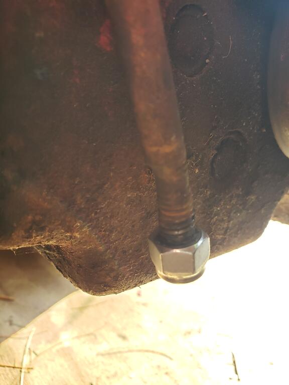

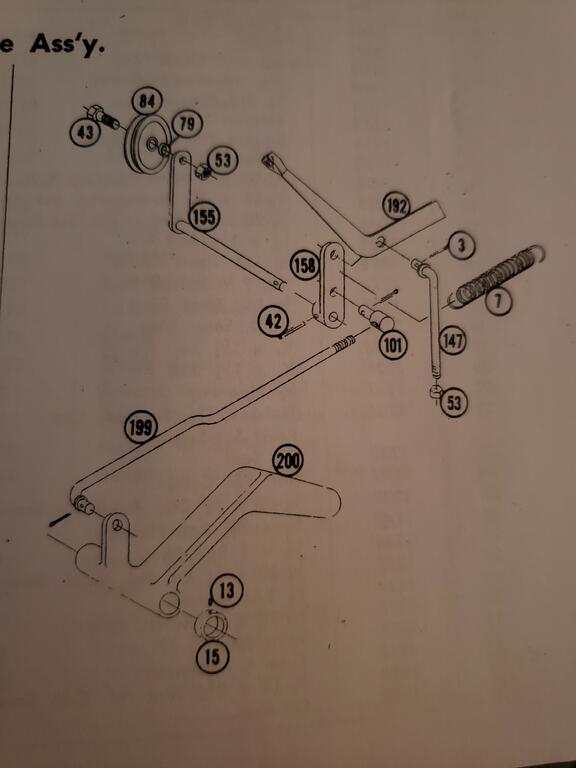

The rod that goes through the brake band (part #147 in the diagram) is worn where it passes through the band.
I tried to take it all apart to replace that part, but no luck. I tried taking out the cross pin, but ended up breaking my skinny punch and barely moved the pin.

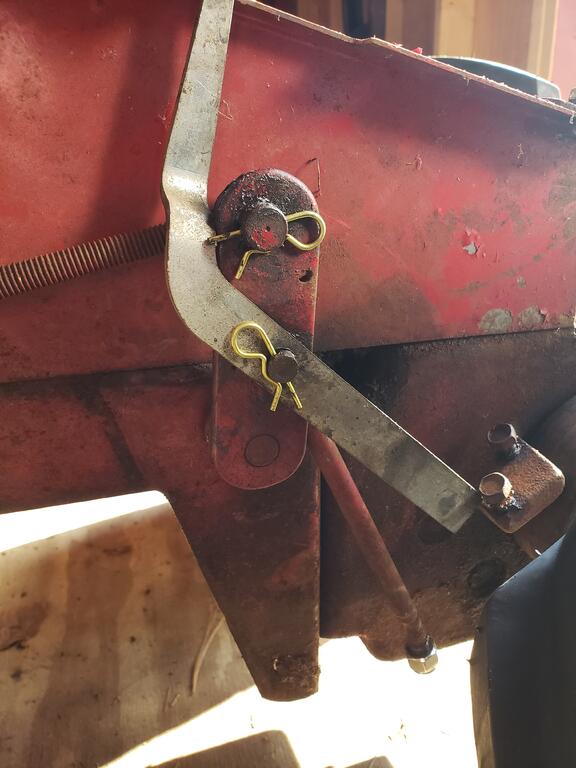

What im curious about, is the placement of the parts. Per the diagram, part 101 and 147 should go in from the outside, with the cotter pin between the arm (part 158) and the frame. Mine are reversed, with the pins on the outside.
Also, my brake rod goes into the top hole, whereas the band rod is shown in the top hole.

71_Bronco
Here's a pic of my linkage. Pretty much backwards in every way compared to the picture. Still works fine though.
I also attached a picture of the worn part #147. However, I can't replace it unless I get the cast arm off, and I already failed at that (couldn't get the cross pin out).
