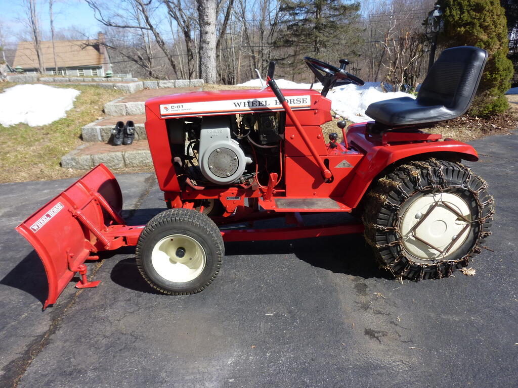

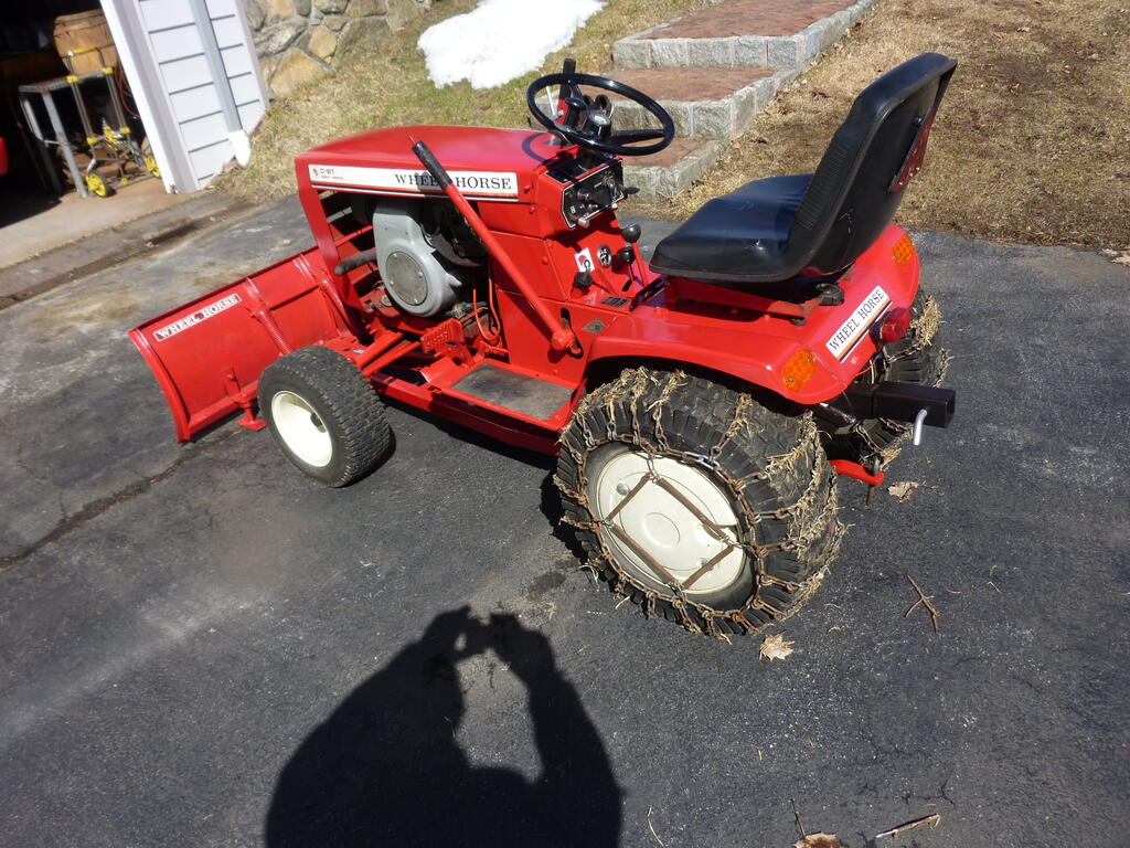

Rob R 970 #11 Posted January 12, 2021 Go with the long frame plow will work great B80 is basically the same as a C81. The machine one of the best snow plow combinations on earth...... 1 1 Share this post Link to post Share on other sites

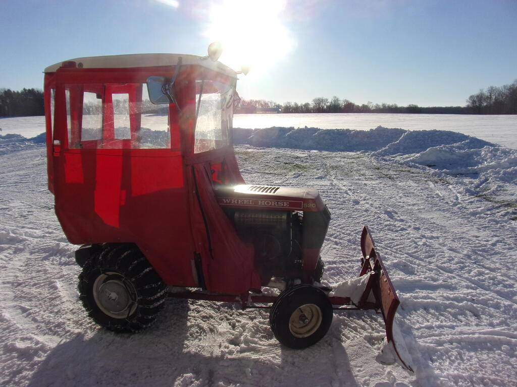

Ed Kennell 40,484 #12 Posted January 12, 2021 34 minutes ago, Rob R said: the best snow plow combinations on earth...... Maybe second best Rob. 4 1 Share this post Link to post Share on other sites
