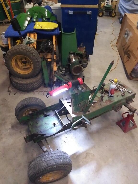

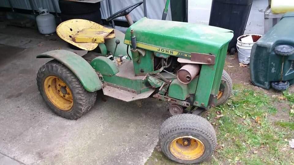

Chris G 3,334 #1 Posted January 11, 2021 (edited) Picked this little guy up super cheap and its a one owner machine. Been in continued use up until 5 years ago. Then just stored in the corner for the last five years. So i decided to pick it up and do a patina restoration and complete mechanical on it. Edited January 11, 2021 by Chris G 8 2 Share this post Link to post Share on other sites

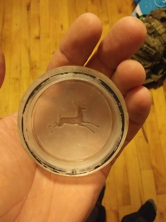

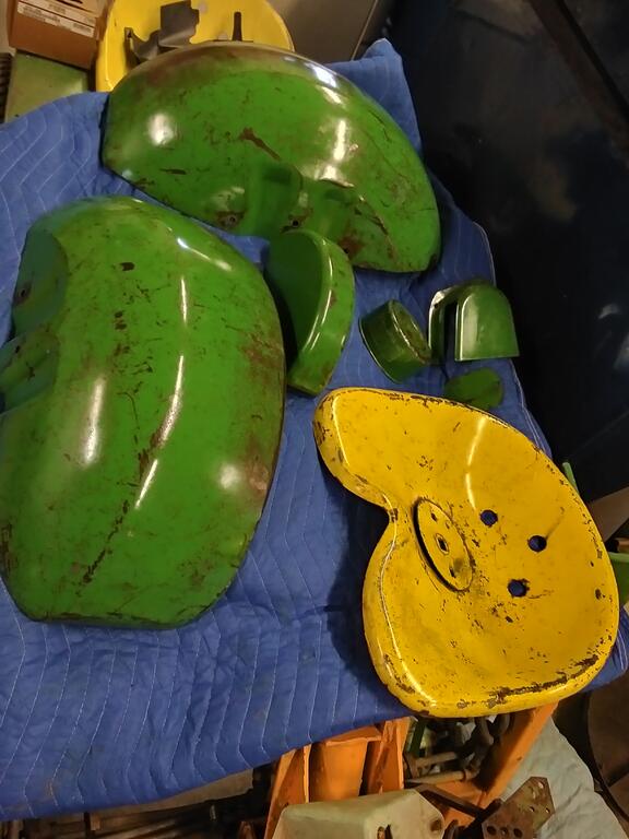

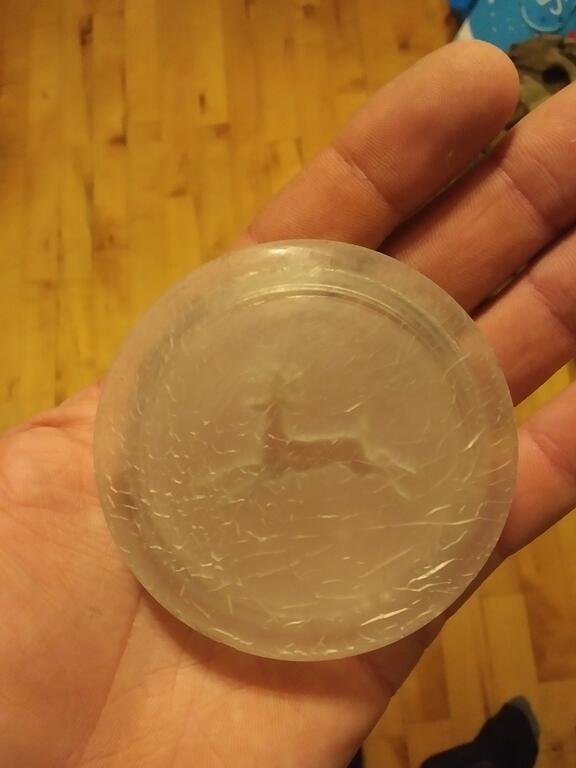

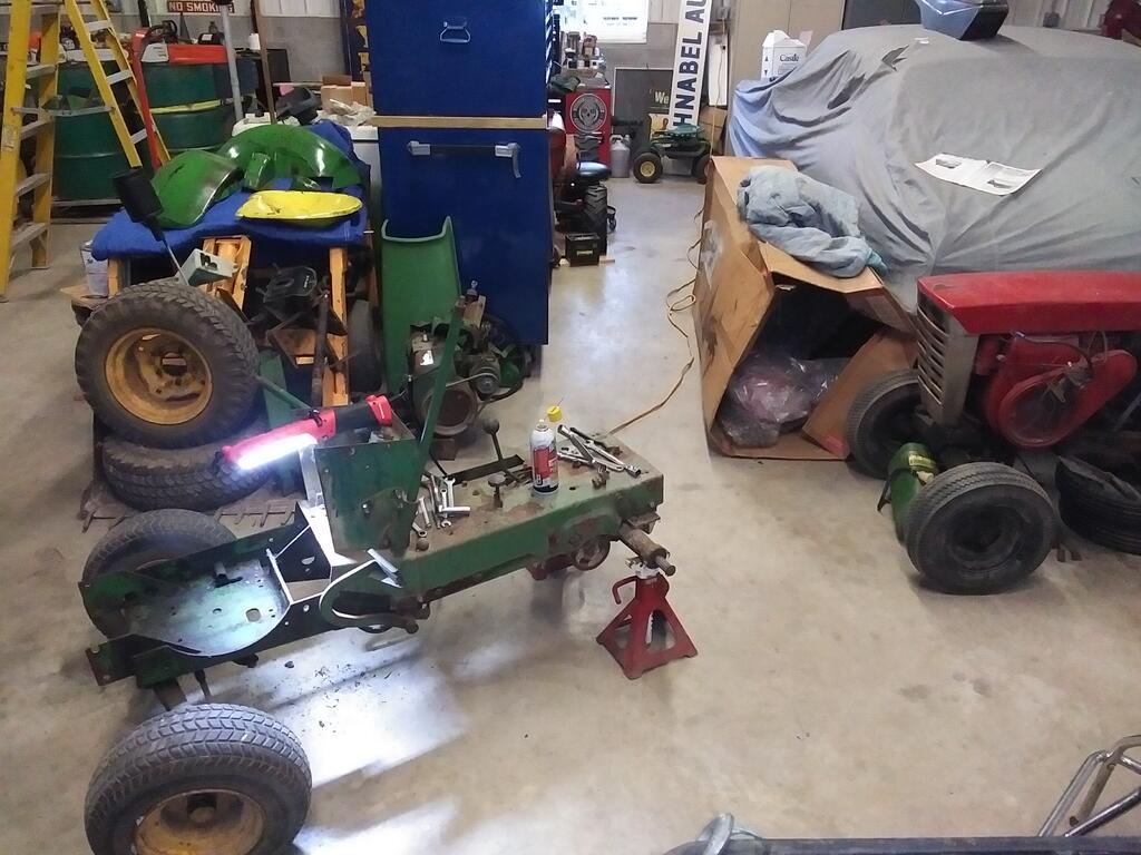

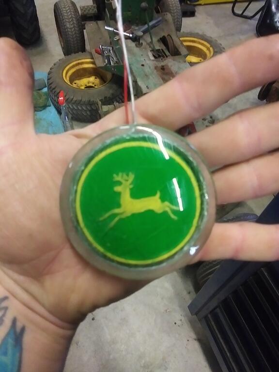

Chris G 3,334 #2 Posted January 11, 2021 (edited) Got alot tore down since i got it the other day and started cleaning and clear coating a few parts and redid the sterring wheel cap. Edited January 11, 2021 by Chris G 3 2 Share this post Link to post Share on other sites

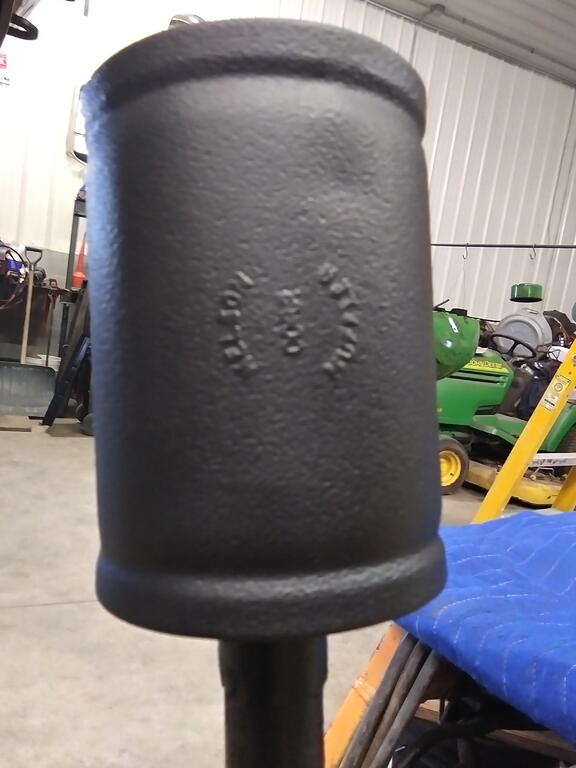

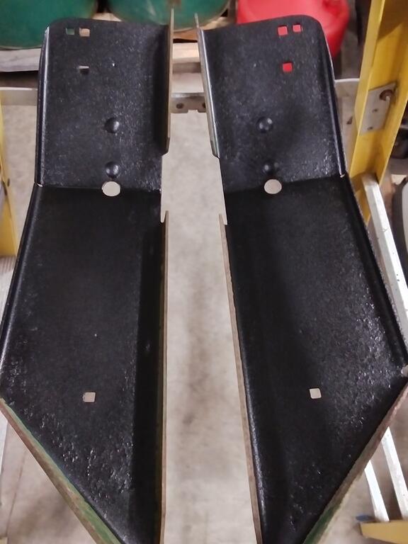

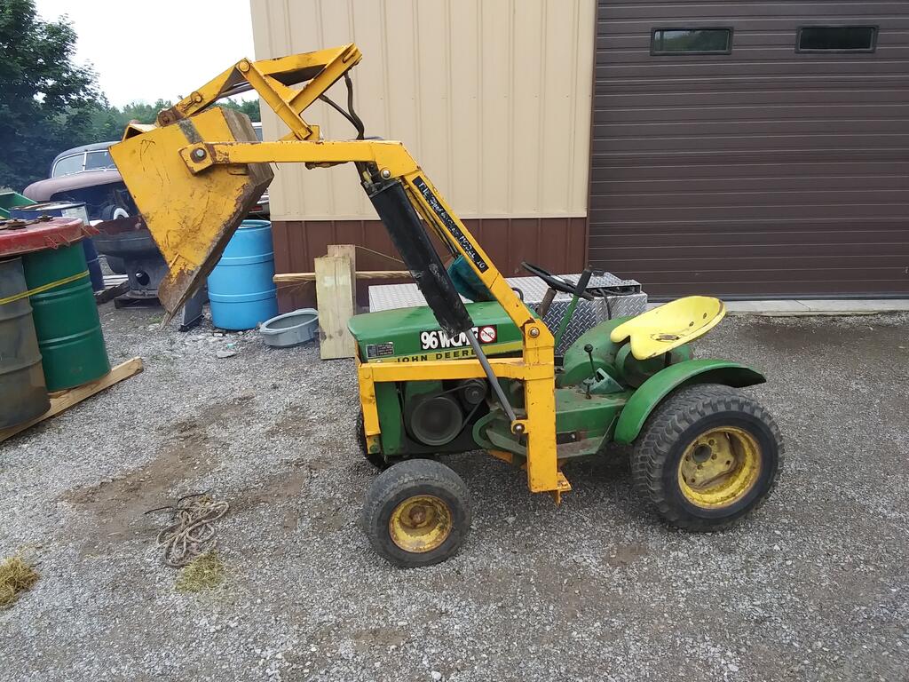

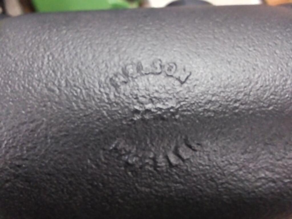

Chris G 3,334 #3 Posted January 11, 2021 (edited) Bed linered the foot rest and blasted and re painted the nelson muffler as well. Edited January 11, 2021 by Chris G 7 4 Share this post Link to post Share on other sites
ebinmaine 70,541 #4 Posted January 11, 2021 Excellent job so far Sir. I've always had a thing for those round fenders... Looking forward to seeing your progress!! Share this post Link to post Share on other sites

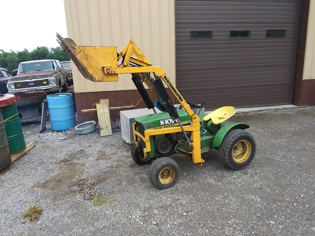

Chris G 3,334 #5 Posted January 11, 2021 I will be frowned on for this im sure, but i like them myself. I have a nice front end loder 65 110 as well 8 2 Share this post Link to post Share on other sites

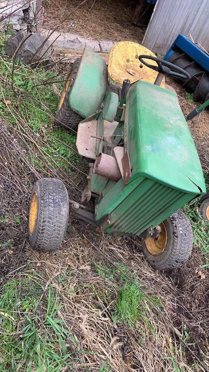

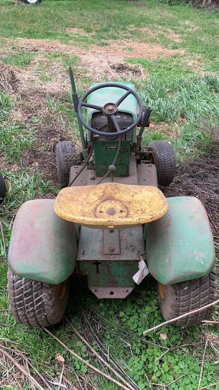

adsm08 2,602 #6 Posted January 11, 2021 (edited) I have a 110 and a 112 just like that in my garage. Roughly the same state of assembly as well. My grandfather was doing something with them when he died. Nobody really knows what. Edited January 11, 2021 by adsm08 3 Share this post Link to post Share on other sites

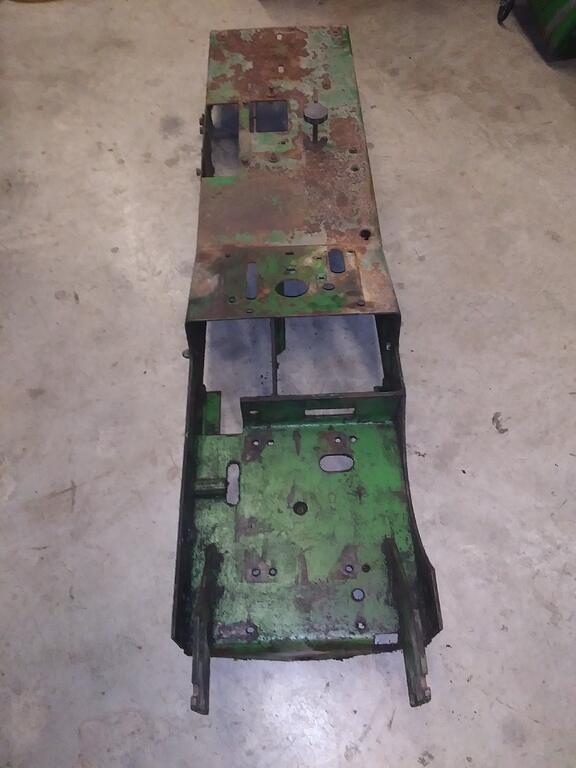

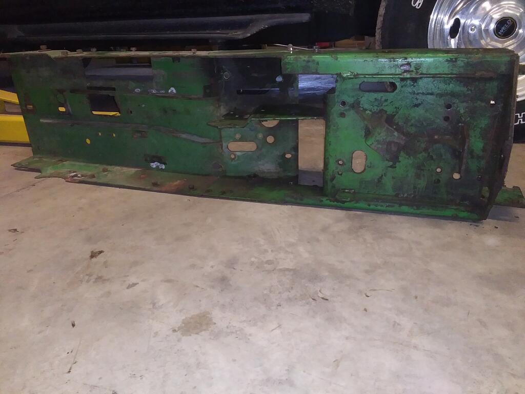

Pullstart 64,436 #11 Posted January 11, 2021 Is the frame all a stamped piece? How thick is it? I have zero experience with them, but do enjoy the design of the body. Share this post Link to post Share on other sites

Chris G 3,334 #13 Posted January 11, 2021 37 minutes ago, pullstart said: Is the frame all a stamped piece? How thick is it? I have zero experience with them, but do enjoy the design of the body. I will get some more pics and some measurements, when i get the rest of it stripped down. 1 Share this post Link to post Share on other sites

Chris G 3,334 #15 Posted January 11, 2021 @oliver2-44 mine has a 8hp kohler. And by mechanical restoration, i will go through every nut and bolt and clean fix or repair everything in need and then reassemble. @pullstart the rear half of frame is 1/8 inch stamped steel woth a few plates welded on undernesth and the front half of frame is 1/4 steel stamped with a few pieces welded on and then both halfs were welded together 2 Share this post Link to post Share on other sites

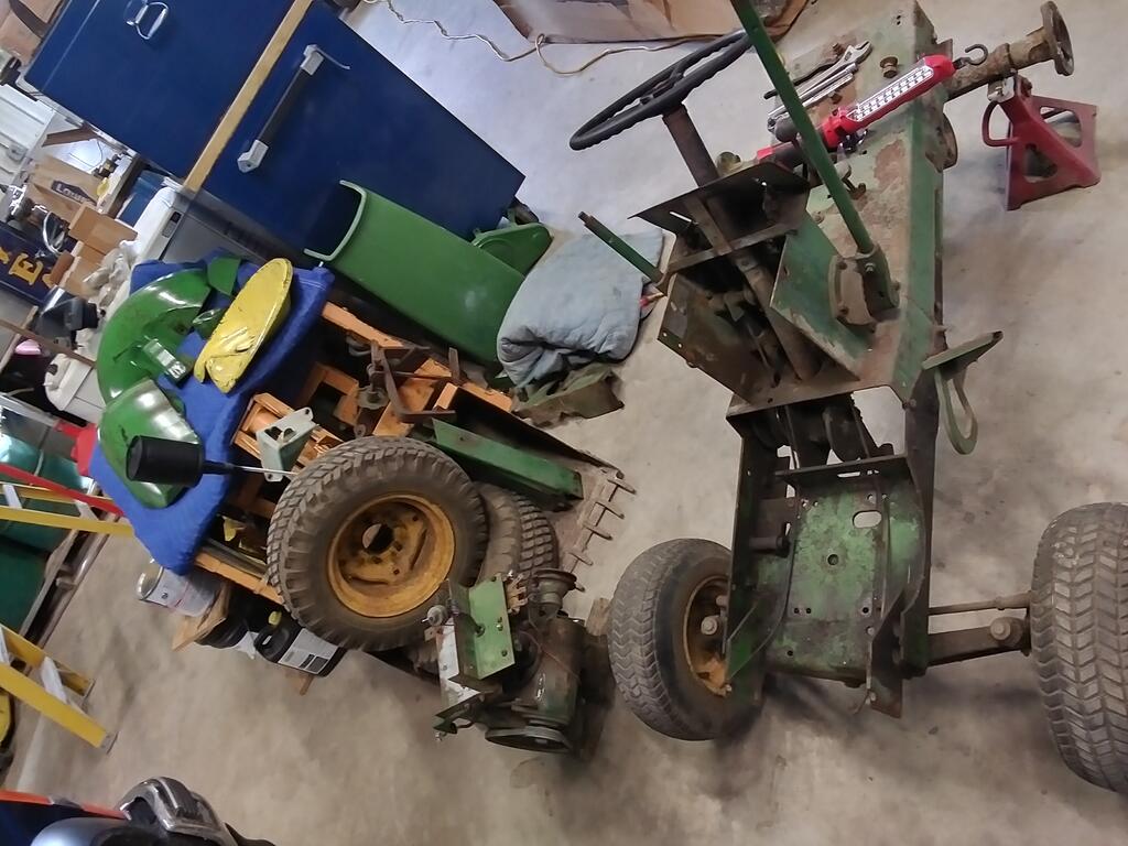

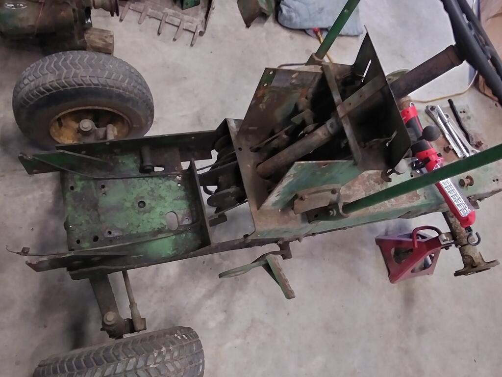

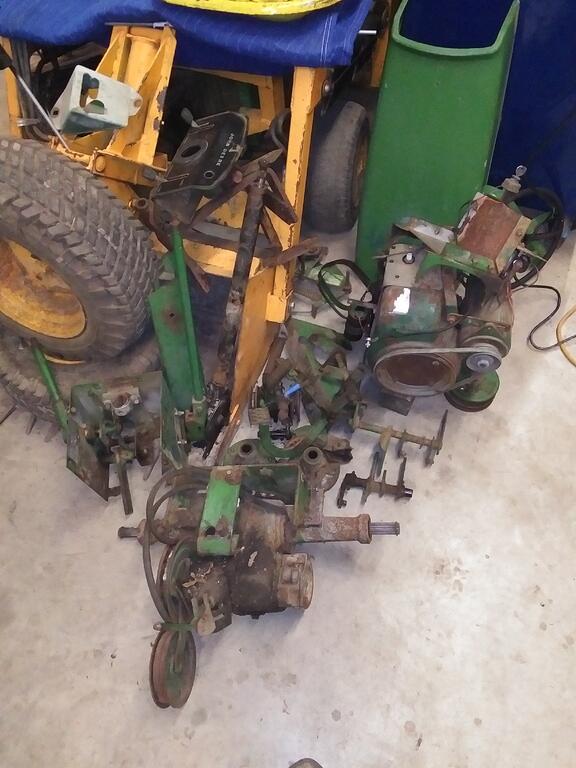

Chris G 3,334 #16 Posted January 11, 2021 Well i got every nut and bolt seperated and some pieces left roughly assembled. Which i will tear apart again and go through piece by piece. 1 Share this post Link to post Share on other sites
ebinmaine 70,541 #17 Posted January 11, 2021 Very well done sir. Bare metal going to stay bare metal or are you going to be painting any areas? 1 Share this post Link to post Share on other sites

T-Mo-(Moderator) 4,544 #21 Posted January 12, 2021 The 7 hp only were in the 1963 models, which can be easily identified by the placement of the deck lift lever. They also had a 3 speed transmission, not the 4 speed, and had only 3 bolts for the rear hubs per side. And had fiberglass fenders which may have been replaced with metal fenders. As I mentioned, the round fender tractors had some minor changes throughout the years, 1963 to 1967. In 1964 the 8 hp was dropped in, and the 4 speed transmission added, plus the lift lever was lowered and metal fenders replaced the fiberglass ones. 1965 added 5 bolts to the rear hubs. 1966 added the words "Variable Drive (or Speed, I can't remember which) to the dash and made some changes underneath with the clutch/brake mechanisms. 1966 also added the option of hydraulic lift, plus the 112 was introduced. 1967 the foot rests were welded on, not bolted. There were some other changes, but I can't remember them all. 4 Share this post Link to post Share on other sites

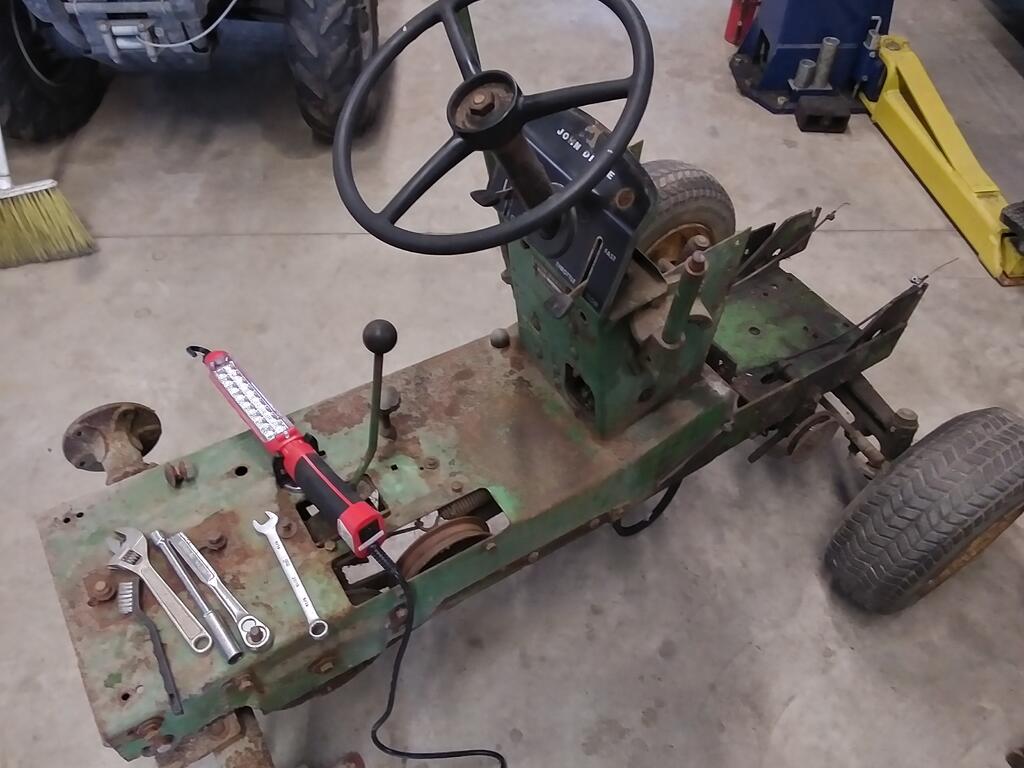

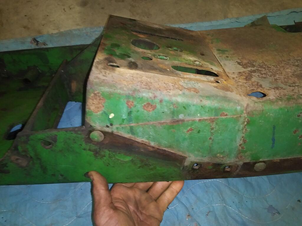

Chris G 3,334 #22 Posted January 12, 2021 I spent a few hours cleaning the frame today and cleaned up steering and few odd components. Ill get more pics of progress as i go. 1 Share this post Link to post Share on other sites

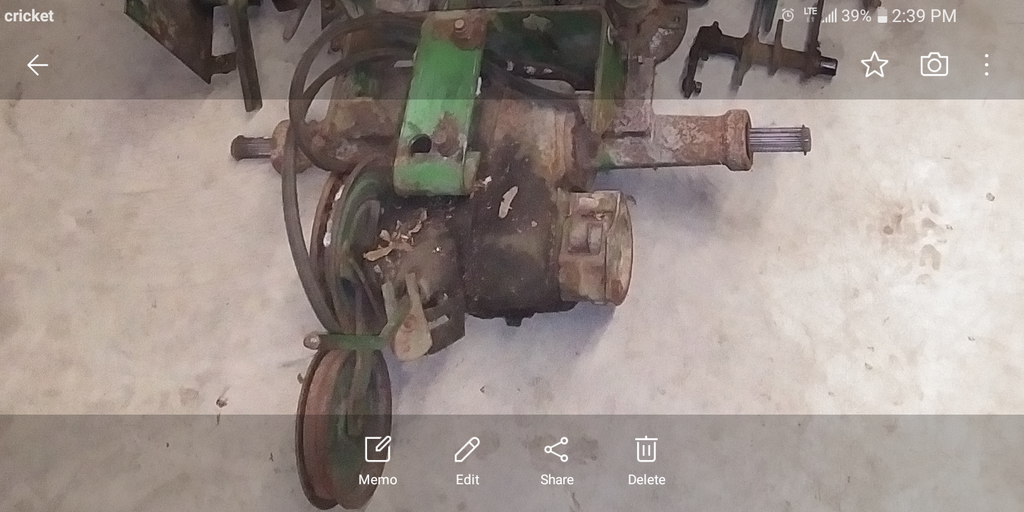

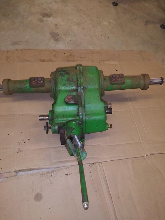

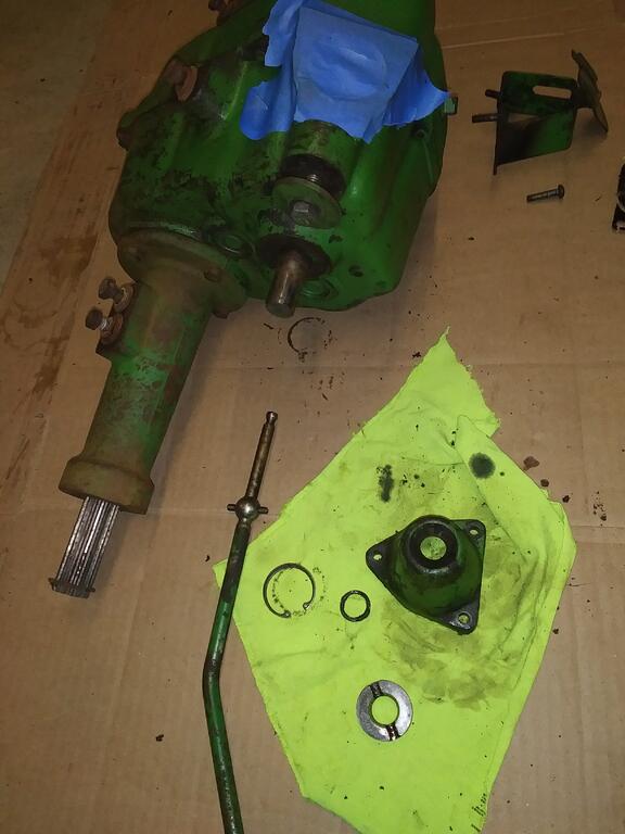

Chris G 3,334 #25 Posted January 13, 2021 Finished cleani g a few thing today. Spent about 6 hours on the transaxle. Got to pick up a few things to seal it back up and that will be done. 2 Share this post Link to post Share on other sites
