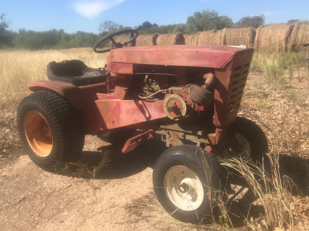

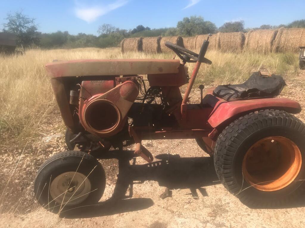

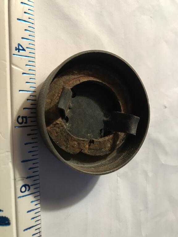

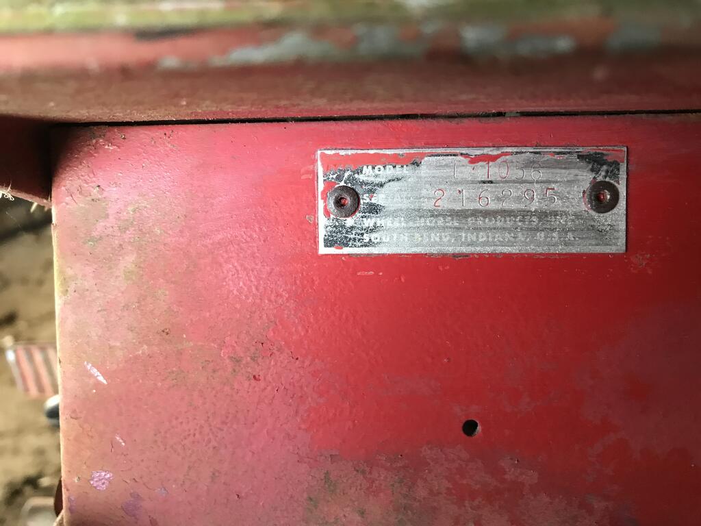

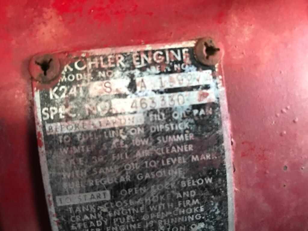

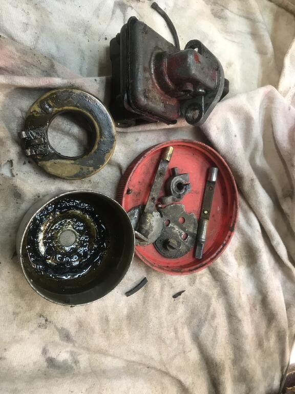

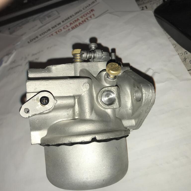

oliver2-44 10,370 #1 Posted January 10, 2021 The 1056 i picked up in East Texas is at the Barn at the farm. So each time I've been down deer hunting morning and evening I would work a little on tractor during my mid-day break. I haven't named my tractors in the past, but as I was sanding the seat pan to clear coat it I notice the 3 layers of read pain was quite patchwork. So @pullstart got me started and I'm calling this one Patches. This one will stay at the farm and be my trail/pasture rider. I can thank @Greentored for that idea. I use this thread to document all the work and fun I have with Patches. cleaned up kind of nice with just a bath. Here's the tractor and 10HP kohler nameplate. If the engine runs good, it might eventually get swapped with the Predator on the 1054. The Car, fuel Pump and Tank were quite dirty so I brought them home to clean them up. The carb was so filthy I soaked it in Carb cleaner, then bead blasted it. This is the first time I have glass bead blasted a carb. The fuel pump cleaned up nicely with just a soaking. I'll go reassemble it this afternoon. The cork gasket under the metal gas tank cap is compressed, dried out and cracked. Does anyone have a good method of making one of these, or a source to buy a new gasket? 6 5 1 Share this post Link to post Share on other sites
ebinmaine 70,792 #2 Posted January 10, 2021 Beautiful work so far Sir. Particularly the carb. Looks new. Lookin forward to your work and adventures! 1 Share this post Link to post Share on other sites
Achto 28,799 #3 Posted January 10, 2021 3 hours ago, oliver2-44 said: Does anyone have a good method of making one of these, or a source to buy a new gasket? I usually go to my local hardware store and find a neoprene/rubber washer that is the correct size to replace the cork gasket. 3 Share this post Link to post Share on other sites
oliver2-44 10,370 #4 Posted January 11, 2021 1 hour ago, Achto said: I usually go to my local hardware store and find a neoprene/rubber washer that is the correct size to replace the cork gasket. Thanks for the idea @Achto, I'll check out Ace this week! 1 Share this post Link to post Share on other sites

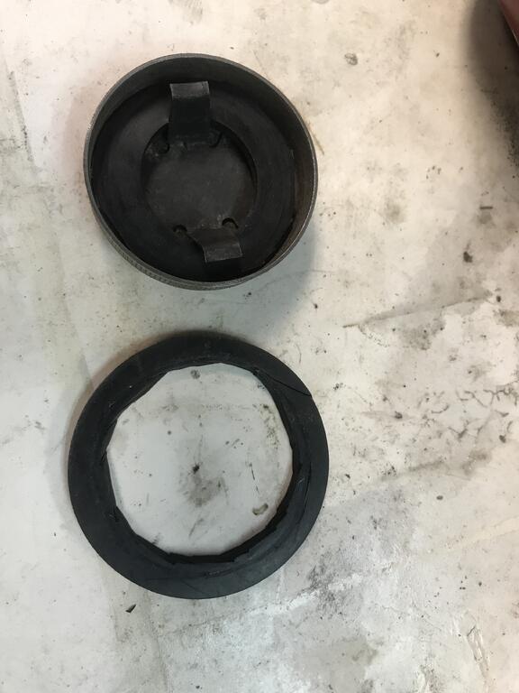

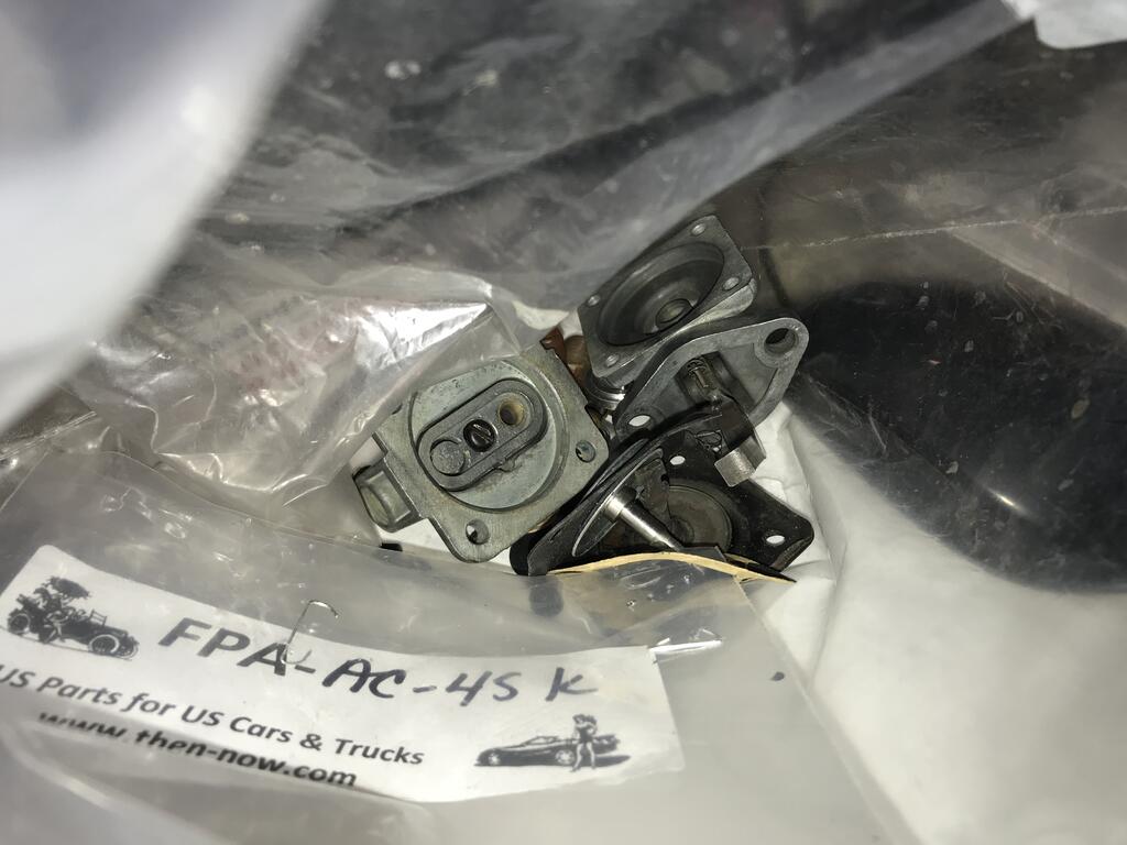

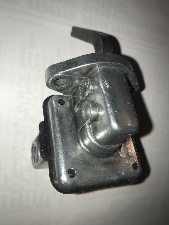

oliver2-44 10,370 #6 Posted January 24, 2021 (edited) Bling. It’s @AMC RULES fault. After seeing him polish a muffler, I had to see what a few minutes with my cloth compound wheel and some white rouge would do. Another part cleaned, rebuild kit installed and polished a little. It’s in the box for the next trip to the farm. Picked up a large rubber washer from Ace. I found one with the correct ID and cut the OD to fit the old gas cap. Edited January 24, 2021 by oliver2-44 5 Share this post Link to post Share on other sites
pfrederi 18,335 #7 Posted January 25, 2021 It looks pretty ...but does it pump better 1 Share this post Link to post Share on other sites
AMC RULES 37,147 #8 Posted January 25, 2021 A couple minutes with a well worn wire wheel first, or brush by hand is typically enough to achieve the look. Share this post Link to post Share on other sites
oliver2-44 10,370 #9 Posted January 25, 2021 4 hours ago, pfrederi said: It looks pretty ...but does it pump better The overhaul kit should make it pump better.......Bling adds an extra big smile to our face🤪 1 Share this post Link to post Share on other sites

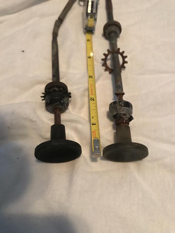

953 nut 57,985 #14 Posted March 5, 2021 On 2/11/2021 at 3:31 PM, oliver2-44 said: I need some help finding Choke and Throttle cables that match the originals as close as possible. Do a search for WWII Jeep or Power Wagon throttle cables. 1 1 Share this post Link to post Share on other sites
Achto 28,799 #15 Posted March 5, 2021 10 minutes ago, 953 nut said: Do a search for WWII Jeep or Power Wagon throttle cables. Am I wrong, or is that style for the round hoods?? I thought that the '65 and newer models had this cable. 1st and 3rd item at this site. http://www.psep.biz/store/toro_mower_cables.htm 2 Share this post Link to post Share on other sites

953 nut 57,985 #17 Posted March 5, 2021 3 minutes ago, Achto said: is that style for the round hoods?? Good catch. I was thinking along the lines of a locking throttle cable. 1 1 Share this post Link to post Share on other sites
oliver2-44 10,370 #18 Posted March 5, 2021 (edited) Edited March 5, 2021 by oliver2-44 1 Share this post Link to post Share on other sites
oliver2-44 10,370 #19 Posted March 5, 2021 15 hours ago, Achto said: Am I wrong, or is that style for the round hoods?? I thought that the '65 and newer models had this cable. 1st and 3rd item at this site. http://www.psep.biz/store/toro_mower_cables.htm Thanks, @953 nut and @AchtoMy old one have been soaking in warm diesel for 2 weeks and haven't moved yet. I say "warm diesel" as they are safety positioned on the shelf that is above my little shop electric heater that runs when I'm in the shop. 3 Share this post Link to post Share on other sites
Pullstart 64,596 #20 Posted March 5, 2021 3 minutes ago, oliver2-44 said: Thanks, @953 nut and @AchtoMy old one have been soaking in warm diesel for 2 weeks and haven't moved yet. I say "warm diesel" as they are safety positioned on the shelf that is above my little shop electric heater that runs when I'm in the shop. I think it was on here I read, I’m thinking it was @Ed Kennell, who said to clamp the solid part in a vice and rotate the knob to twist the cable free from the sheathing after you cut the Z bend off. Clean it up, then reassemble and bend. 1 Share this post Link to post Share on other sites
Ed Kennell 40,509 #21 Posted March 5, 2021 19 minutes ago, pullstart said: who said to clamp the solid part in a vice That's right Kev. The key here is by clamping the sheath in the vise at the knob or lever end and then twisting the wire at that end, you are only trying to free a small part of the wire at the very end as opposed to pushing or pulling the entire wire. It works for me. 1 1 1 Share this post Link to post Share on other sites

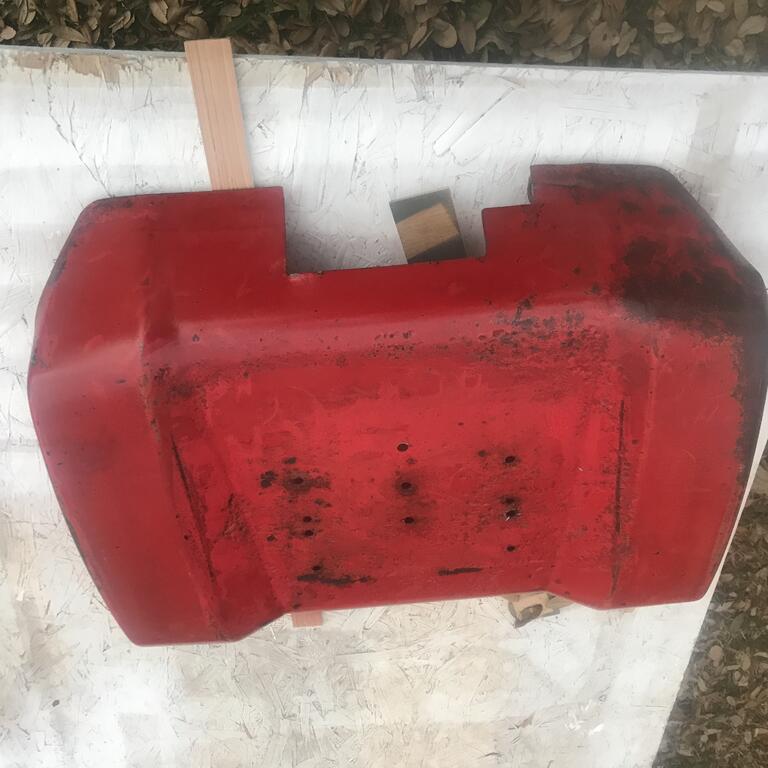

oliver2-44 10,370 #22 Posted March 17, 2021 I brought the seat pan home with me from the farm and tried sanding it down to original paint The 2 repaint color coats were fairly thick. I got kind of aggressive with some 180 and still didn’t sand through them. I moved to plan B and gave it a @pullstart 320 wet sand and 2 coats of Rustoleum rattle can satin clear, wet sanding between coats with some 600. The 3 shades of red kind of fits the “Patches” name. 3 2 Share this post Link to post Share on other sites
