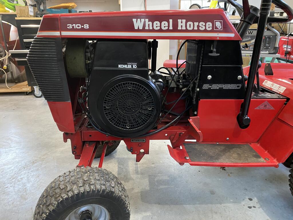

BeninCT 451 #1 Posted January 9, 2021 Just got it today and it all works as it should but there is a sound from the rear end a little like a car low on power steering fluid. Like a metallic whine while moving. Gear oil is light brown indicating moisture contamination so will drain and prob just flush it through with a couple oil changes rather than the diesel flush. Think clean fluid will solve the sound or is it normal or what? LOVE this tractor and need to maintain it as someone has for the last 25 years... its mint. Here is a pic of it but didn’t take a shot of the diff. It’s and 8 speed standard for the model. 3 2 Share this post Link to post Share on other sites
WHX?? 49,969 #2 Posted January 9, 2021 As I mentioned on your welcome thread yes change that fluid. Jack the front up to get some oil out that's in front of a hump in the middle. Jack the rear up and and check the wheel bearings for any up and down play. check the tightness of the wheel hubs and the input pully. Fender pan comes off with just a few more bolts for better inspection. 2 2 Share this post Link to post Share on other sites
