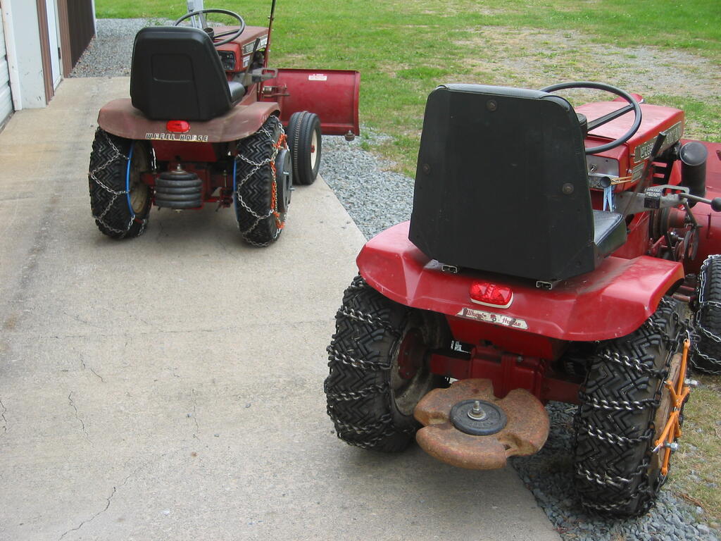

WHNJ701 4,165 #7 Posted January 10, 2021 It's a great body style, I recently redid a com. 6 3 1 Share this post Link to post Share on other sites

WHNJ701 4,165 #10 Posted January 10, 2021 44 minutes ago, AHS said: Those remind me of Dads old Jeep tires in back of your Wheelhorse? What size are they? @jabelman 6-12 Share this post Link to post Share on other sites
pfrederi 18,216 #11 Posted January 10, 2021 3 hours ago, AHS said: Those remind me of Dads old Jeep tires in back of your Wheelhorse? What size are they? @jabelman I run those 6-12s on my snowblower tractor. Chains are Army Surplus 6.00 x16 used on jeeps (cut down) very heavy and thick... 2 Share this post Link to post Share on other sites
