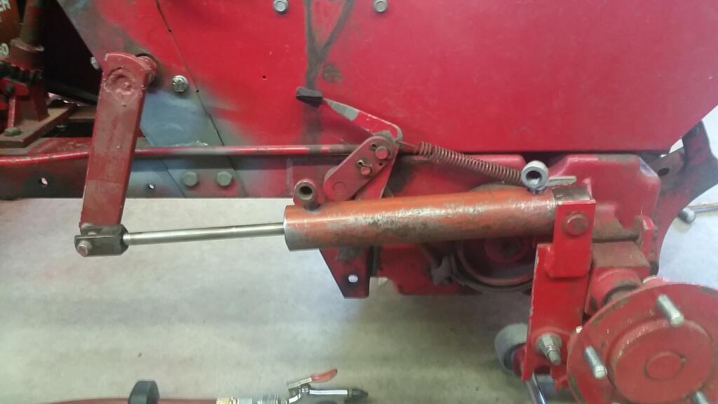

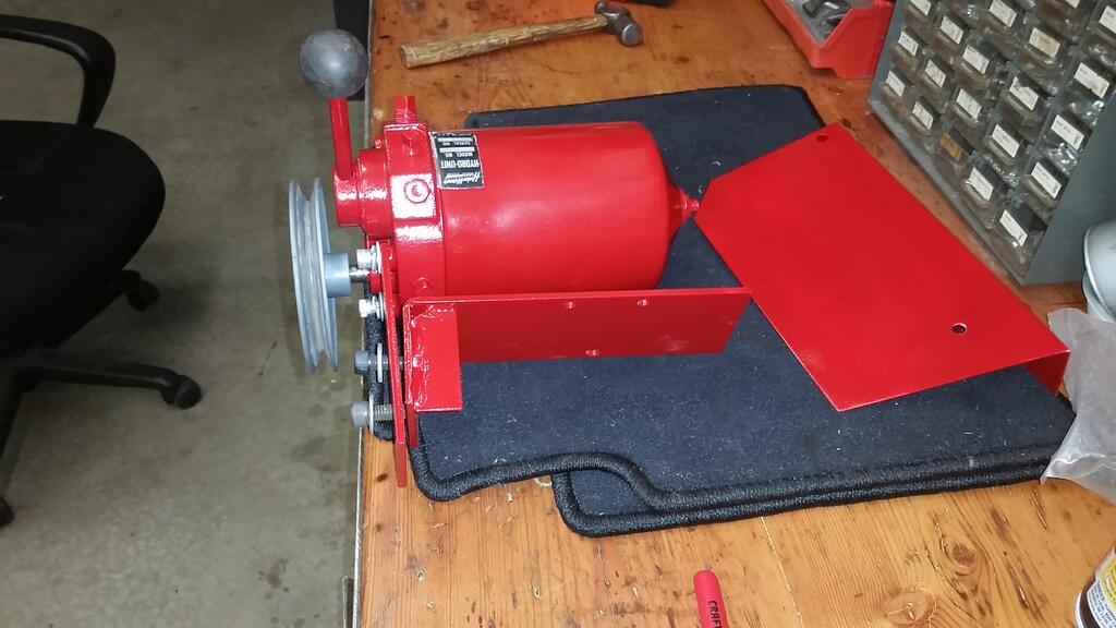

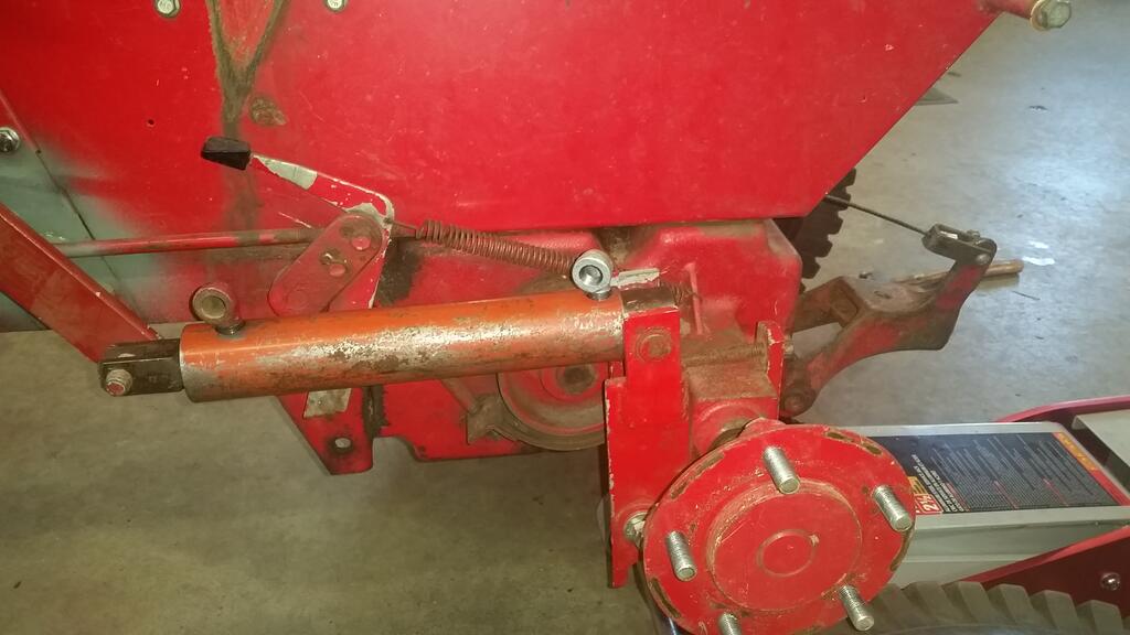

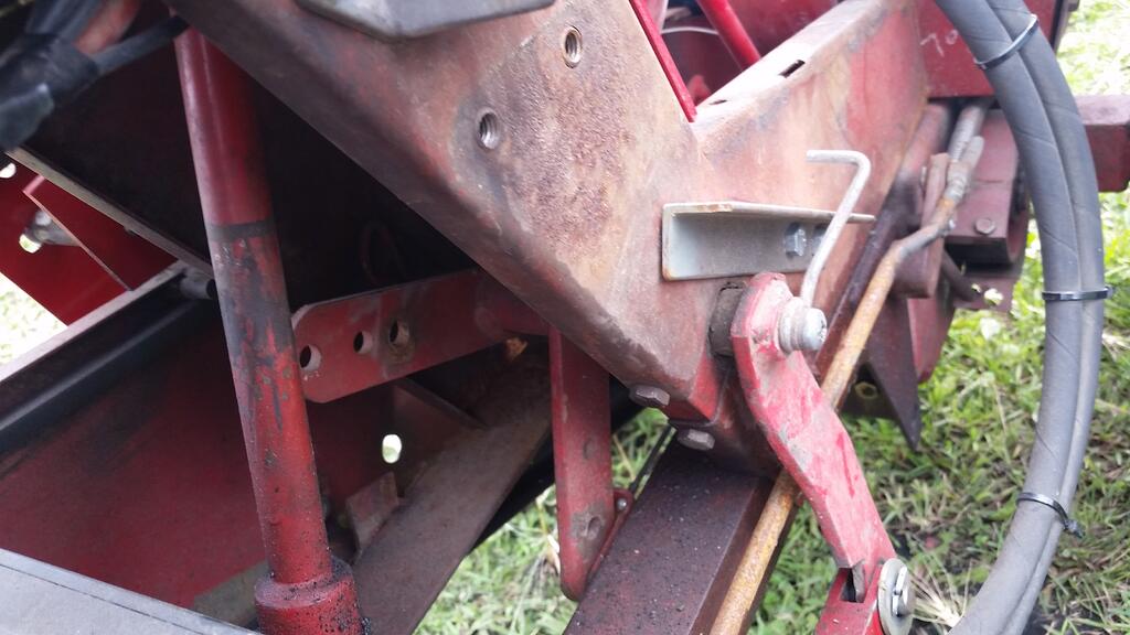

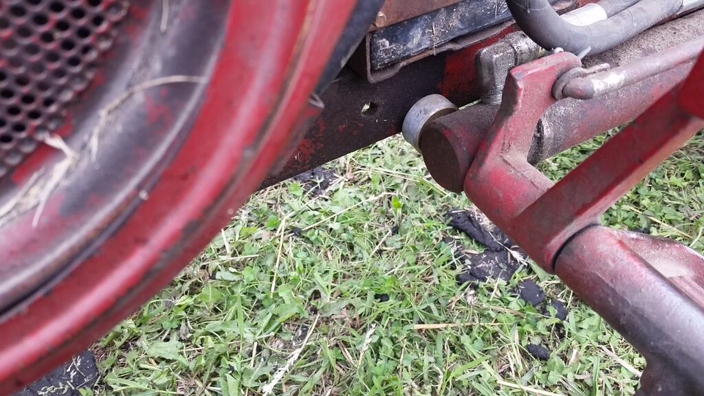

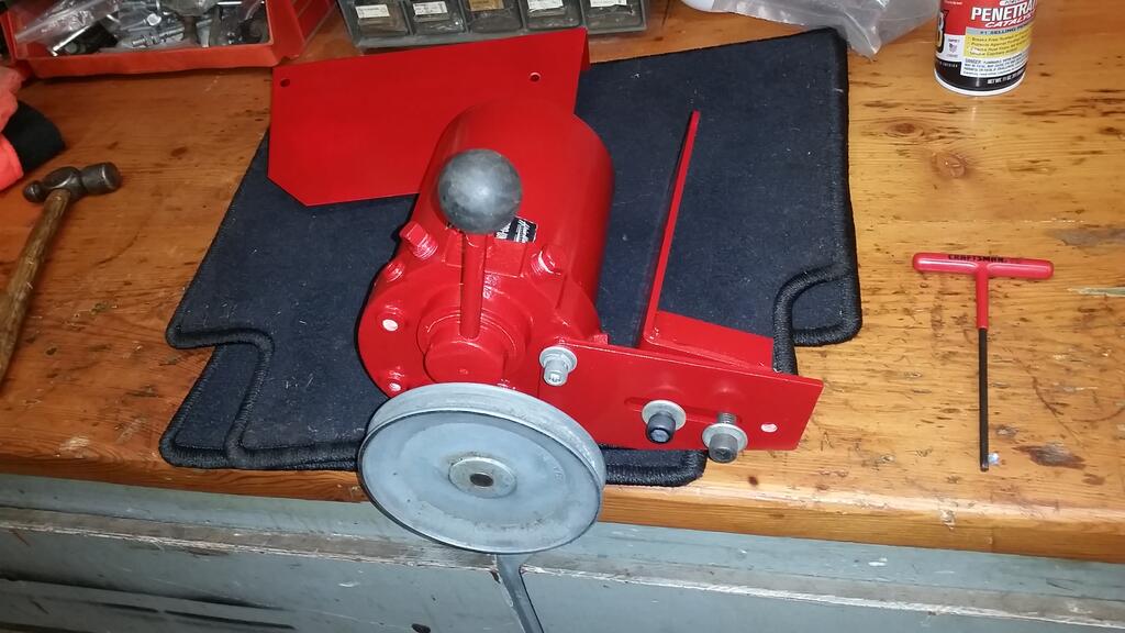

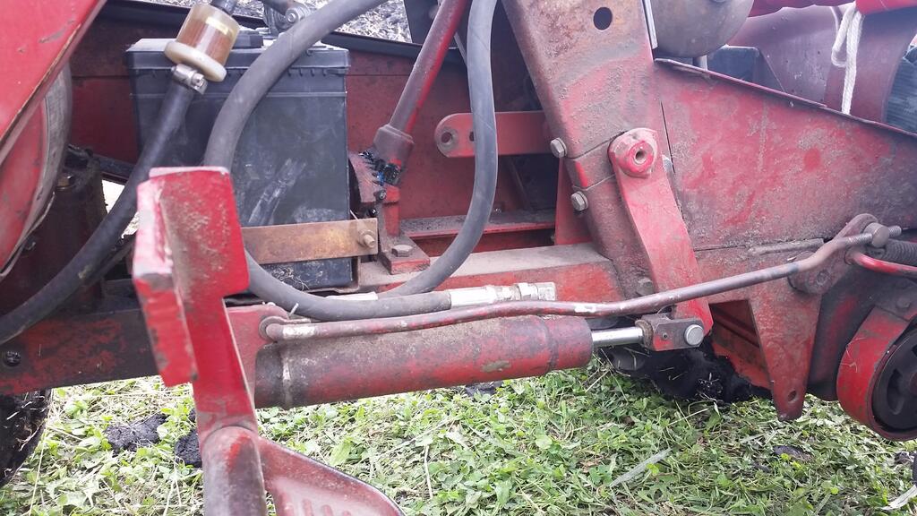

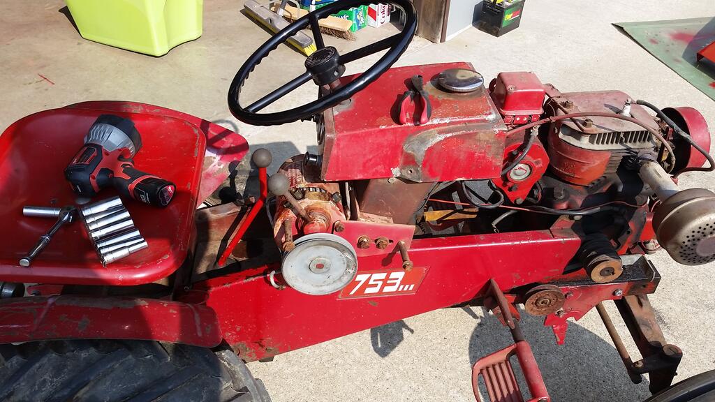

For the ram mount there are a couple of ways to go at it. An axle bracket like shown is the thread 'Nut put a link to so the ram faces forward. This might be the best way or even the only way for for a short frame. The other way is just slide the ram on the front footrest and use a modified rockshaft or one off a early C series. This might get pic heavy to show you what I mean. Some pics of the pump mount first. 3rd and 4th  5th pic of how I tried to mount it (the ram)  on a 1257 and how is was on the 753 it came off off. For some reason CRS I didn't like it.

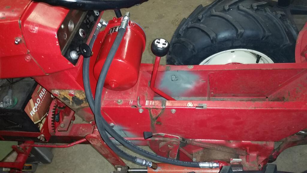

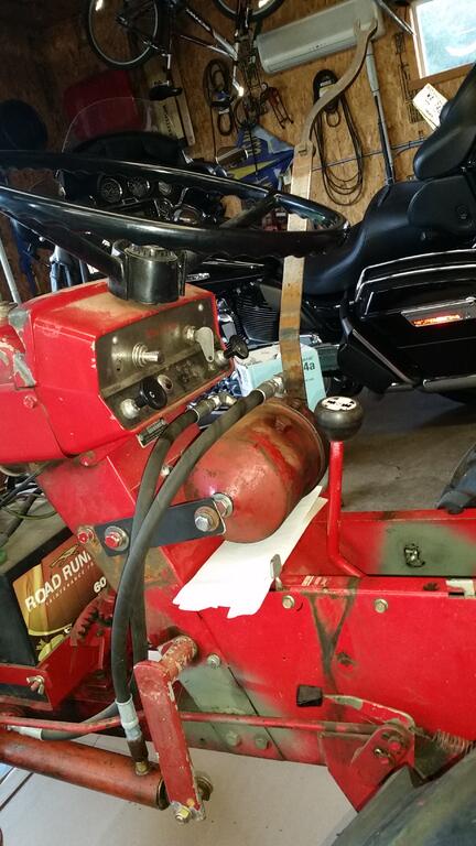

Got a look at how Mike @prondzy had his mounted.... Might run out of room on short tho???

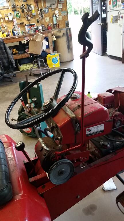

Looked good to me so just copied it for my plow mule. This pump is off a 953/1054.
Was going for the rat fink look on this lever!

All my brackets and rock shaft are a stock HY-2 off a 753  Hope this gives ya some ideas Chris....

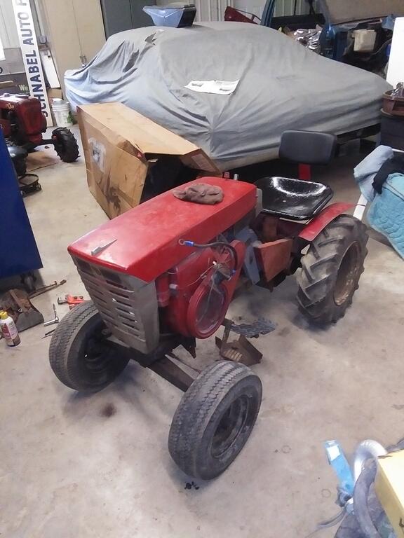

@WHX24 it will be used specifaclly for snow blade and possibly mid mount blade and a rear brinly hitch. The tractor would be a 1045 in round about sense. Its a 1055, with a 552 dash tower and brake guard, 701 fenders and tool box.
