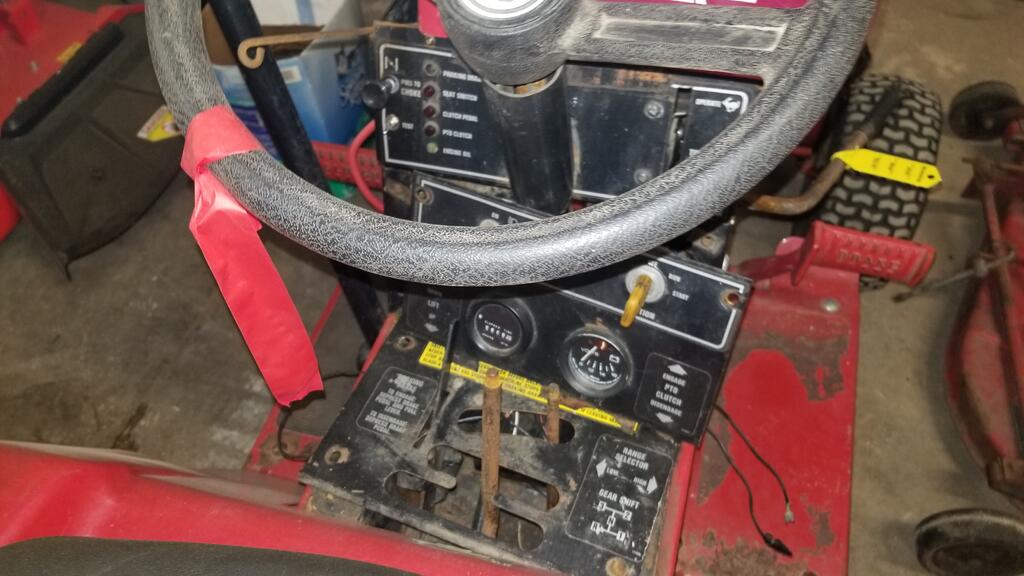

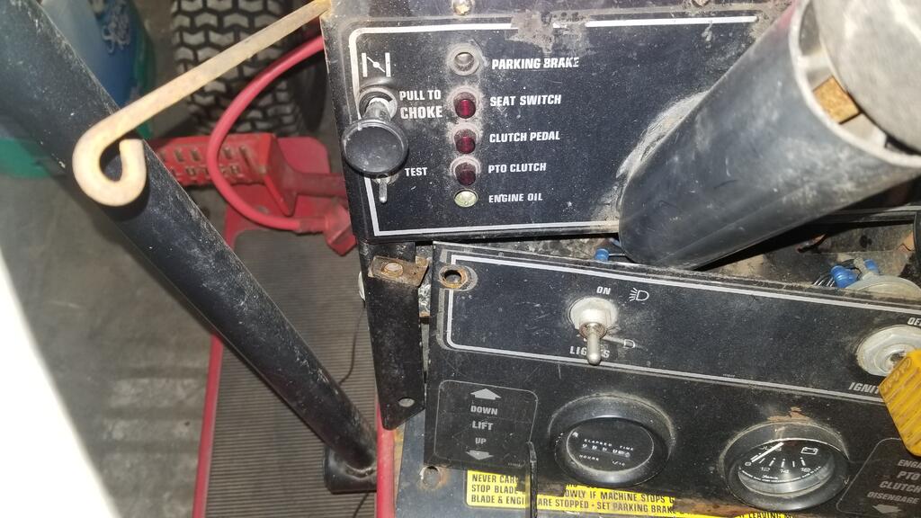

HorseFixer 2,013 #11 Posted January 6, 2021 Okay Lads The Model Of The Tractor is # R1-16O802 which makes it an 86. It does have a bunch O Idiot lights on it that makes it more complex. See the pics I took myself. Share this post Link to post Share on other sites

953 nut 63,005 #14 Posted January 7, 2021 4 hours ago, HorseFixer said: The Tractor is # R1-16O802 which makes it an 86. That would make it a 1990 model 316-8 with an Onan 16 HP engine! Or someone bolted the fender from a '90 316-8 onto a 312. If your friend can do without those idiot lights the job would be simplified. Is the ignition system battery powered or Magneto? What parts of the wiring system are missing or compromised? 1 Share this post Link to post Share on other sites
HorseFixer 2,013 #15 Posted January 7, 2021 57 minutes ago, 953 nut said: That would make it a 1990 model 316-8 with an Onan 16 HP engine! Or someone bolted the fender from a '90 316-8 onto a 312. If your friend can do without those idiot lights the job would be simplified. Is the ignition system battery powered or Magneto? What parts of the wiring system are missing or compromised? I'm Sorry My Mistake, I was dealing with a Guy telling me had a harness out of a 1990 316-8. thee Correct model # is # 2112K802 and I had a Butt hole attack! 1 1 Share this post Link to post Share on other sites

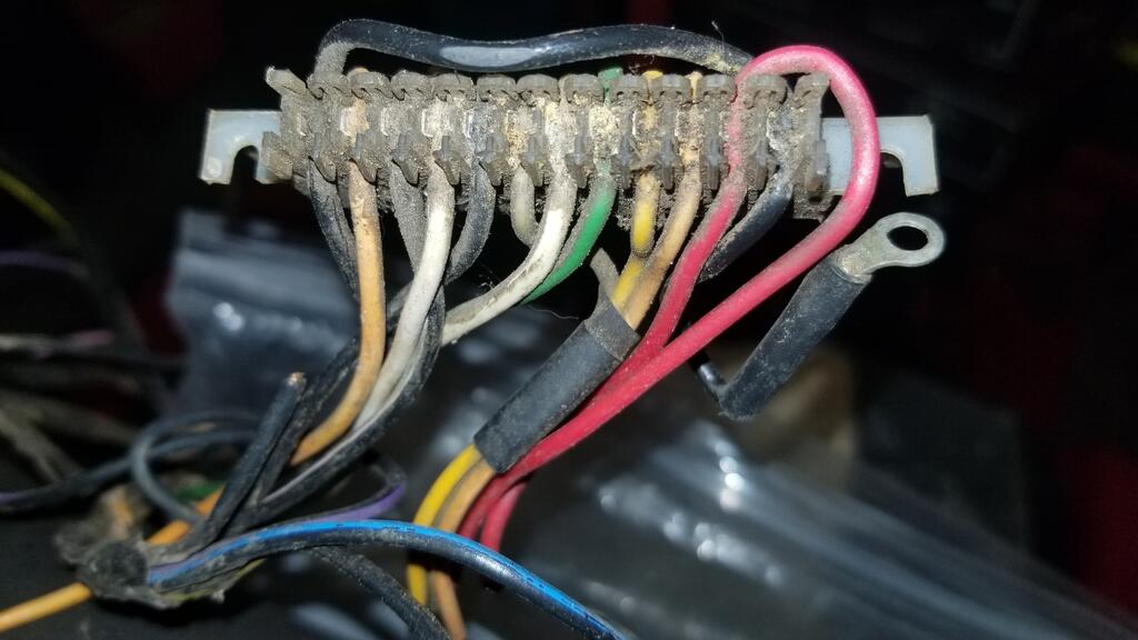

MLS 0 #21 Posted April 20, 2024 Starting to research finding a wiring harness for a 312-8 tractor ID #2112K805 Came across this old thread about this subject so I am reaching out to educate myself. I found one on ebay for a 414-8 part # 111832 . Could this work ? I purchased my wheel horse new in 1988. Keep blowing fuses and the wiring has seen better days. Please Advise. Thanks, Mike Share this post Link to post Share on other sites
953 nut 63,005 #22 Posted April 20, 2024 Your 312-8 is a 1988 model and if the wiring harness was from 1987 or 1988 416-8 it would be a direct replacement. looking at the 414-8 wiring next to the 312/416 wiring I don't notice any difference, you be the judge. Not knowing what year the 414 wiring is from leaves some doubt in my mind because changes were made to wiring in later years. 11 hours ago, MLS said: Keep blowing fuses and the wiring has seen better days I would suggest you take a look at the wiring diagram for the 312 and see what components are beyond the fuses and check the wiring for problems before considering a harness replacement. Share this post Link to post Share on other sites
