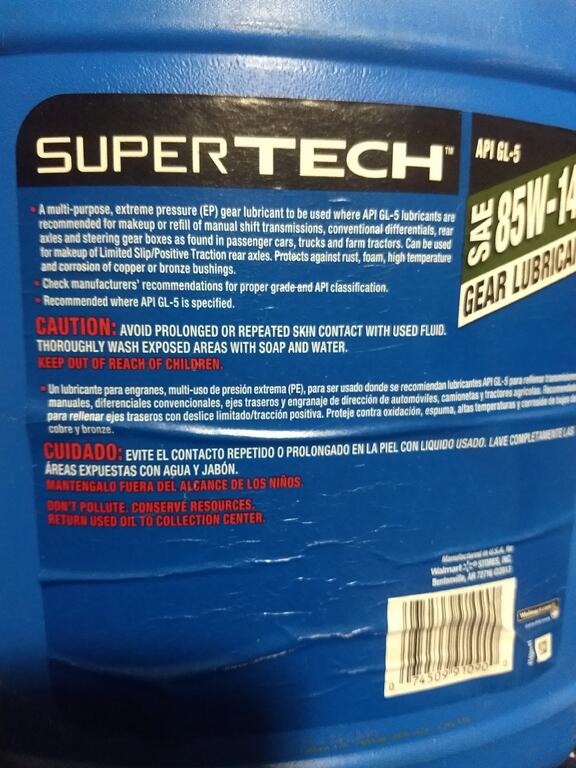

pfrederi 18,216 #7 Posted January 3, 2021 I usually use Wally World Super Tech 80-90w GL-5 Gear oil says on label protects against corrosion on copper and bronze.... 4 1 Share this post Link to post Share on other sites

peter lena 9,002 #9 Posted January 3, 2021 agree with the wally world super tech , I regularly check my lubricants and keep them fresh, now ,EBINMAINE about you sitting along side a bottle , as long as you do not start drinking the stuff , we are good , pete 1 2 Share this post Link to post Share on other sites
