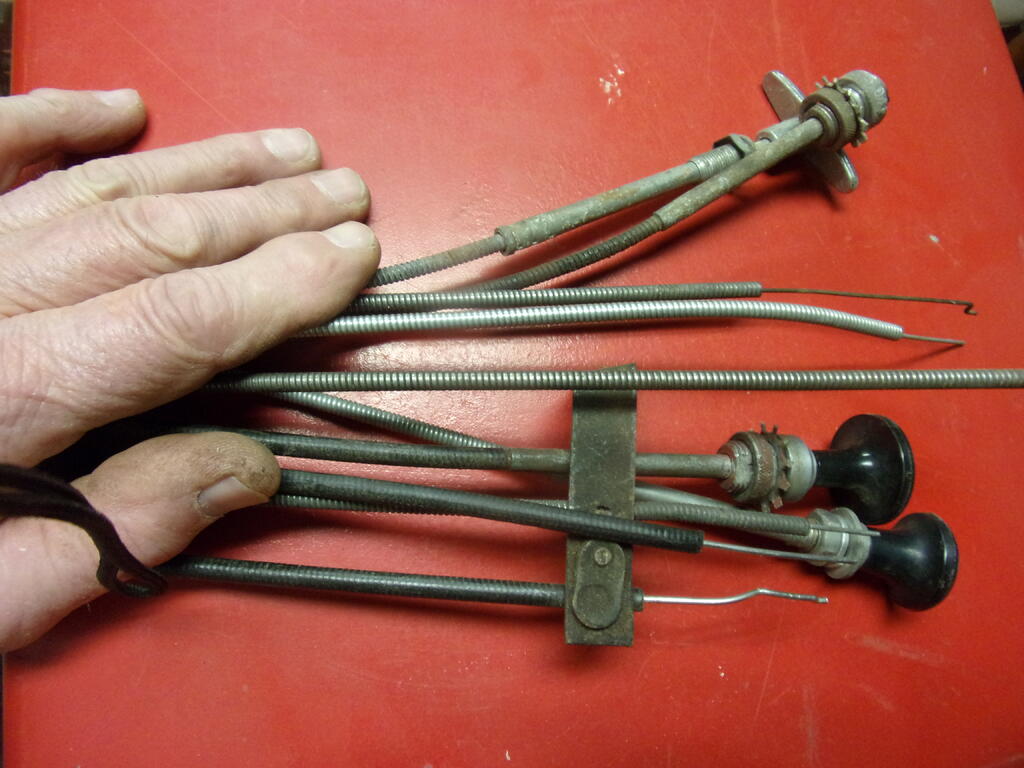

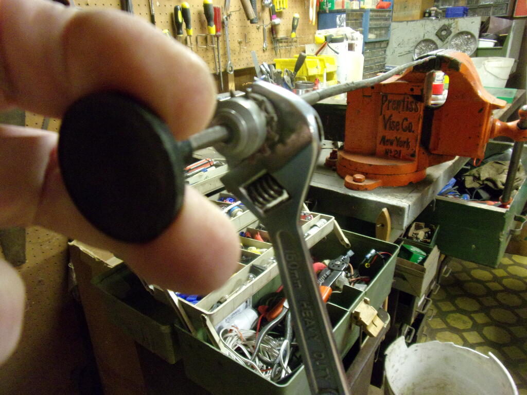

Ed Kennell 39,887 #1 Posted December 30, 2020 Thought I'd share how I free up a frozen cable. Clamp the wire end in a vice. Hold the knob end from turning. Turn the sheath with a wrench working back and forth slowly until the entire sheath turns on the wire. If there is a Z hook, cut it off. Pull the wire out and sand until it is smooth. Install the wire in the sheath and work oil in till the entire inside length is coated. Rebend the Z hook. Works better than a new one. 15 14 3 Share this post Link to post Share on other sites

formariz 11,991 #5 Posted December 30, 2020 (edited) Nice Prentiss vise. 109Lbs. Swiveling rear jaw. Looks like an early one late 1800s. Is there a patent date on the other side? Edited December 30, 2020 by formariz 4 Share this post Link to post Share on other sites

Ed Kennell 39,887 #7 Posted December 30, 2020 2 hours ago, formariz said: Nice Prentiss vise. 109Lbs. Swiveling rear jaw. Looks like an early one late 1800s. Is there a patent date on the other side? I don't see a patent date Cas. Would it be raised o indented? If indented, it may be full of paint. Share this post Link to post Share on other sites

formariz 11,991 #9 Posted December 30, 2020 2 minutes ago, Ed Kennell said: I don't see a patent date Cas. Would it be raised o indented? If indented, it may be full of paint. Usually it would be on the right side of of front jaw. If not it then is from about 1925 on . Its a great vise. Good to see one being used. 2 Share this post Link to post Share on other sites
