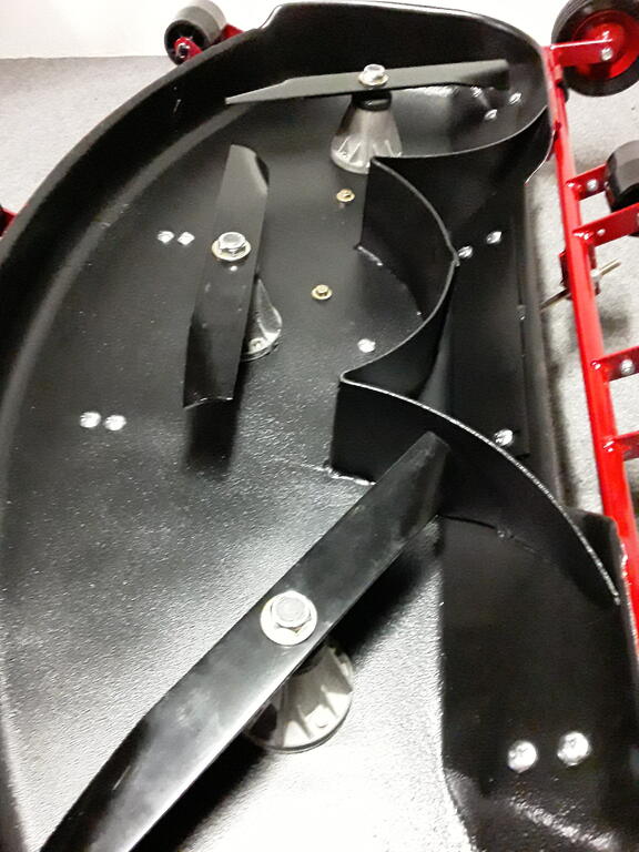

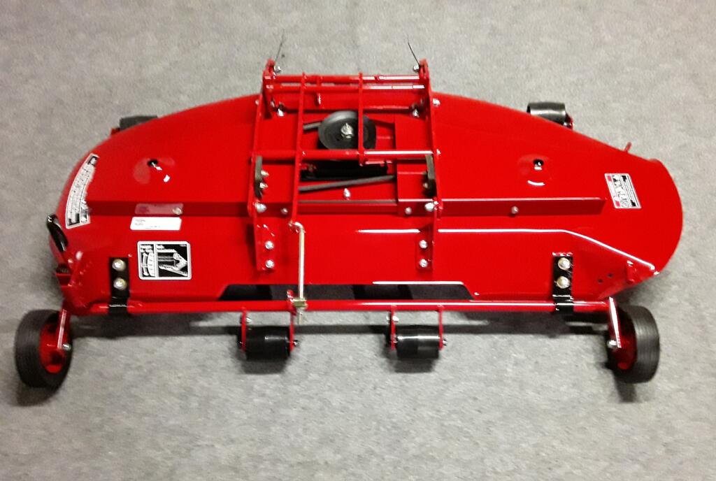

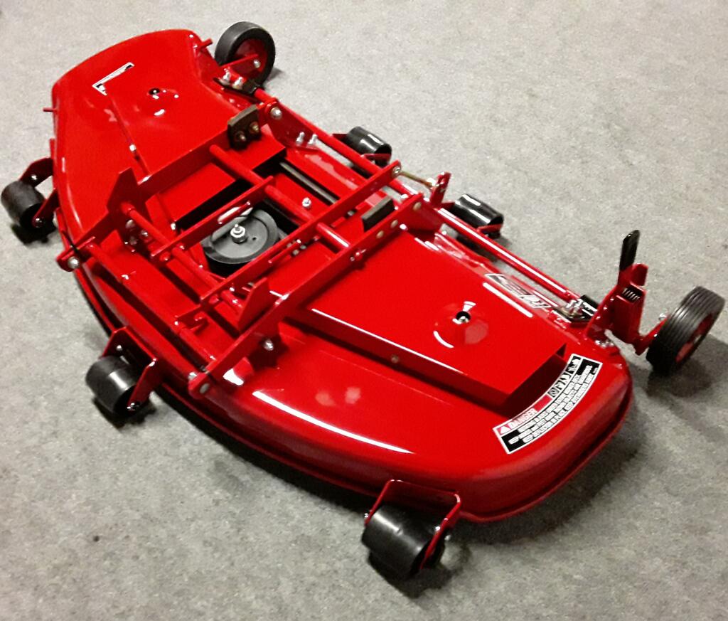

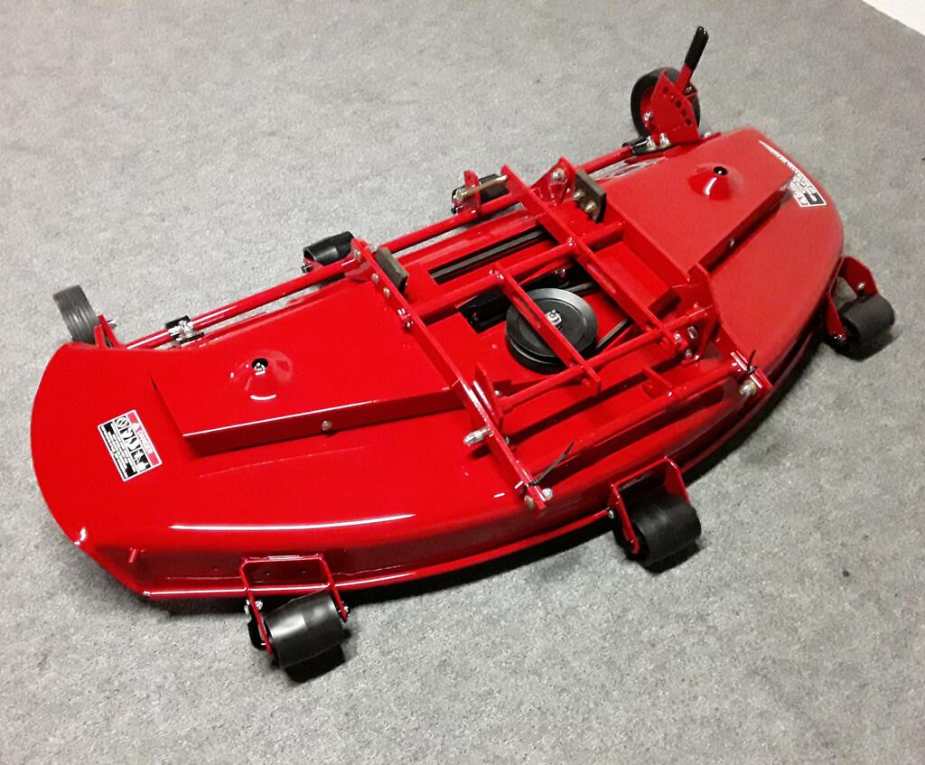

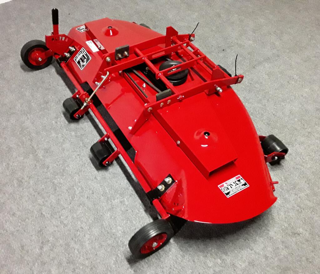

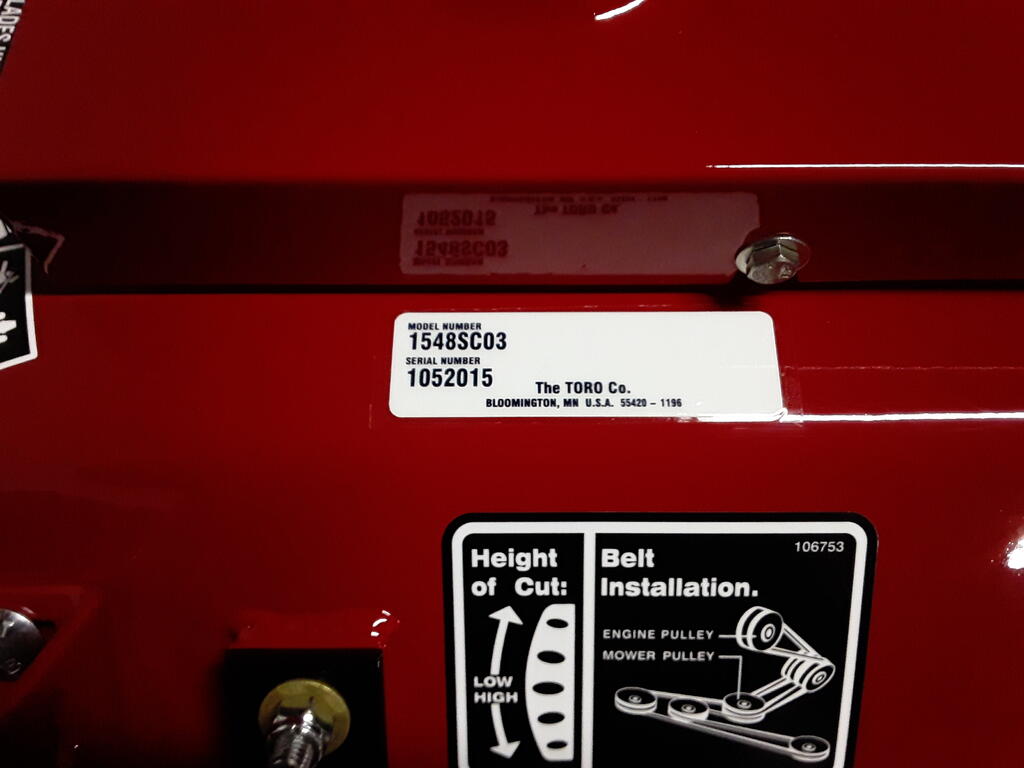

76c12091520h 3,727 #1 Posted December 29, 2020 Put a little something together today: completely blasted, epoxy primed, baked on urethane finish, spray on bedliner (like you would find on a new truck, not a thick, rubbery type), powder coated all the brackets and lift carriage pieces , rebuilt all the spindle assemblies with new bearings, new blades, wheels, rollers, oem belt, correct decals, every piece of hardware was replaced . As close to new old stock as it's gonna get. 1 10 4 Share this post Link to post Share on other sites

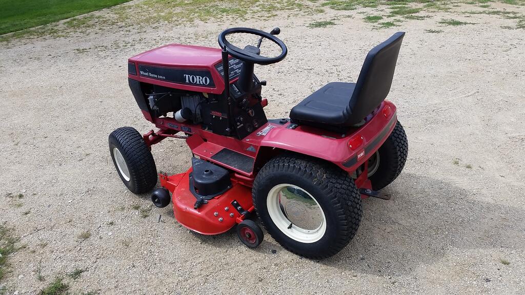

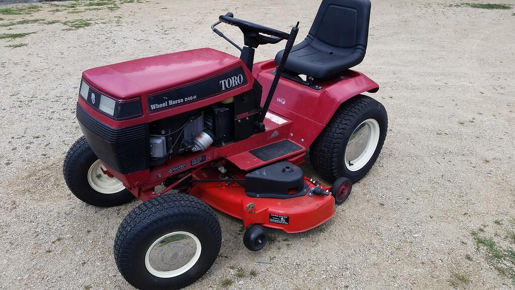

WHX?? 49,979 #8 Posted December 29, 2020 Care to share your choice of product on the under coating? Looks like it will hold up nice. I did the same thing on this 42" way before I started collecting. A daily mower. This one was standard powder coating but I did not do the under coating. It is holding up nice but the guy I had coat it used a color more orange than red. Can't complain for what it cost me. 4 Share this post Link to post Share on other sites
