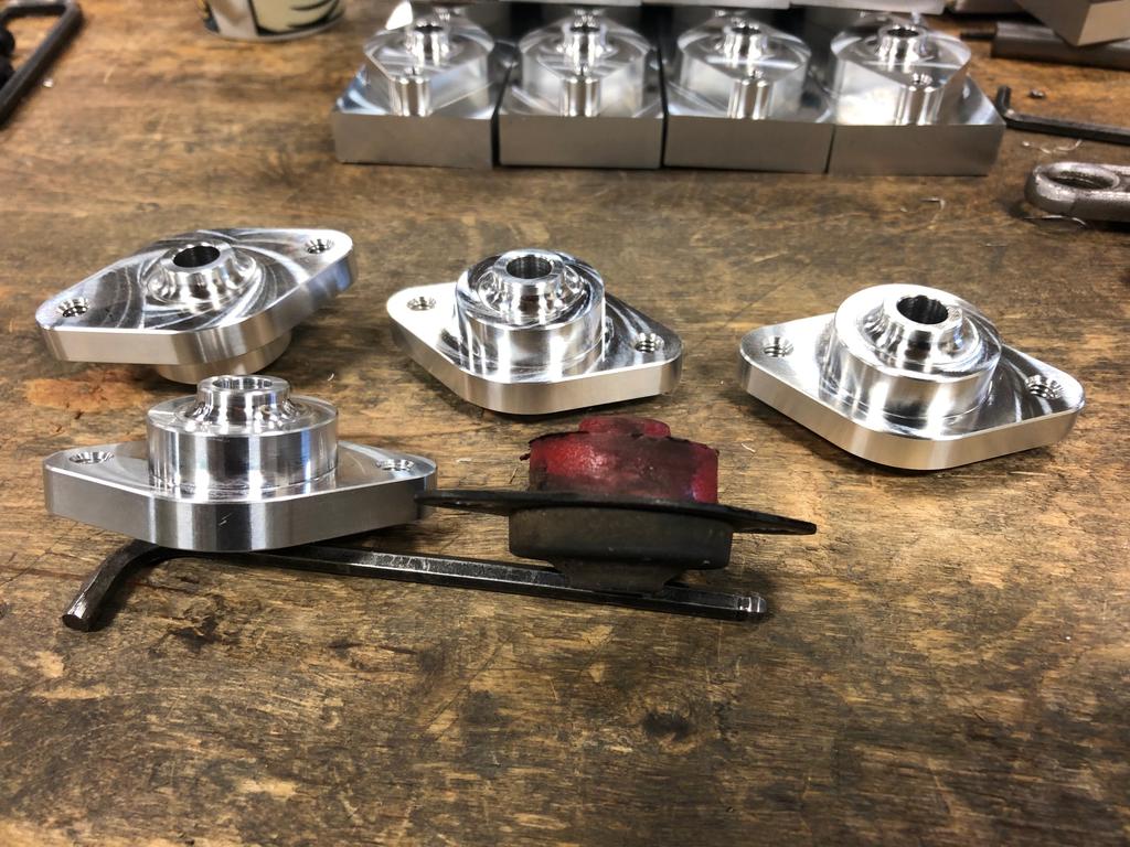

81blackhood 168 #4 Posted December 27, 2020 You can get solid replacement mounts from Zach Kerber 7 1 Share this post Link to post Share on other sites
RandyLittrell 3,862 #5 Posted December 27, 2020 Here are some solid mounts to take the place of the rubber. https://www.zkbrmachine.com/product-detail/wheel-horse-solid-engine-mounts Randy 4 1 Share this post Link to post Share on other sites

briankd 817 #8 Posted December 30, 2020 On 12/27/2020 at 5:11 PM, 81blackhood said: You can get solid replacement mounts from Zach Kerber looked at them mounts they come as a set or you have to buy individually? only says 45 bucks but don't say nothing else just a picture of them . also them there tires you have on the front of in pic you have a different pic i may put them on mine they aren't that expensive . Share this post Link to post Share on other sites
81blackhood 168 #9 Posted December 30, 2020 That price is for all 4 1 Share this post Link to post Share on other sites

Tuneup 1,433 #11 Posted December 30, 2020 Zach has wonderful customer service - stays in contact. Mounts are excellent quality. My mounts were much better in condition than yours but just above idle there was a resonant point that vibrated the engine fiercely. The solids took care of it and it didn't seem to transfer through the frame. Sweetness. You will not regret it. Share this post Link to post Share on other sites
briankd 817 #12 Posted January 1, 2021 On 12/30/2020 at 7:52 AM, 81blackhood said: The front tires are from Tractor Supply looks great was just curious on how they looked . thanks i may get me a set of them . I won't need anything real aggressive on the front anyway On 12/30/2020 at 8:27 AM, Tuneup said: Zach has wonderful customer service - stays in contact. Mounts are excellent quality. My mounts were much better in condition than yours but just above idle there was a resonant point that vibrated the engine fiercely. The solids took care of it and it didn't seem to transfer through the frame. Sweetness. You will not regret it. great mine also shakes like hell . the coil mounted on shroud shakes so bad you would think it would fly off . definitely will need to get a set of them Share this post Link to post Share on other sites

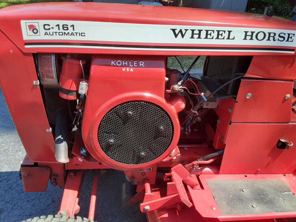

D_Mac 8,471 #13 Posted January 1, 2021 (edited) I got a set of those mounts for the C-161 I had. Took a little patience installing them but I am glad I made the change. Mine too would shake like crazy. You can see them in the photos. Edited January 1, 2021 by D_Mac 1 1 Share this post Link to post Share on other sites

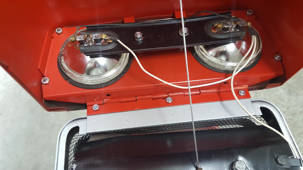

Gregor 4,843 #16 Posted January 1, 2021 I am not familiar with your model tractor, but you have that single bolt in between the headlights. This shows the headlight mount on my Massey MF14. Maybe you could fashion something similar using a split rubber fuel line for the rubber grommet.. 1 Share this post Link to post Share on other sites
