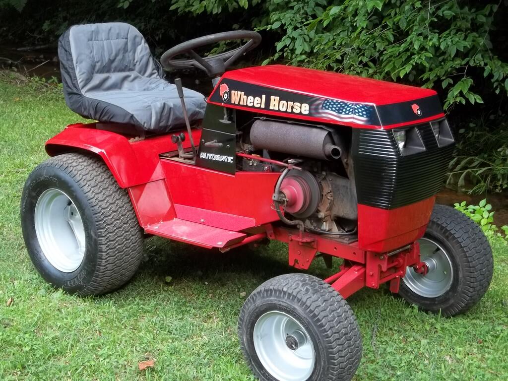

dalez 138 #17 Posted December 28, 2020 This is brush on bedliner. I taped off area and hand painted red afterwards. I have used up the can and don't remember the brand. 1 1 Share this post Link to post Share on other sites

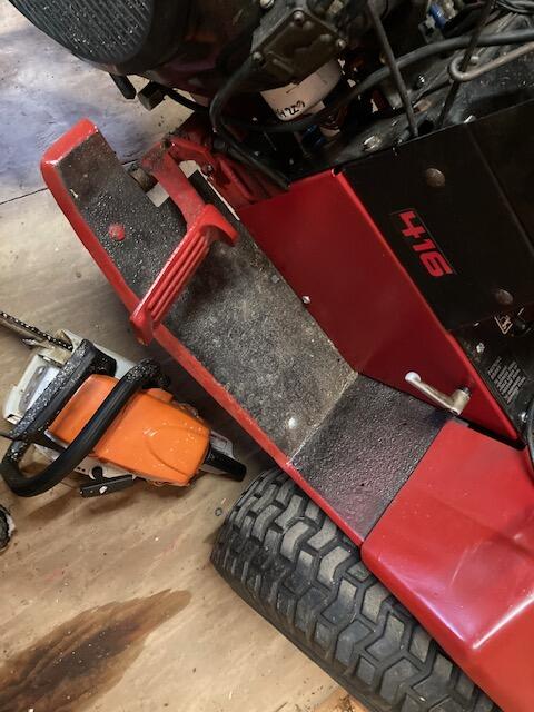

Jeff-C175 7,203 #24 Posted January 5, 2021 (edited) The parts were cured enough to lay them in place to see how they will look. Already got a foot print on it! darn! I guess I better get used to that. Grip tape should arrive Saturday. While I had them off I also painted the control panels but not with bed liner. Again, nothing is bolted back together yet. I could have spent a little more time sanding and cleaning, the flash really shows the defects but you can't really see them in 'normal' lighting. As SWMBO says; "It's only a tractor!" Edited January 5, 2021 by Jeff-C175 3 Share this post Link to post Share on other sites
