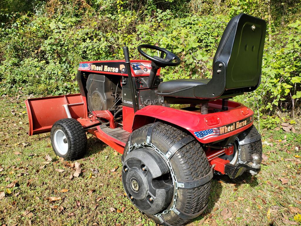

Been running them for years. They show no signs of wear and perform great. No more scratched asphalt or dug up concrete. Will never go back to steel chains.
Have them on a GT-14 with limited slip differential and LOTS of weight.

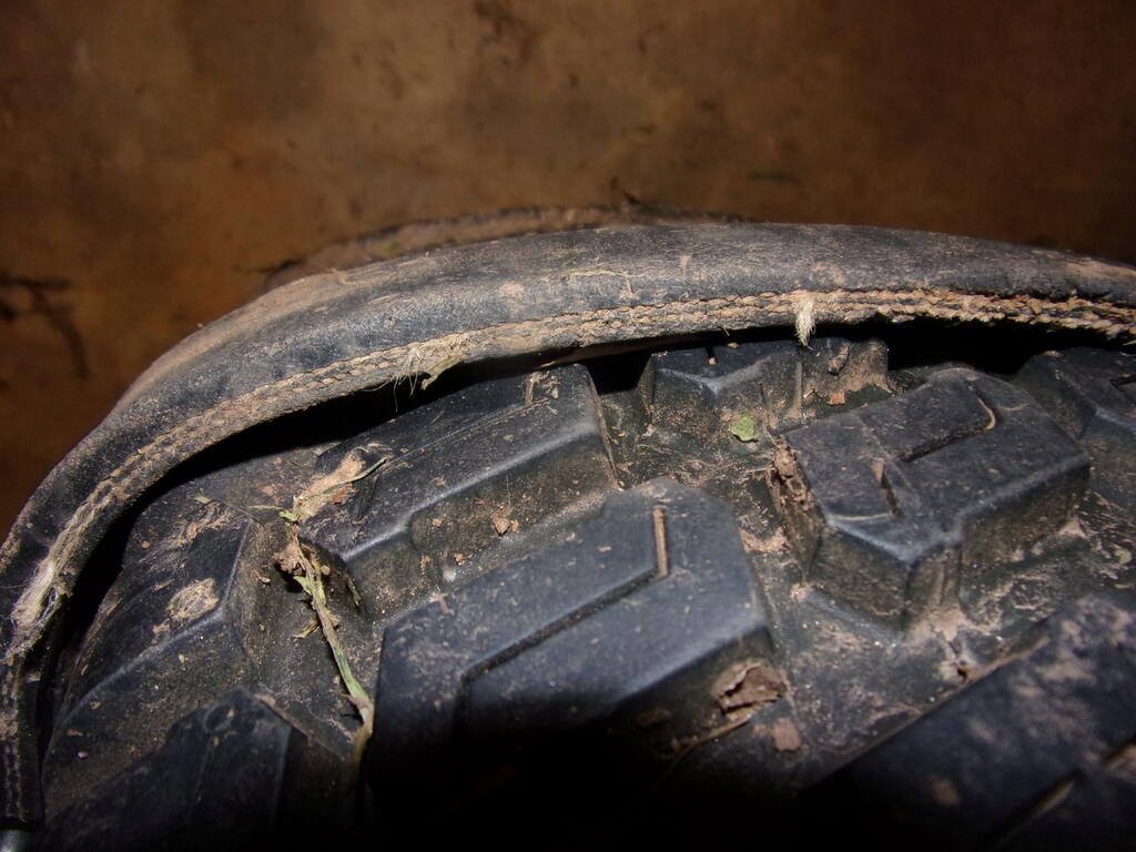

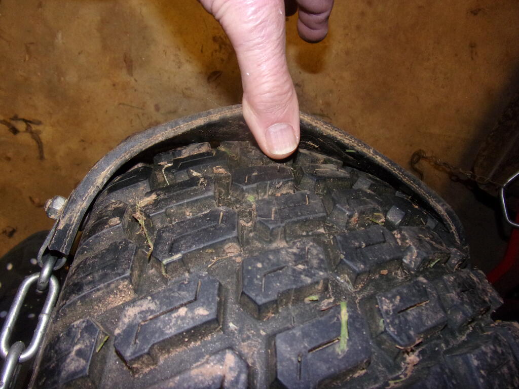

Some picts please Ed, showing how they wear. Ty.

Here ya go.
You can see the difference in the rubber thickness at the center where the wear takes place to the side where there is no wear.
One trick I learned is to reverse and flip over the rubbers to take advantage of all 4 edges of the straps to keep a sharp leading edge.
I really feel they gain a lot of their traction in loose snow by the leading egge twisting away from the tire as they contact the snow.

Ed do the wear the same front to back? Would switching the direction give longer life? Of pretty much even?

No Joe, the leading edge wears and rounds off first.   As stated in my post#16 above, I reverse mine and flip them over to take advantage of all 4 square edges of the straps.
