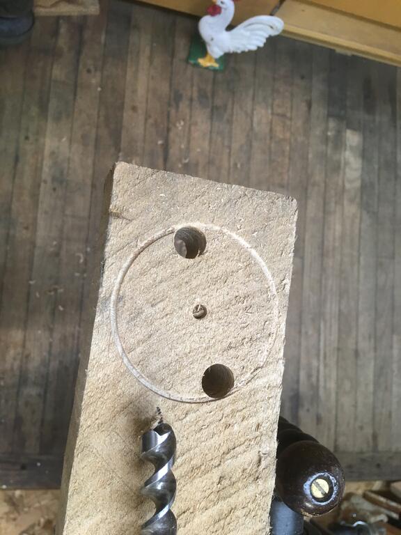

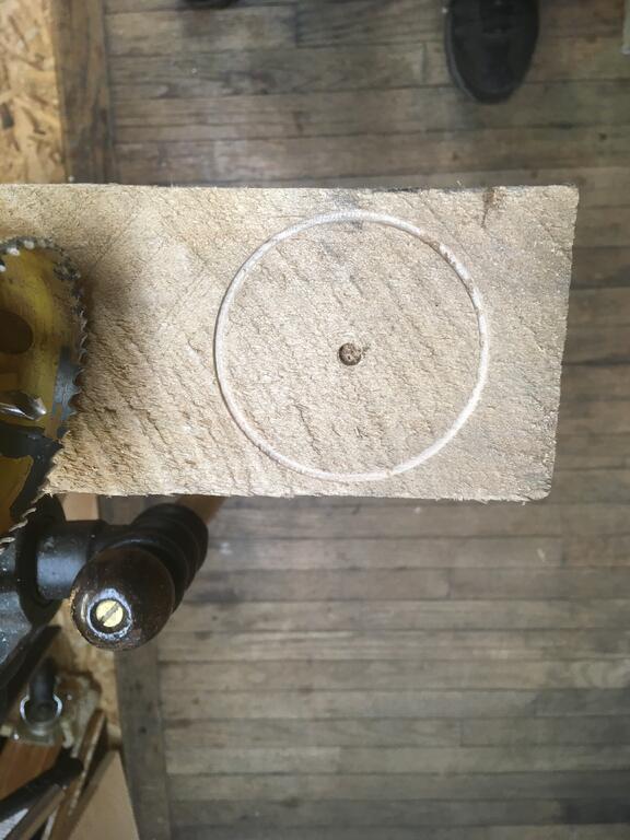

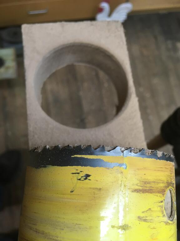

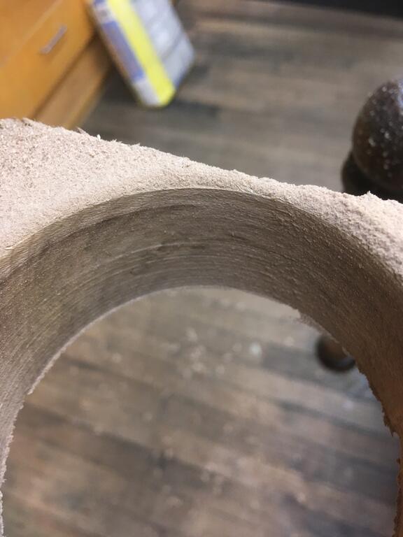

formariz 11,994 #1 Posted December 22, 2020 Many of you know how frustrating drilling large holes with a hole saw can be. The problem is that a hole saw has no provisions to eject the dust it creates. Therefore the trapped dust soon clogs and overheats cutter eventually leading to its early death by ruining its temper. I have drilled thousands of large holes with them many times through up to 5” thick MDF laminated together. The worst material ever to run any cutting edge through . The idea is to create an outlet for the dust by drilling two holes opposite each other allowing an area for dust to escape to and eventually drop through the bottom. In the example below it’s a 3” hole through 1-1/2” hard maple with no burning or caking up of teeth. I also sharpen them on a regular basis by using a diamond burr or a file. 6 3 4 2 Share this post Link to post Share on other sites
Handy Don 13,340 #2 Posted December 22, 2020 8 minutes ago, formariz said: Many of you know how frustrating drilling large holes with a hole saw can be. The problem is that a hole saw has no provisions to eject the dust it creates. Therefore the trapped dust soon clogs and overheats cutter eventually leading to its early death by ruining its temper. I have drilled thousands of large holes with them many times through up to 5” thick MDF laminated together. The worst material ever to run any cutting edge through . The idea is to create an outlet for the dust by drilling two holes opposite each other allowing an area for dust to escape to and eventually drop through the bottom. In the example below it’s a 3” hole through 1-1/2” hard maple with no burning or caking up of teeth. I also sharpen them on a regular basis by using a diamond burr or a file. THAT is a trick I'm gonna remember! 5 Share this post Link to post Share on other sites

formariz 11,994 #9 Posted December 22, 2020 35 minutes ago, wallfish said: I'll try the relief hole thing where we can too. There's always room for improvement I assure you that you will not be disappointed. I have never ran into any difficulties doing this. 1 Share this post Link to post Share on other sites
