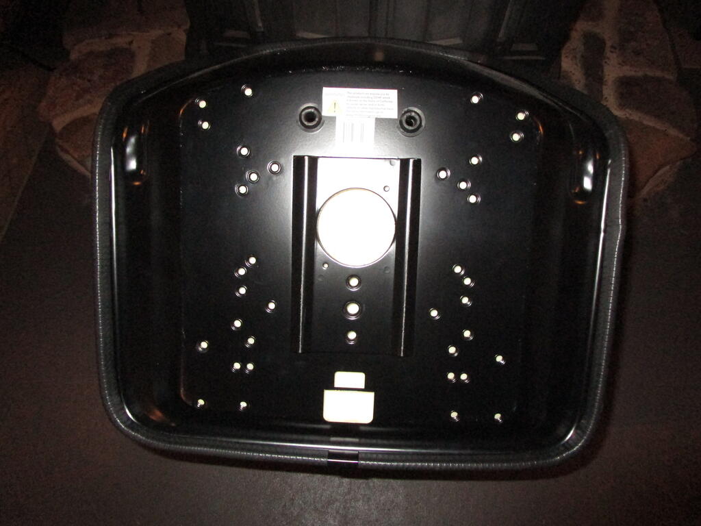

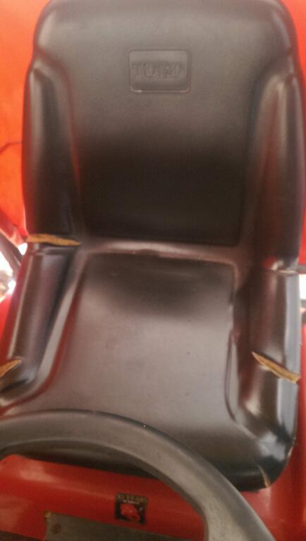

AHS 1,480 #1 Posted December 20, 2020 Ok.. I got this seat off here before.. someone gave me a web site, and I lost it! The seat has one piece to it, no metal back! Here are a few pictures 2 Share this post Link to post Share on other sites

AHS 1,480 #4 Posted December 20, 2020 10 hours ago, ebinmaine said: Agri supply? Bingo!! I checked, and there it is! I recommend those seats 100%! I’ve sat on those seats in 90 degrees and also 0 degrees, and it doesn’t tear. I mean there would be nothing to tear... they’re like a seat mold! 2 Share this post Link to post Share on other sites
peter lena 8,957 #5 Posted December 20, 2020 that's the agri supply seat , it has the exact w/h bolt pattern on it , if you look at the agri seat page , and scroll down on seat info , it shows' the exact 7-1/2 " w/h bolt on base. use fresh 5/15 bolts and washers , and lubricate them , for a smooth and easy installation , I have 3 of them , on my horses, pete 1 Share this post Link to post Share on other sites
JCM 9,863 #6 Posted December 20, 2020 Glad someone brought up the WH seat replacement topic. Am I missing something or is it me. On the 312-8 and the C-120 the bolt pattern appears to be the same 7 1/2'' left to right and 7'' front to back on the original WH seats. On the 417-8 and 418-A the pattern is the same left and right but changes to 8'' front to back. I have 2 new seats that will only work on the 312 & 120 and don't need to change them only the 418. These replacement seats I have are close to the originals looks wise. Do the agri- supply seats work on 400 and 500 series tractors or any other brand that resembles the factory type seat. @peter lena Thanks 1 Share this post Link to post Share on other sites
peter lena 8,957 #7 Posted December 20, 2020 jcm I can't say anything about the 400-500 series , but only refer to the seat diagram measurements on the agri seat info site. if the holes are close , you could always bolt on a metal flat strip to pick up the other hole area, pete 2 1 Share this post Link to post Share on other sites
WVHillbilly520H 10,376 #8 Posted December 20, 2020 3 hours ago, JCM said: Glad someone brought up the WH seat replacement topic. Am I missing something or is it me. On the 312-8 and the C-120 the bolt pattern appears to be the same 7 1/2'' left to right and 7'' front to back on the original WH seats. On the 417-8 and 418-A the pattern is the same left and right but changes to 8'' front to back. I have 2 new seats that will only work on the 312 & 120 and don't need to change them only the 418. These replacement seats I have are close to the originals looks wise. Do the agri- supply seats work on 400 and 500 series tractors or any other brand that resembles the factory type seat. @peter lena Thanks Jim is know this is 1 "expensive" https://www.tractorsupply.com/tsc/product/countyline-kubota-seat-530000bk-cnl but it has several mounting hole options and the factory Kubota seat that was on the 315-8 was super comfy and when I finally replace the one on the Anniversary 520 I think this will be the one as the Michigan unit in bought for the 95 seems to be discontinued. 2 1 Share this post Link to post Share on other sites

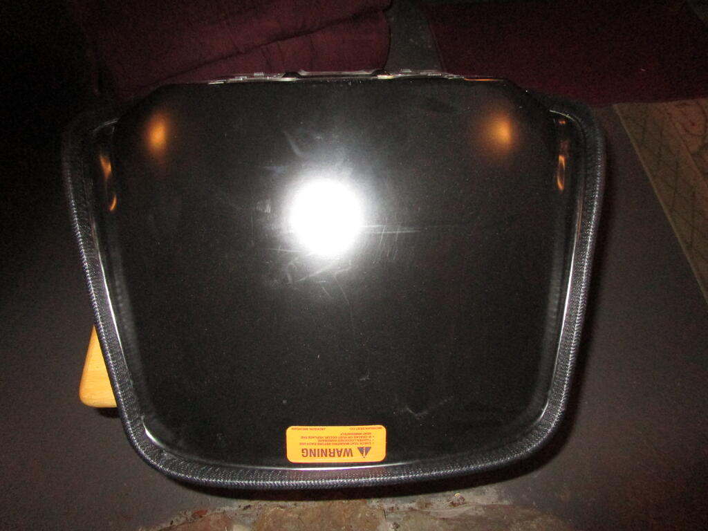

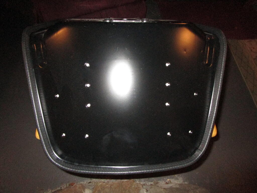

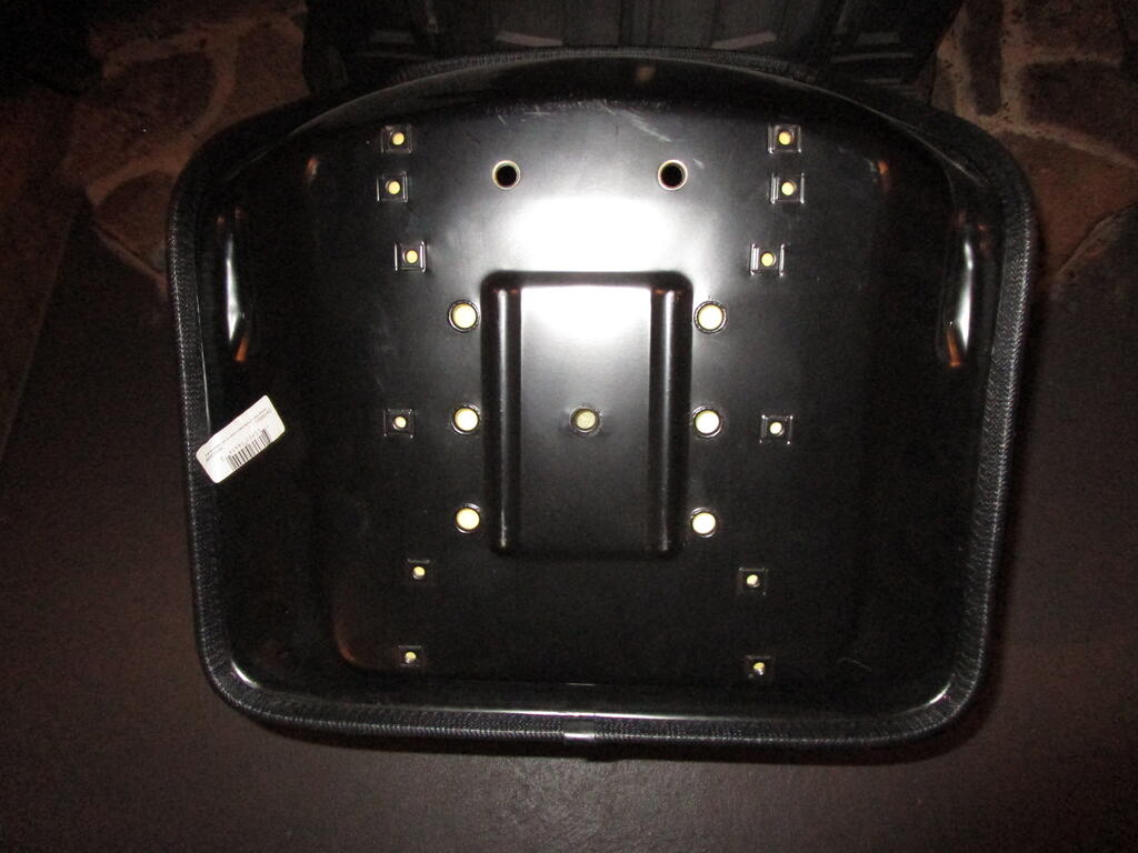

JCM 9,863 #9 Posted December 20, 2020 Here are some pics of the 2 new seats I have but as they sit may need to figure a way to make them work for the 400&500 series. The second pic has so many holes you would think we used that as a backstop for target practice yet none of the holes will work on the 400 or 500 as they sit. 2 Share this post Link to post Share on other sites
WVHillbilly520H 10,376 #10 Posted December 20, 2020 @JCM this might be the ticket https://www.surpluscenter.com/Truck-Trailer/Seats/Seat-Belts-Hardware/945-Universal-Adapter-Slot-Bar-Pair-Black-Talon-945001BK-1-3553.axd instead of spending more for a seat that doesn't fit. 2 Share this post Link to post Share on other sites
JCM 9,863 #11 Posted December 20, 2020 I wonder if the slide tracks on the 400 & 500 would allow this to work or wouldn't matter ? If it doesn't then this may be a solution. Thank you @WVHillbilly520H 2 Share this post Link to post Share on other sites
