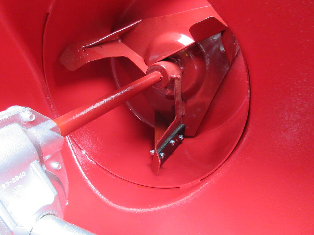

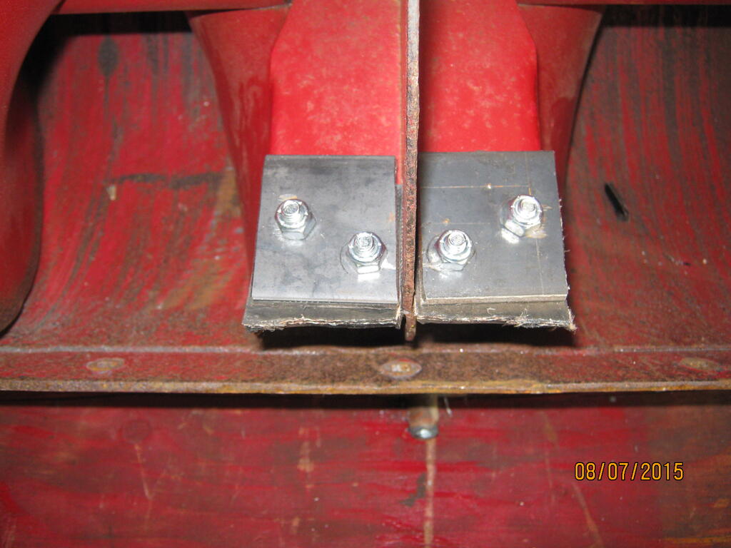

Turftech
Best paddle material is available at your local small engine repair shop. Just ask them to save you a worn set of paddles from a single stage Toro walk behind sno-thro. They need to be changed out every few years as they provide for the forward motion and wear out on pavement/frozen ground, they lose half there throwing distance.
You can cut several sets for a single stage and one set for a two stage impeller from a pair. I set them up with max 1/8" contact at the closest point to wear in. Still have the extra throwing distance after four years use on a single. The two stage I overhauled this past summer also has used paddle fabric added to the second stage.
