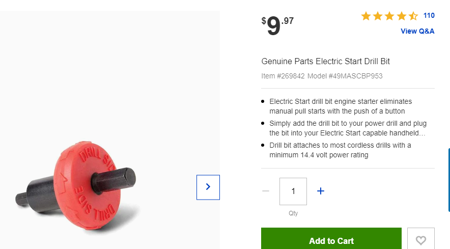

Zeek 2,286 #3 Posted December 19, 2020 This too for $10. 2 2 Share this post Link to post Share on other sites
DennisThornton 4,771 #4 Posted December 19, 2020 34 minutes ago, Zeek said: This too for $10. Hard to beat that! I'm guessing it would need a strong drill and grip. 1 Share this post Link to post Share on other sites
Gregor 4,847 #5 Posted December 19, 2020 I have my doubts if that would hold up with 1/2 drill, and a Kohler engine. I can't tell....Is there a 3/8 drive on the other end? Share this post Link to post Share on other sites

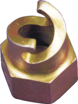

bc.gold 3,403 #13 Posted December 20, 2020 Many sizes and thread variations. 1 Share this post Link to post Share on other sites
Handy Don 13,260 #14 Posted December 20, 2020 9 hours ago, bcgold said: Many sizes and thread variations. Crank for starting my grandfather's Model-T had a fitting like this on the end. I got to see the crank, but the car was long gone! Share this post Link to post Share on other sites
Jeff-C175 7,203 #15 Posted December 20, 2020 5 hours ago, Handy Don said: my grandfather's Model-T had a fitting like this on the end My 58 MGA had one. I never did have a good battery or starter in that car. Always used the crank handle. Got lot's of looks! Share this post Link to post Share on other sites

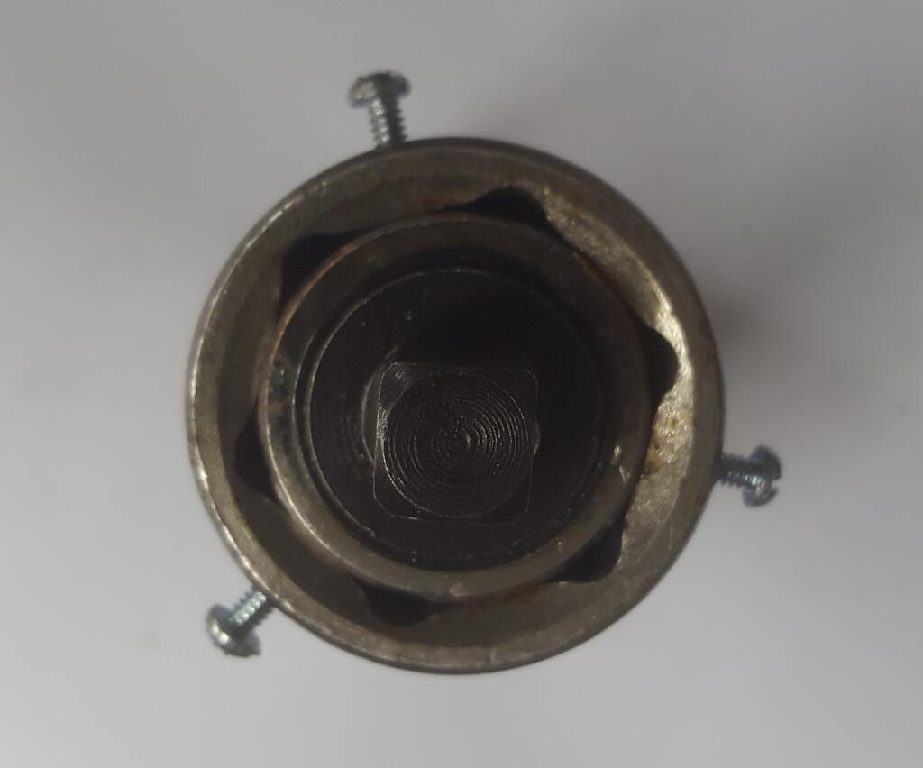

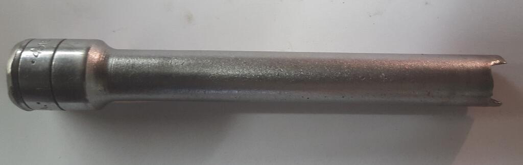

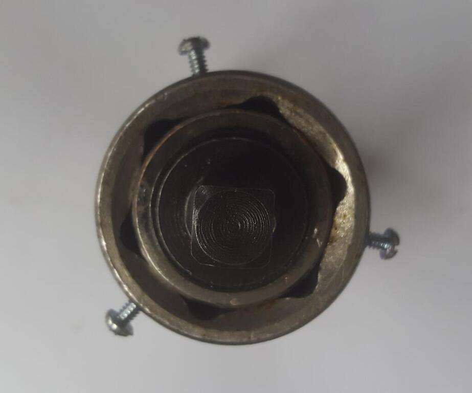

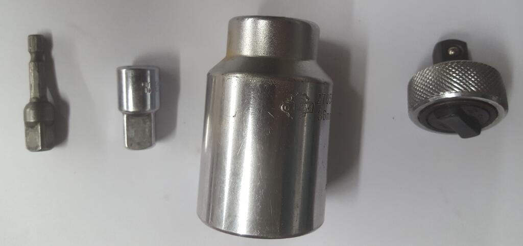

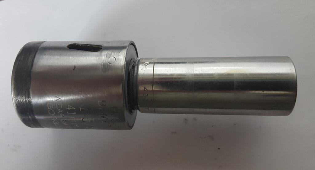

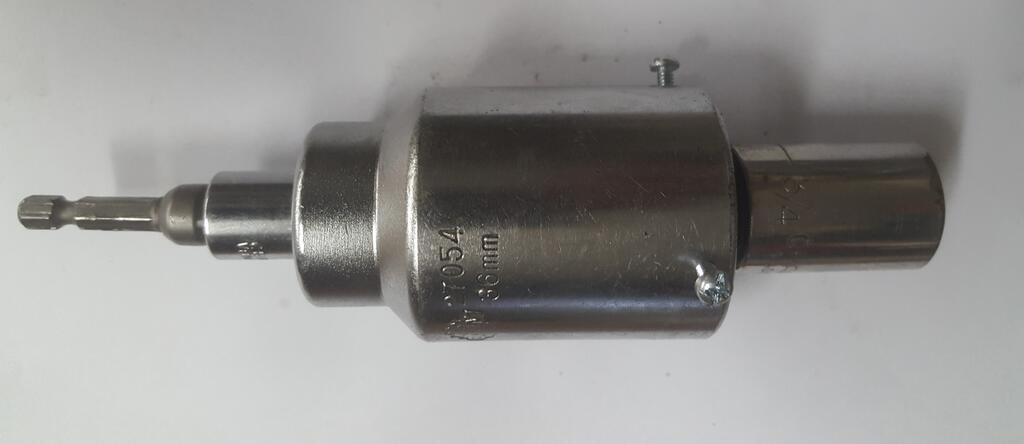

Gregor 4,847 #22 Posted January 7, 2021 (edited) As some of you know I have been looking for some sort of ratcheting attachment for my drill, to spin motors over. I did order a couple of them. Then I discovered I already had one, I simply didn't have it assembled yet. I had a 1/2" dive thumb ratchet, 3/8" to 1/2" adapter. 1/4" X 3/8" driver bit, and a 36 mm 1/2" drive socket. I bought this socket to work on a truck, I no longer have. I haven't used it since selling the truck. The thumb drive has a slightly smaller diameter than it use to, it had to fit in the socket. I guess I could have bought a bigger socket, but there just aren't many places open a 5 AM. I drilled and tapped 3, 6-32 screws, drilling slightly into the thumb ratchet, to hold it in place, although it was a press fit into the socket. Put it all together, and it works pretty good. If your ratchets are like mine, they seem to inexplicably change direction, when your not looking. It's as thought there is a ratchet gremlin, hiding somewhere, ready to change it when you lay it down. I made this from and old 3/8" drive extension that I have been using as a punch for years. I can poke it through the 1/2" drive hole in the socket, to switch the direction on the thumb ratchet. It's crude but effective. By the way, the motor started right up! Edited January 7, 2021 by Gregor 1 2 Share this post Link to post Share on other sites
Jeff-C175 7,203 #23 Posted January 7, 2021 (edited) You better hope that the ratchet drive doesn't decide to change direction at the moment the engine starts! How about packing something into the socket... like some sort of putty or something, to hold the ratchet direction knob? Modeling clay? Or that the socket decides to come off the ratchet after the engine starts and you go to pull the device away, and the socket goes flying at high speed, dangerously! Edited January 7, 2021 by Jeff-C175 1 Share this post Link to post Share on other sites
Gregor 4,847 #24 Posted January 8, 2021 Ratchet adapter Generation II. New and Improved! When I got home from my errands yesterday, I was bored, so I did some more tinkering. I made another ratcheting adapter. I won't go into detail, other than to say, it required a 1 5/8 hole saw, 3/8" thumb drive,(4) 6-32 screws, a deep 3/4" socket, and an old screwdriver to modify as a reversing tool. This one is all one piece. It won't pull apart. When you pull it away from the motor, everything comes with it. No socket or other bits left dangling on the flywheel nut spinning at 1000 RPM. 2 Share this post Link to post Share on other sites
ebinmaine 70,340 #25 Posted January 8, 2021 Excellent improvement. I could use one of these for an engine we have that is a pull start with a rope, no recoil. Share this post Link to post Share on other sites
